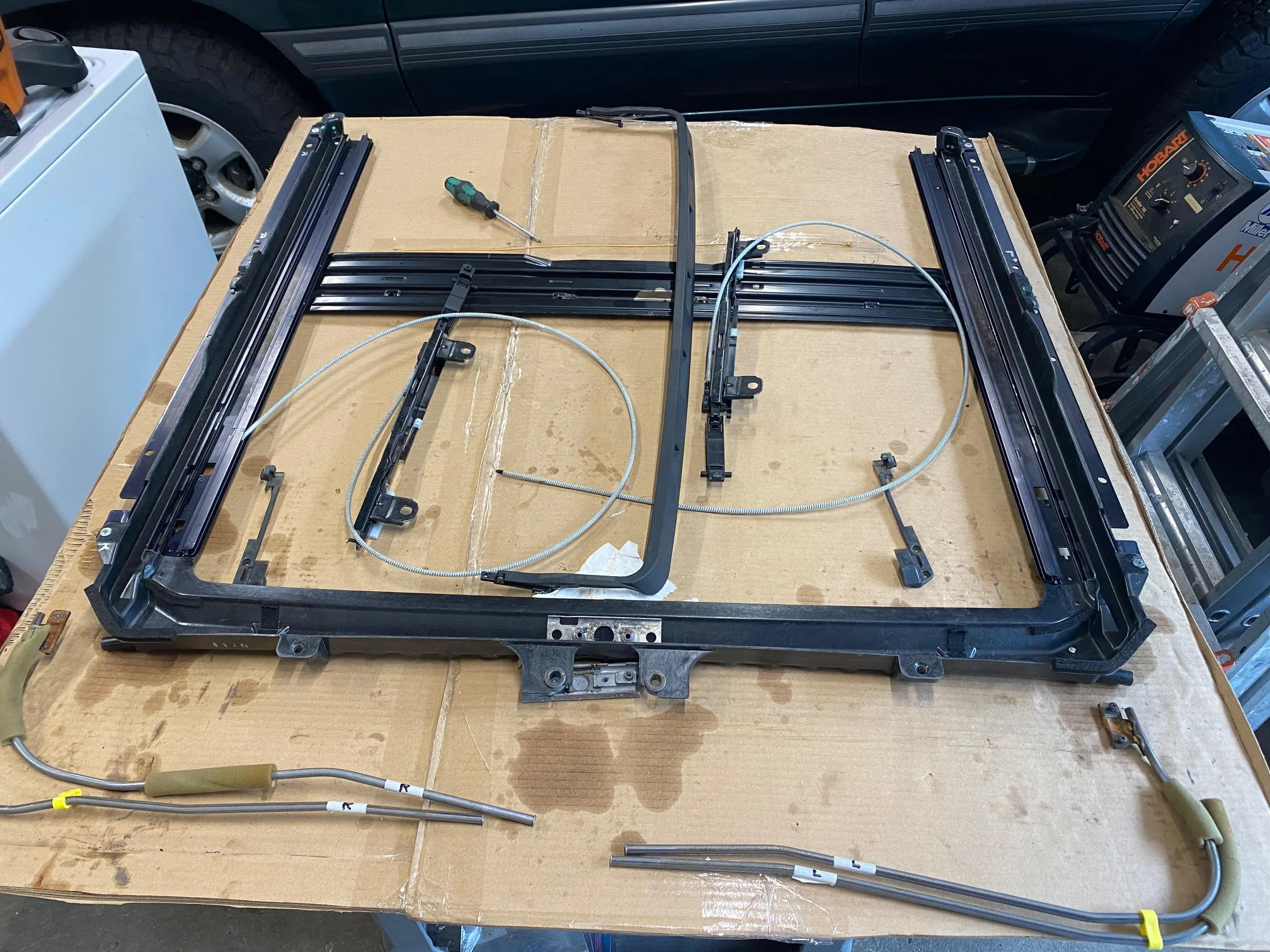

Unfortunately, this is the only solution. It takes more than 2 hours, but the sunroof mechanism isn't too complicated once you get it out. you have to work carefully and methodically , but i can be done. here is my sunroof mechanism during the rebuild. It took me probably 8 total hours to drop the headliner, pull apart and fully clean and get the sunroof working again, and re-install.
