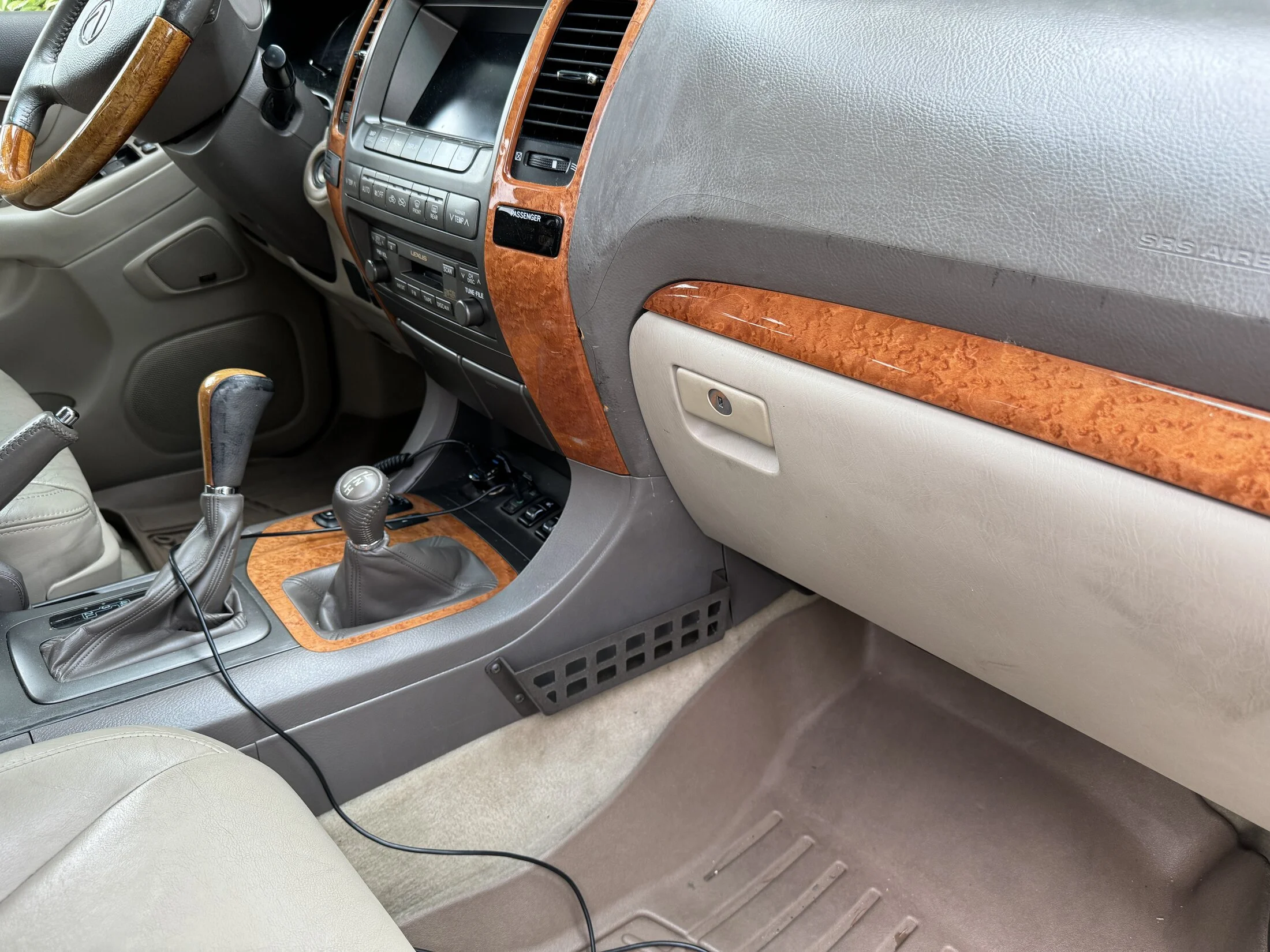

I wanted to share a quick mod I made for a place to put my cellphone in my 470.
I bought these cheap molle pockets off aliexpress meant for rear doors of a 3rd gen taco, and painted them to match the tan interior (thanks to this thread) I skipped the nickel so the color match is not perfect but it is close enough.

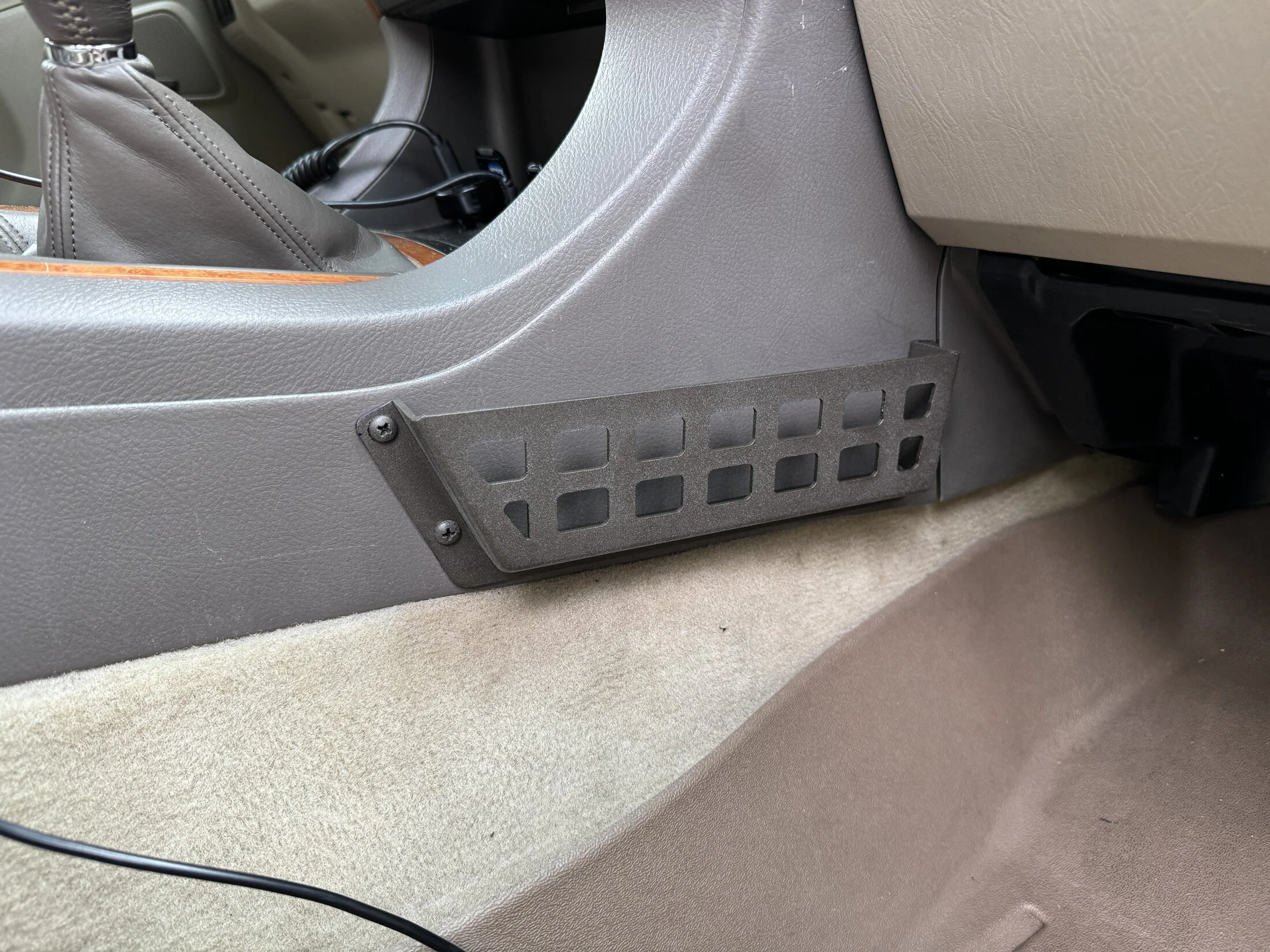

It is not perfect, it blocks the seat from moving completely forward, maybe ~1 inch shy. And since the plastic trim is not perfectly flat it does bulge out a tiny but at the seam in front of the pocket.
I was originally going to do this on both sides, but I think the drivers side one may get in the way of my leg or the pedal, so I'm holding off on screwing that one in for now.
Total cost was about $45 including the 2 cans of paint.
Worth noting other companies sell molle panels that go in this spot, but they are not pockets, and are pretty pricey.
