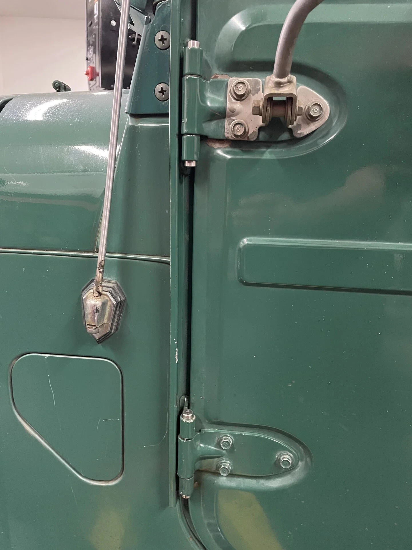

Split window?

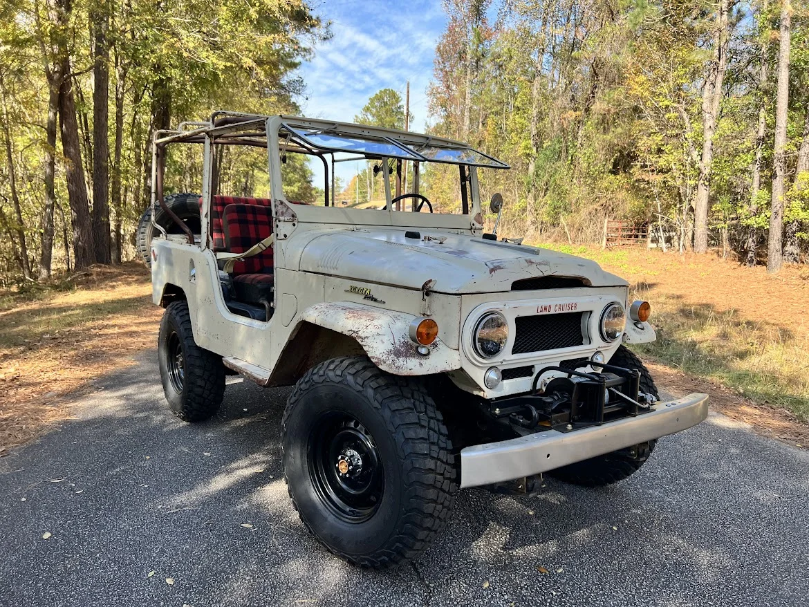

Yep…Safari Split Windshield!
That rig is fantastic!
@wngrog getting so good and having you work on your own cruiser is like me having a “experience farm life” business to get city folk to do my chores and pay me for it.
Hahaha! Seriously!
Let me know when I can come by…🤣🤣
I believe the the split windshield came from Eshan in Pakistan back when he was sending stuff over in the mid 2000s.

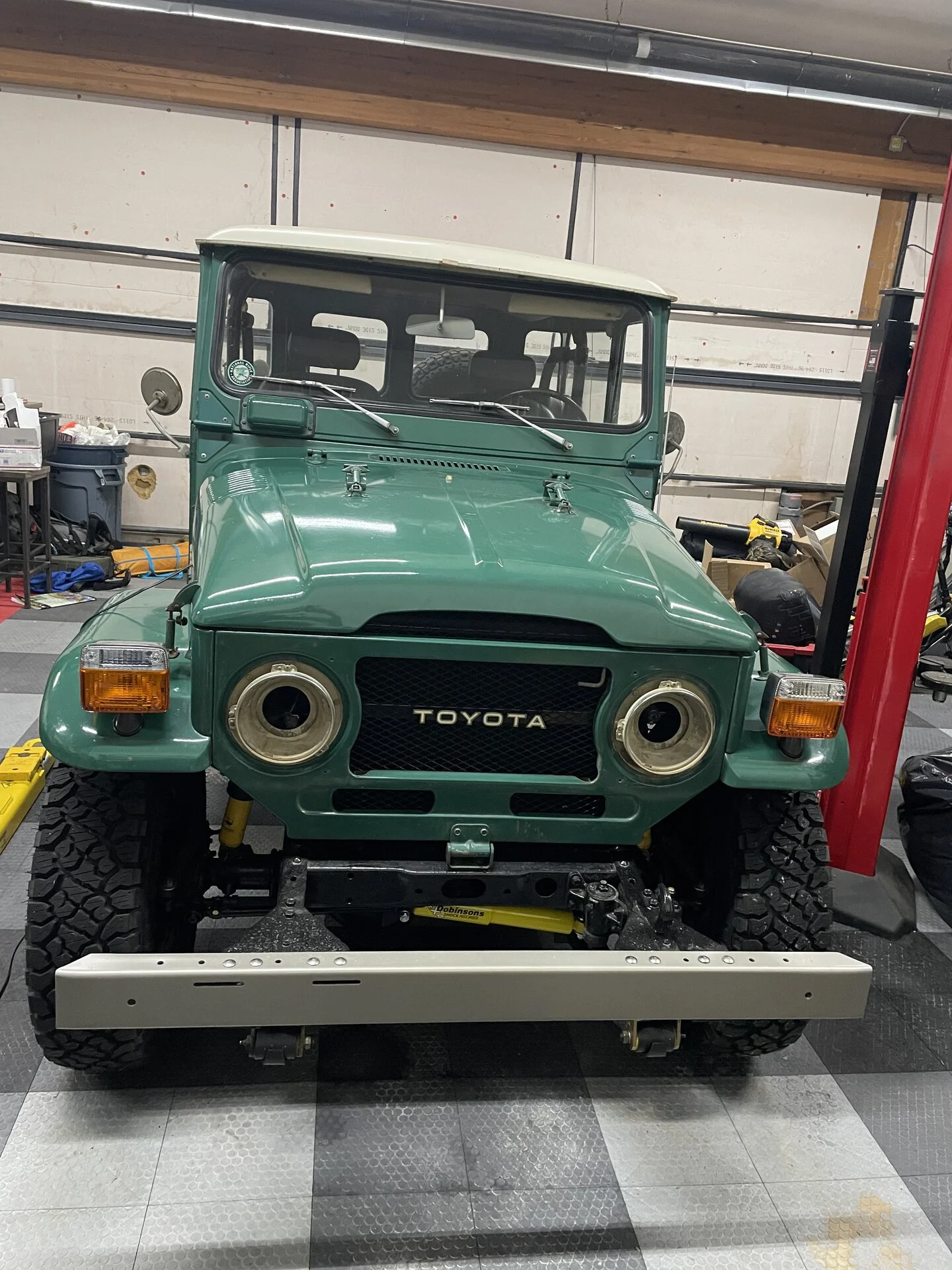

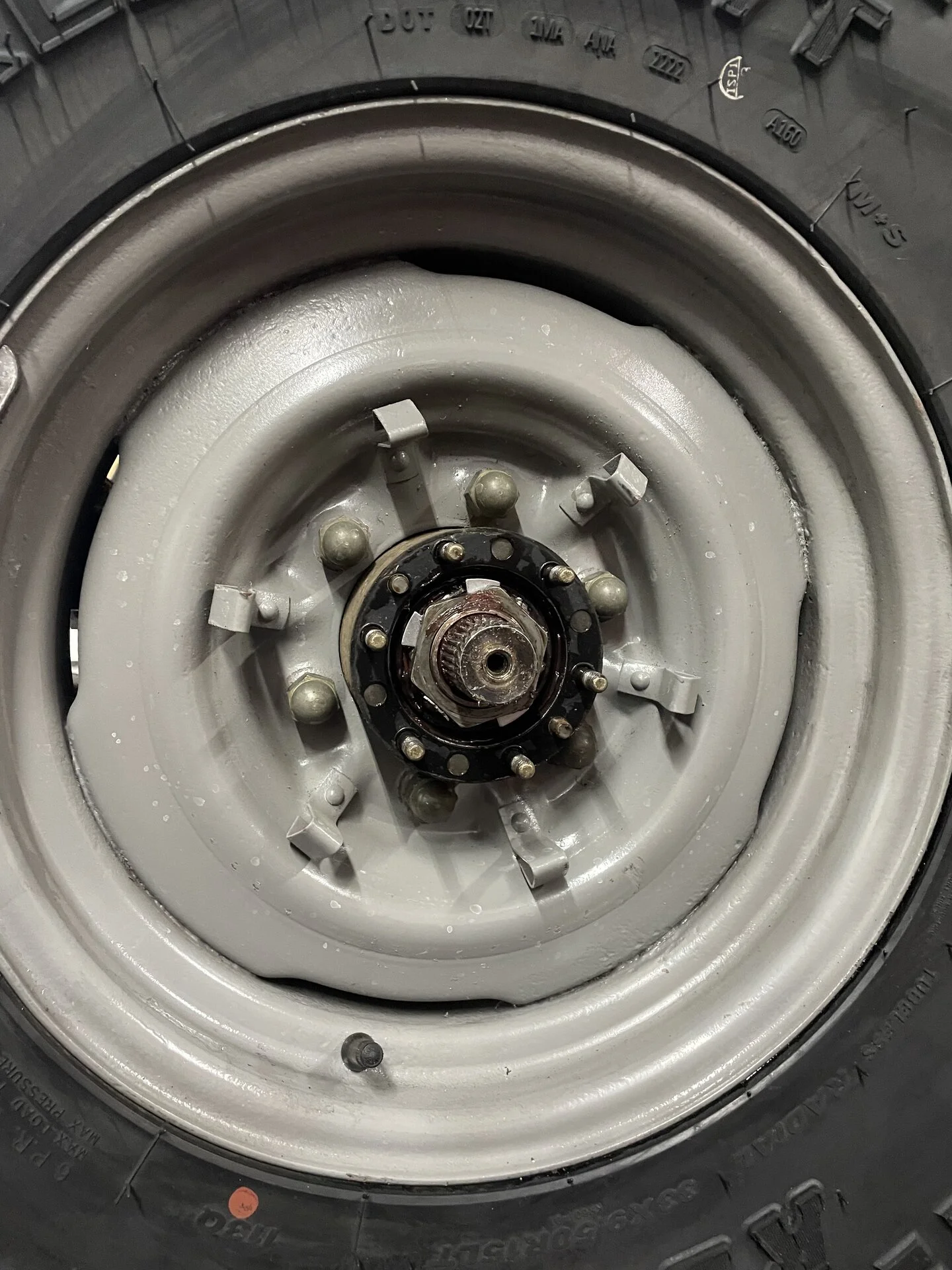

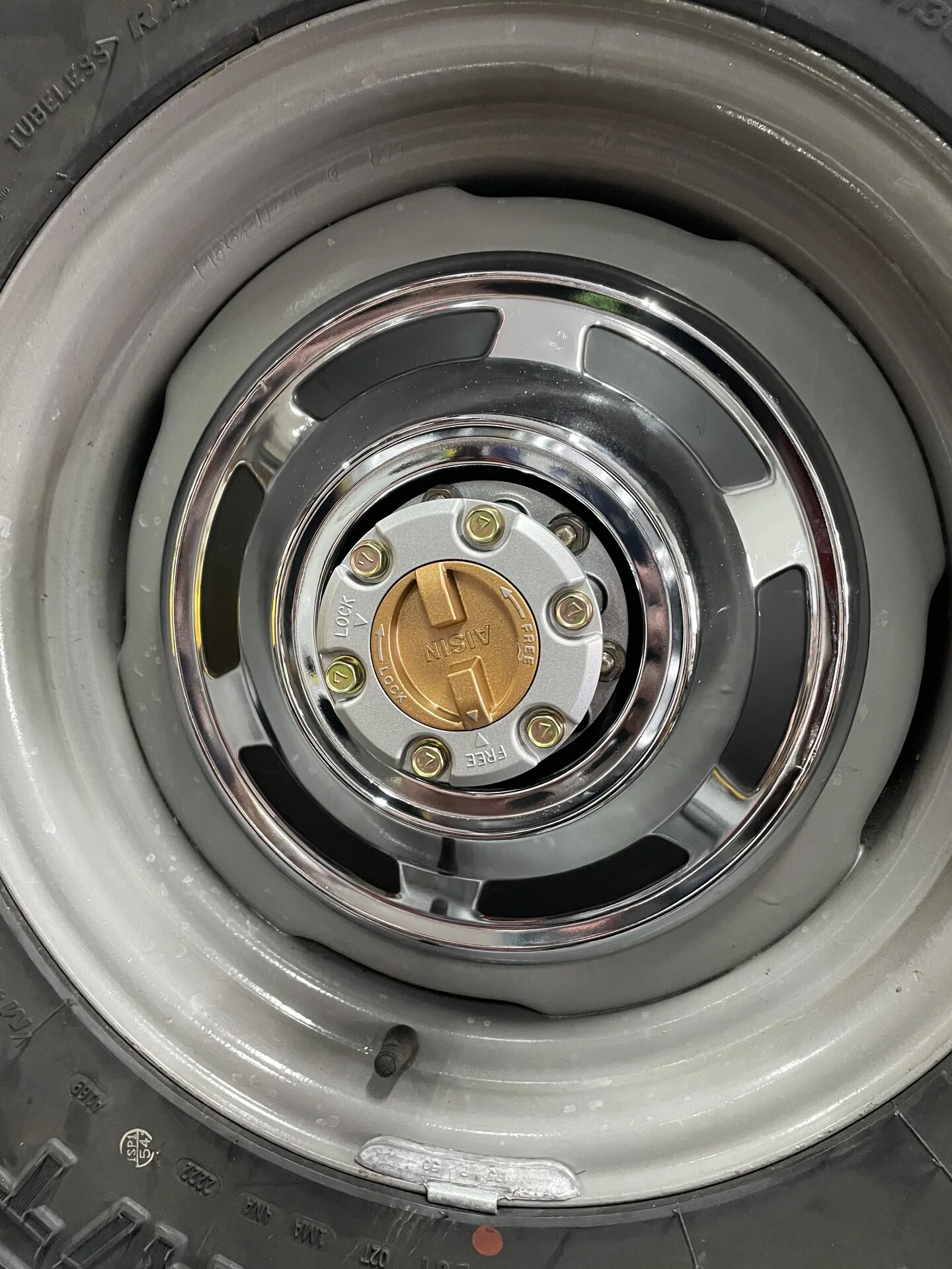

Couple of updates!

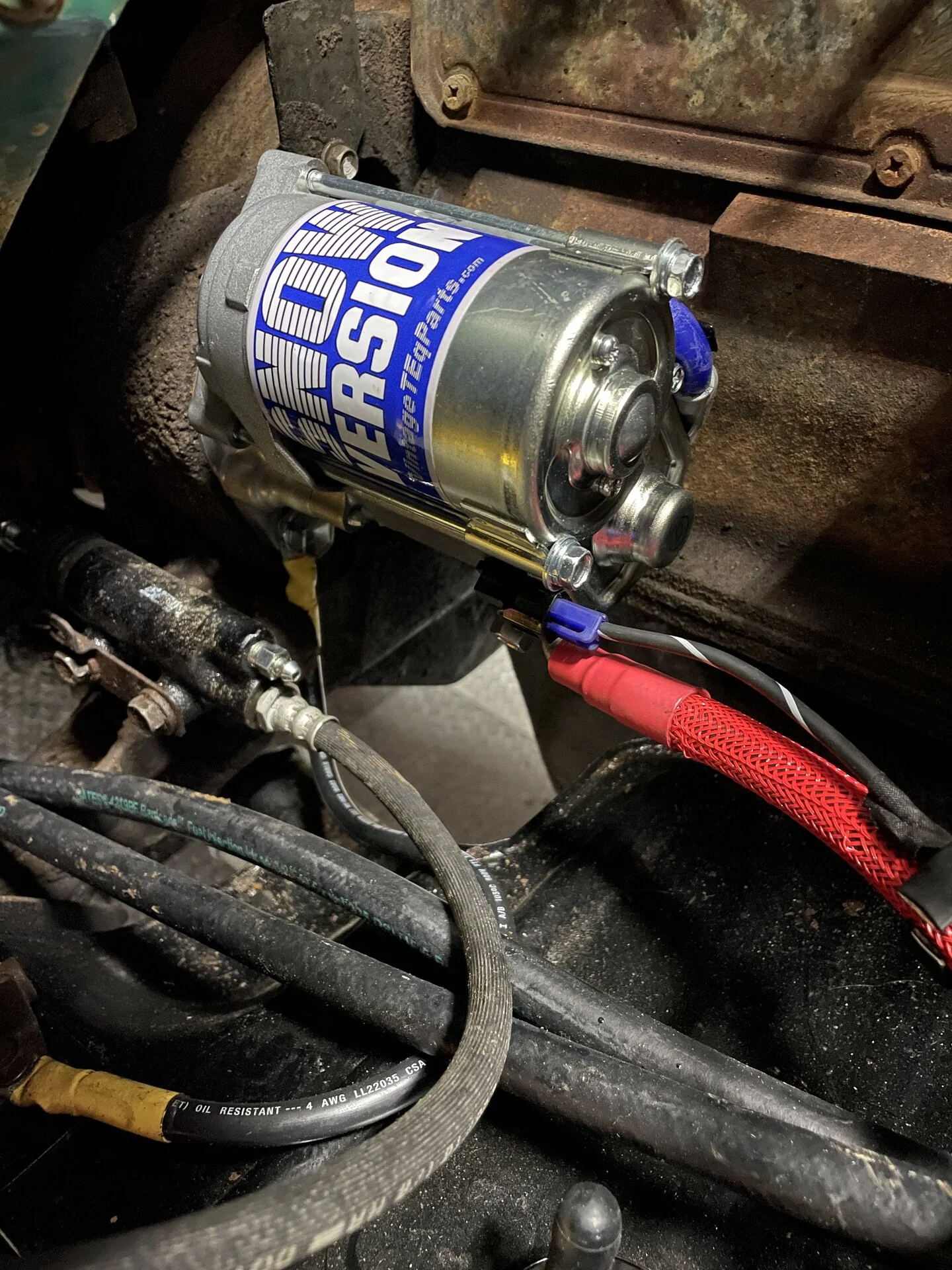

Got the gear reduction starter installed from @ToyotaMatt

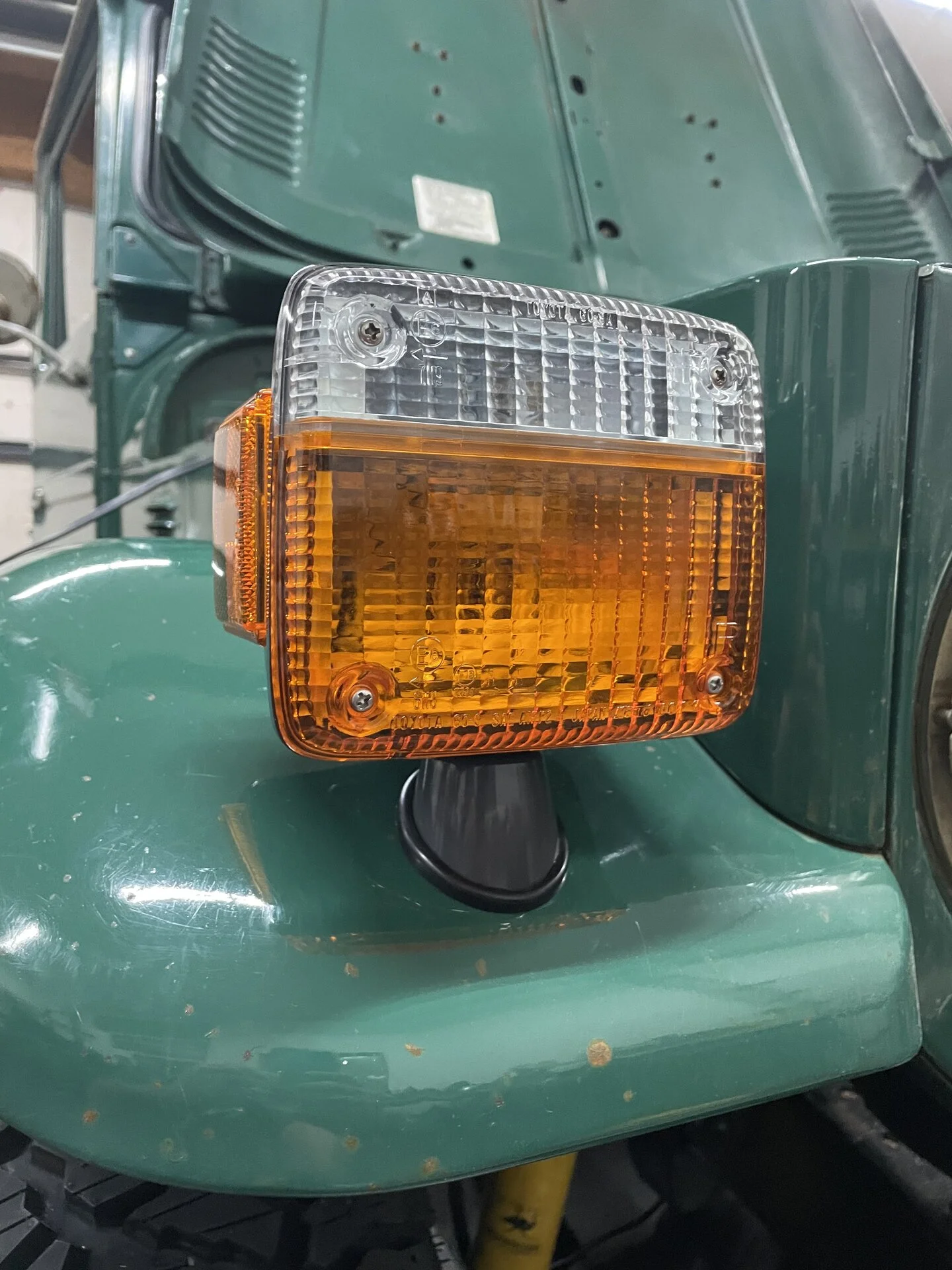

New OEM turn signals from @cruiseroutfit

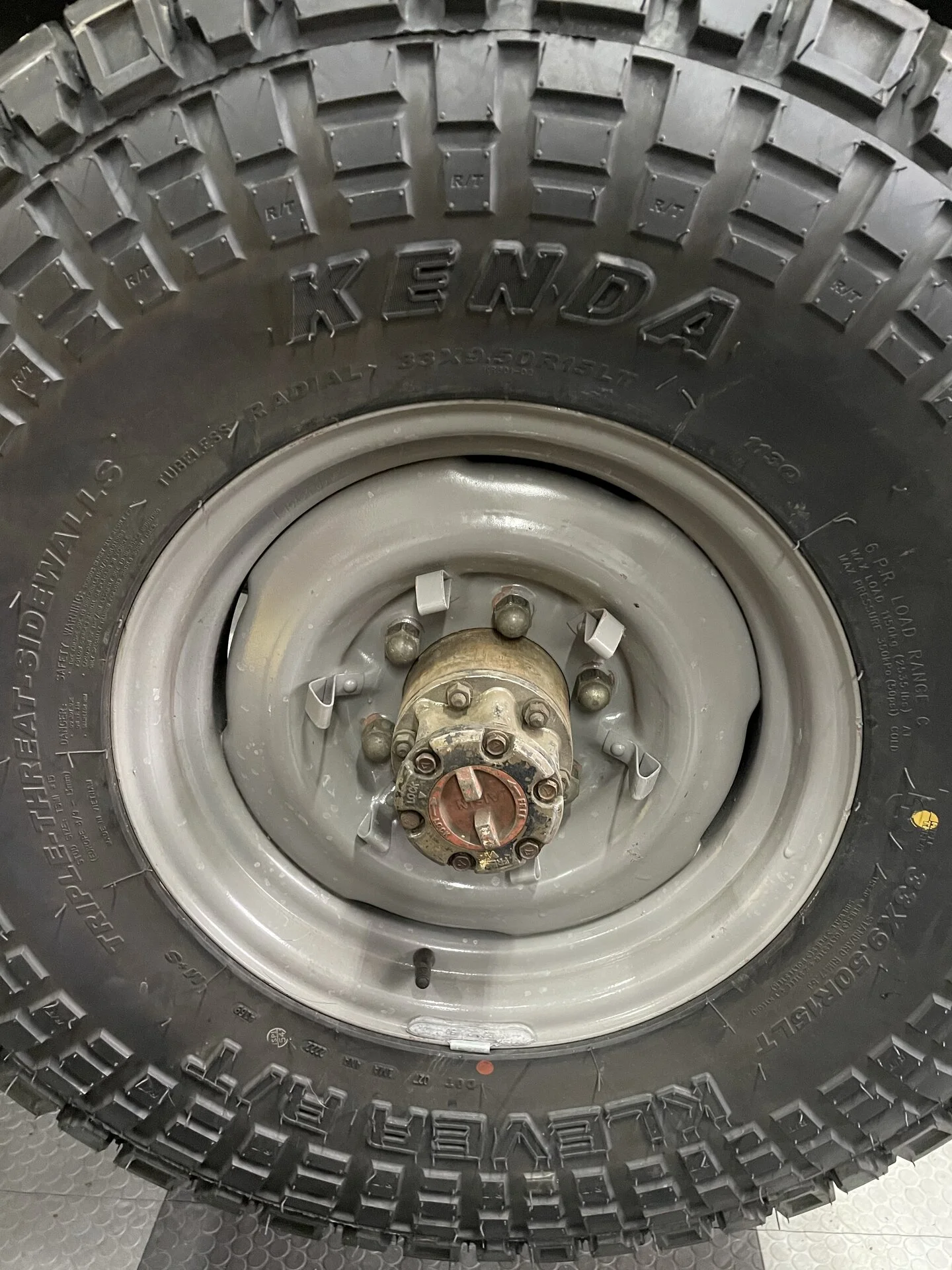

Next project are new hubs (some bling), @SMG pins and finish headlights!
Honestly, the rig didn’t need anything but it fun to mess around with while we have so much snow!

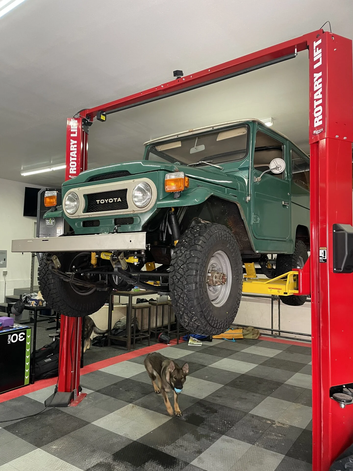

I would use something like this -
from Parker or the like to secure those two fuel lines resting on the ground cable and chafing against the end of the heat shield. Don't want fuel under high pressure to spray over the engine compartment.
Awesome call out...I will get that done! Thank you.
