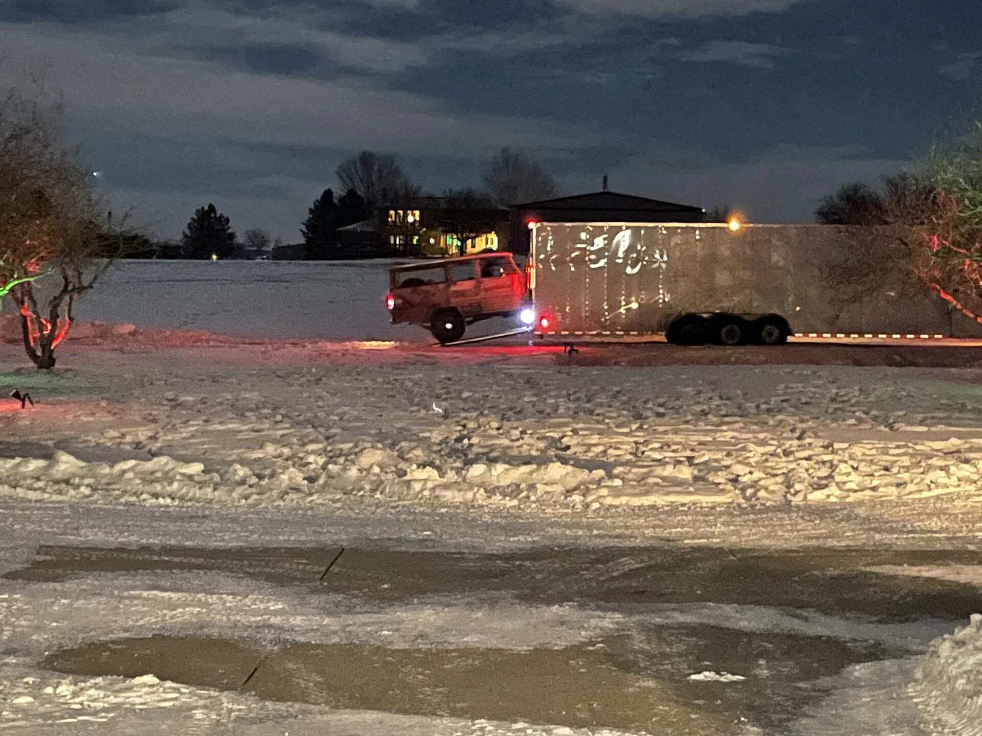

And now that I’ve correlated this thread with another thread, is that LV going on the trailer and heading east?
Not by me but yes.
Didn’t know where else to put this, but because you asked here…
She’s off to a great home and something else showed up!

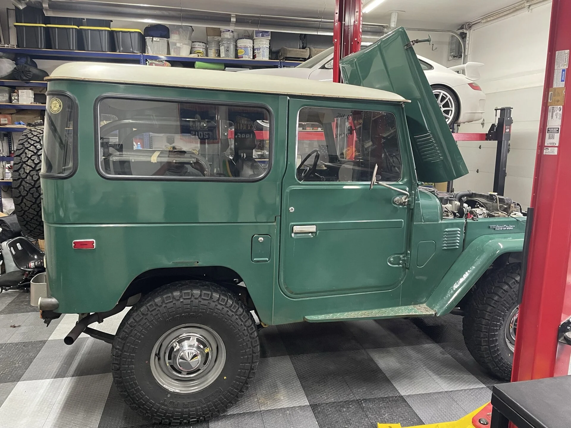

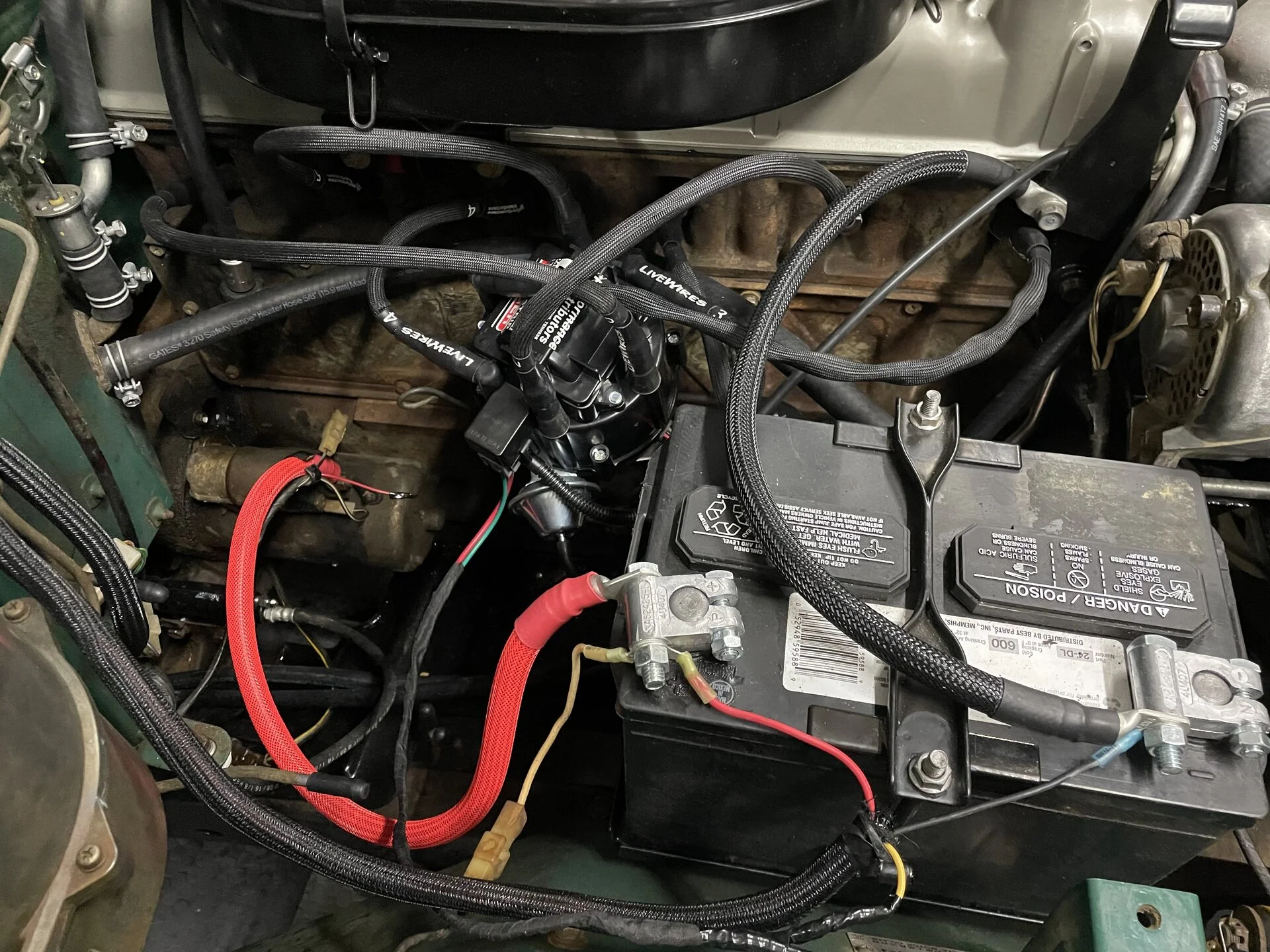

I’ll start by saying I not the best mechanic…but I have lots of tools and a nice place to work!

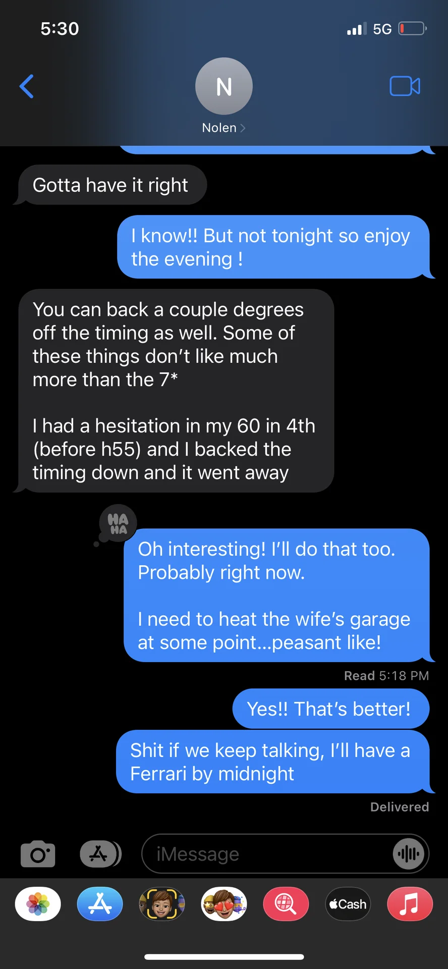

Nolen mentioned that I should consider a couple of mods to round out the project, first was dui distributor and new wires.
I got it ordered and tackled it last weekend.

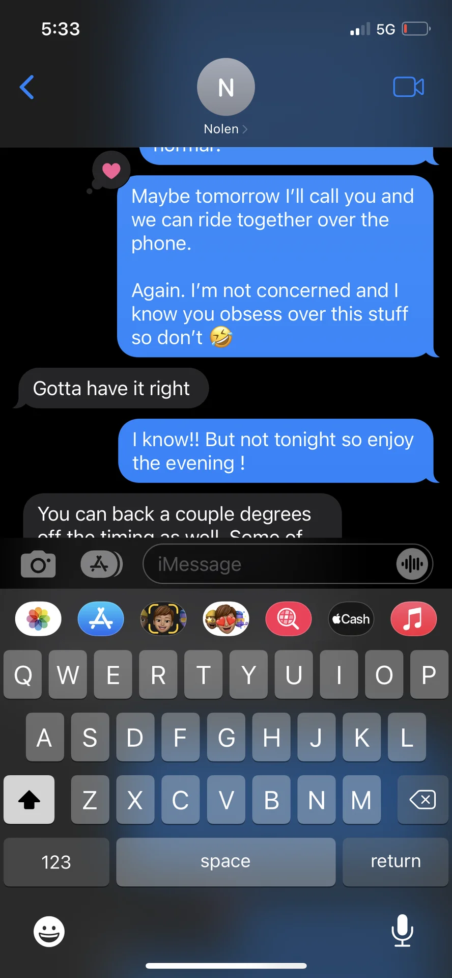

Everything went ok, but it wouldn’t fire. I sent Nolen a text to ask for help… true to his reputation he called within 2 mins.
Took him another min to diagnose what was wrong…I needed to have tech signal attached and I probably had wires 180 degrees off.
Sure enough I fixed both of those and boom!
He walked me through setting timing and adjusted the clutch to my liking…she’s a runner now!
Received gear reduction starter yesterday, which I’ll get put in next week sometime.
