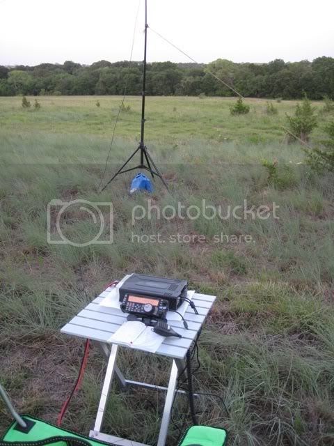

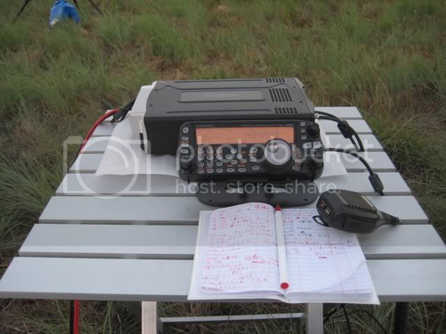

I am probably in the minority, but I have two mobile radios, one VHF/UHF and one HF. My mobile HF radio is a Kenwood TS-480SAT, but I don't like having DX QSO's while I'm driving (too difficult to keep a good log) so I mostly just set it up in camp at night with a Buddipole for an antenna. I also like to run APRS all the time so a dual-band VHF/UHF radio makes more sense for me there.

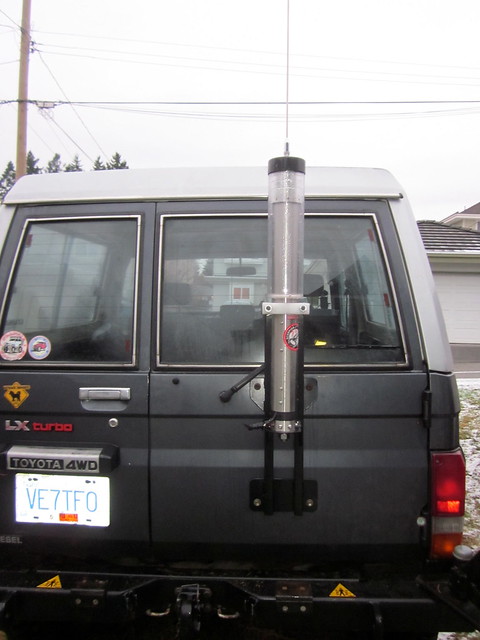

I got a Scorpion "shorty" and had Jason @ cruisin off road build me a mount. I hope to have the whole works installed and up and running in a week or 2.

I like mine, and have had it about two years. The audio quality is good, and the DSP and filtering is adequate for my needs. I have the optional filters to install but have never got around to it. The tuner is nice to have, and I use it with an OCF wire dipole at home to get 6-40 M easily and sometimes 80. Away from home, it works well with my Buddipole, usually configured as a vertical with a single counterpoise. I have made contacts all over the world with this radio, barefoot with 100 watts and less-than-optimal antenna(s).
