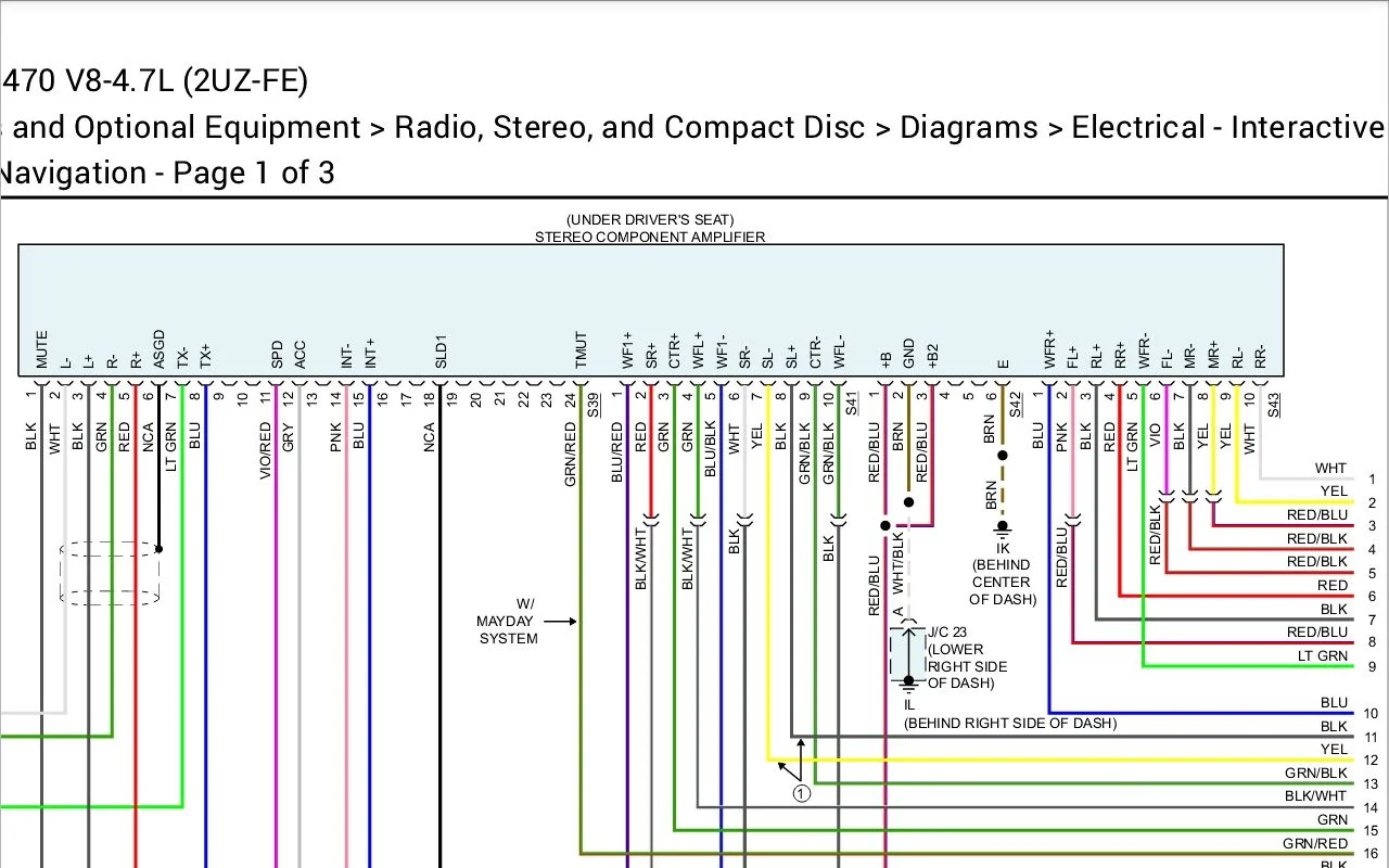

Hello. I found an image for the ML amplifier wiring but I'm having a hard time deciphering it. I need to know which wires are the outputs for the 8 speakers because Im bypassing the amplifier completely. Some are obvious like CTR+ and CTR- as being the center speaker which i will not use. I need to know which wires are for the front left and right, second row left and right, and third row left and right, Thanks!
Look on page 35 of the sound system electrical wiring circuit diagram available on the clublexus GX 1st gen FAQ Sticky page. There you can DL a pdf of the audio system diagram. There is also a page of recommended upgrade speaker replacements since the OEM ML speakers have non standard resistance values.
