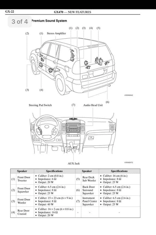

He then mentions that I may have a bad speaker where ohm readings less than 6 ohms may cause the amp to shut down.
Before I start tearing things apart, I'm looking for advise where to start testing. I don't see any pin out diagrams from the Amp to Speakers where I could test ohms from the harness without having to go directly to the speakers.
If I do need to pull door panels off to test, does it make sense to unplug the speakers and try running the amp for periods of time to try to find the issue by process of elimination, or will just a multimeter ohm test tell me enough ? Lastly, I cant seem to confirm the Ohms for the sub. Is that 8ohms as well

1) Ripped door , cargo, and subs rear qtr panels off and tested all speakers for ohms and condition. Center speaker housing pops off to remove that so thankfully did not have to remove the head unit to get to it.
2) All speakers tested fine for expected ohms and actually look great.. No damage at all. Both front tweeters were abt 5.8 ohms but I don't think that's out of line to cause any issues

4) Sub is 8ohms single voice coil for those still wondering.

Tweeters are actually 6ohm in the ML system so that makes sense.

Can the existing Nav run off the mid range speaker in the door.. I believe its currently the 6x9 that plays the audio??

The NAV plays through the drivers door 2.75" speaker. You'd have to retain the amp and reroute to the dash speaker if you want it to work.
