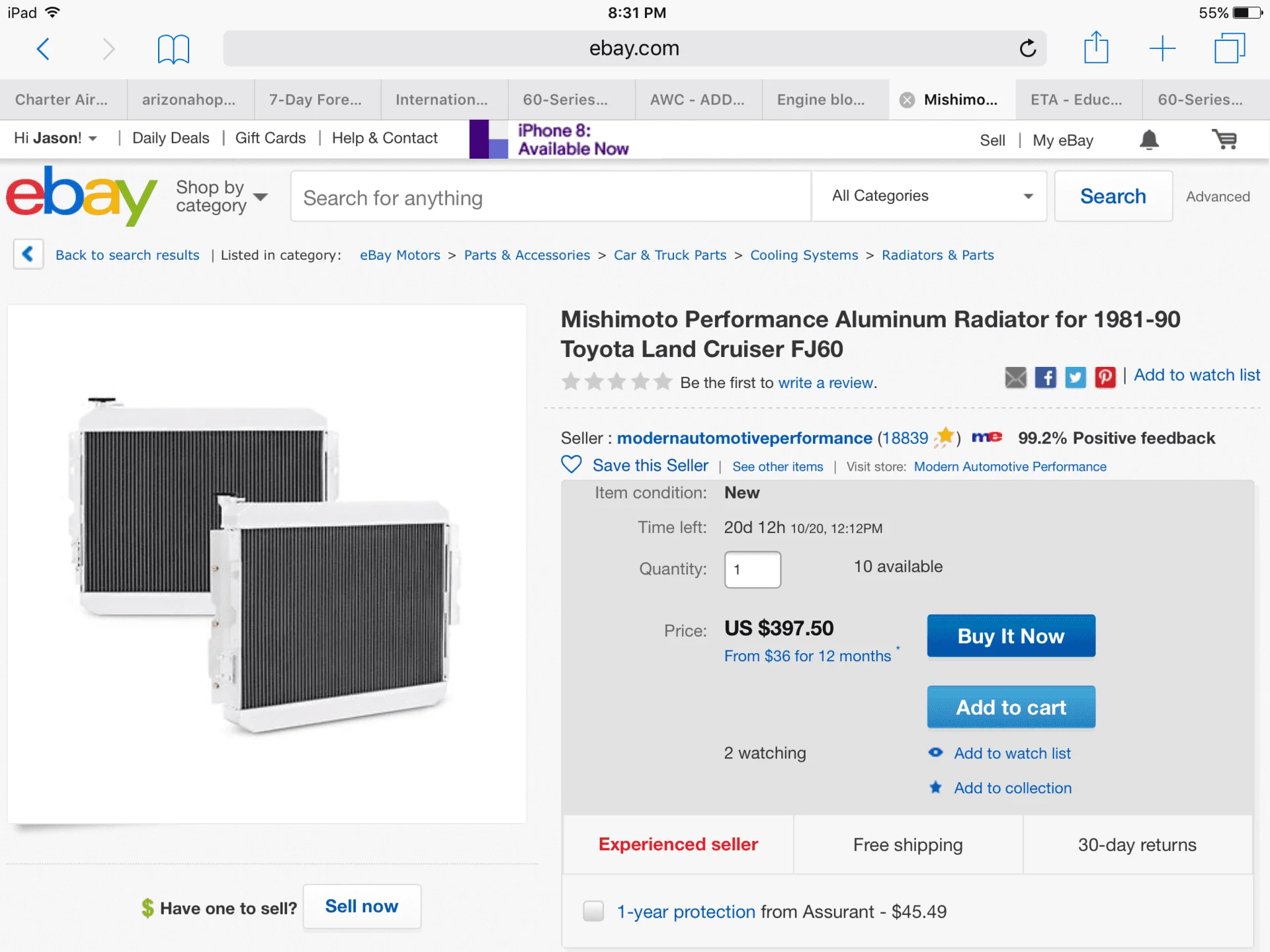

Hey V8 and cooling gurus......here's a clip from E-bay on buy for a Mishimotor aluminum radiator. Is this a good buy or not??? Has any body used one of these?????

Yep I'm going to to get a Mishimotor radiator!!!! However here is the bad news...........l have made two attempts at getting Mishimotor radiator through two different distributors on e-bay. I Was able to talk to one of the distributors and Mishimotor representative and that say they are currently out of radiator for the FJ60 until the end of November. December first is when they producing more FJ60 radiators.
But here is detail of the radiator is the part number and it showing a wide range of years. The e-bay add says it good for the I-4, V-6 and the 4.0 liter I-6 engines. So my question is to those that have put a Mishimotor radiator in there FJ60;
1) was it a drop in replacement ? Did all the mounting holes line up ?????
2) if there was any modifications needed for instillation what were they?????

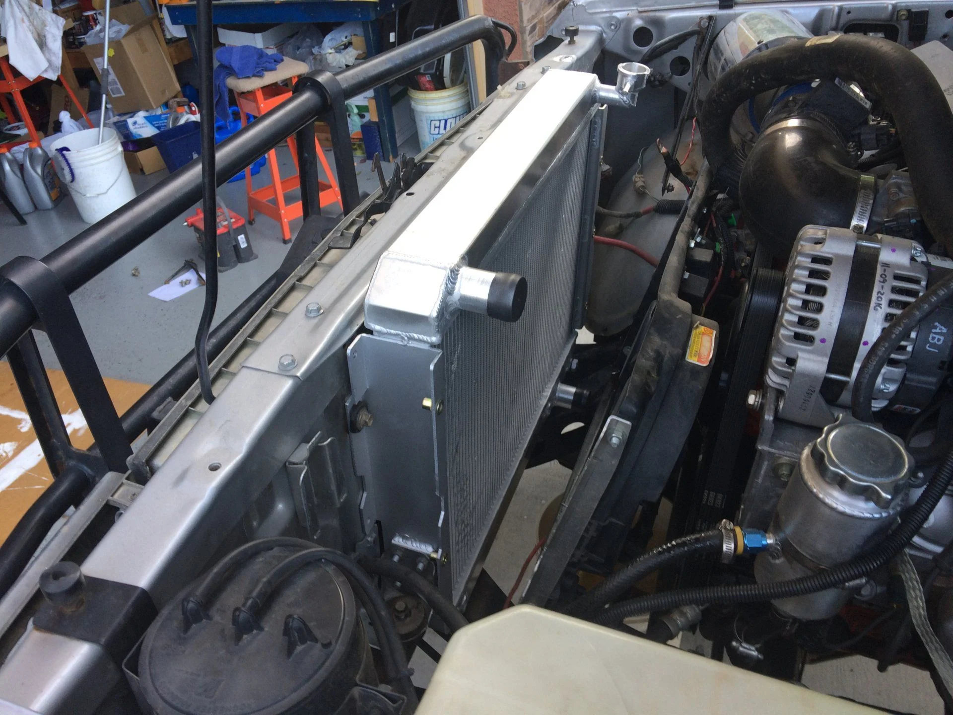

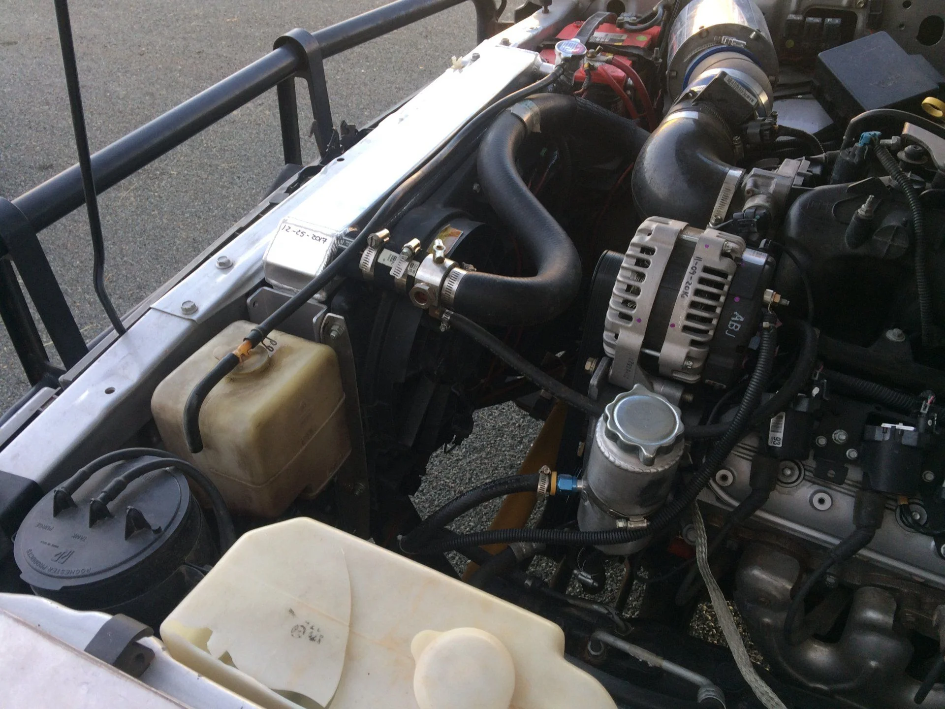

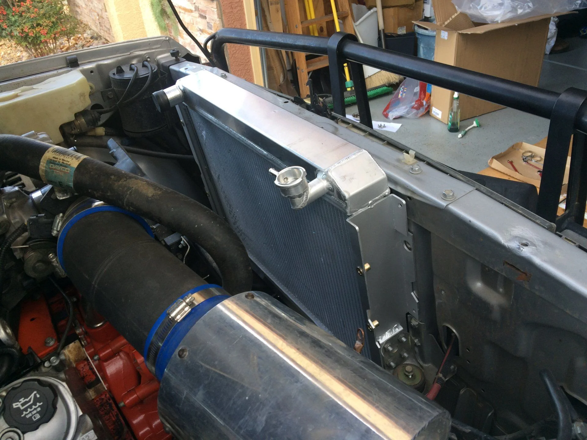

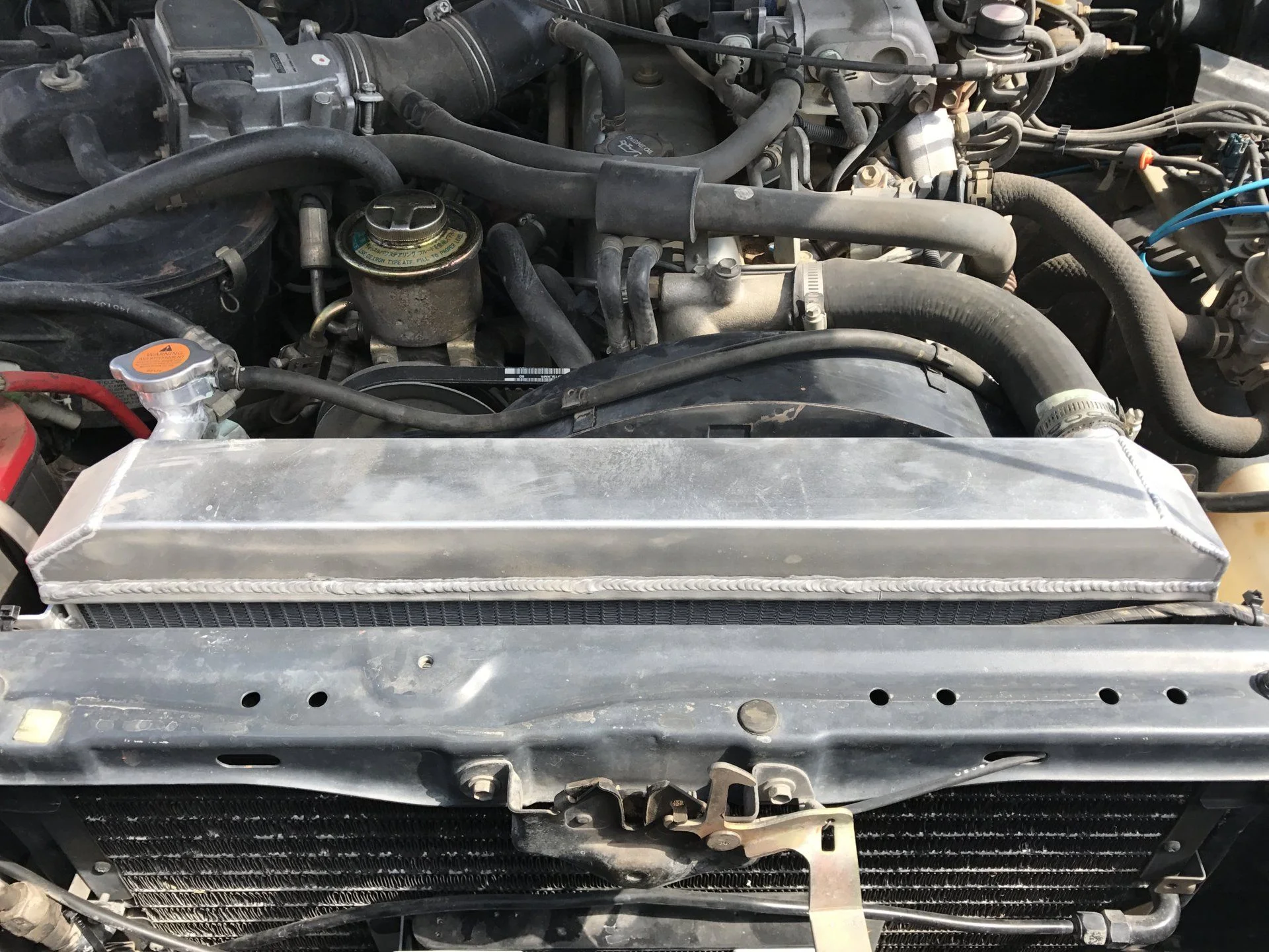

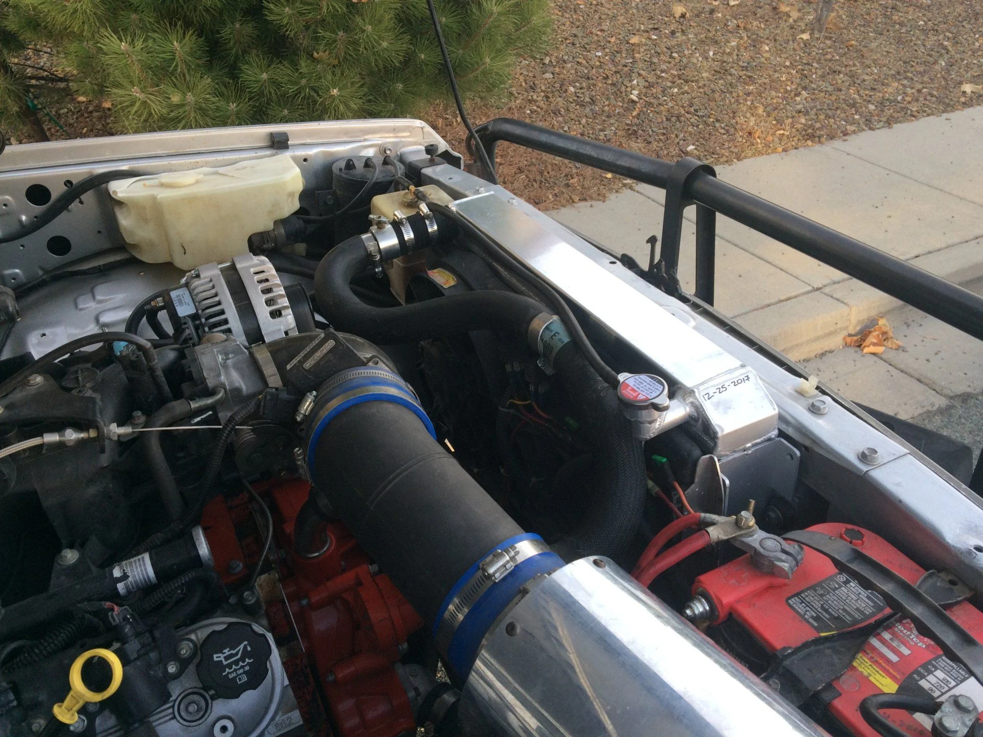

Here's a picture of my completely in stall of Mishimotor aluminum radiator. Pulling out of the old copper and brass 3.5 hours. I order the radiator off from Amazon on November 12th. Finally received the radiator on December 21st. Pissed me off Amazon uses a third party to supply with Mishimotor aluminum radiation. Why can't Amazon buy directly from Mishimotor or have supply on hand.
Final job was a complete bolt in. Right down to the electrical fan shoud.
First and final trial fit !!!!
Should do about 50 miles of driving and see how it holds up to a long drive. The new normal seems to be the first quarter of the white arc.
