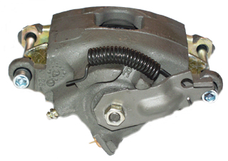

You can have a parking brake with rear discs. There are a couple of options, the calipers from an old el dorado have the e-brake levers on them if I recall correctly. Another option is to try summit racing or jegs, or any of the parts warehouses and look for a brake line lock, some are a mechanical lever, some have electric solenoids. You will need to plumb your brake lines into the cab for the mechanical lever, so bear that in mind. And if you go the mechanical route you can install a proportioning valve in the cab to dial in your rear clampage and not rely on that failure of a design that's on there currently.
A couple more things to consider with rear discs, they are self cleaning, lower maintenance than drums, and a heck of a lot easier to do a quick visual inspection, rather than having to take the whole freaking wheel off, trying to pry the drum off, then remembering you left the parking brake on =p. Also with converting to rear discs, there is the issue of the possibility of needing a larger master cylinder as you will have increased the volume of fluid you need to move versus the movement of your pedal. The el dorado calipers as mentioned earlier will require a larger master cylinder. You might be able to use your current one with toyota calipers.
Yup ^^
Brake calipers with integrated e-brake
