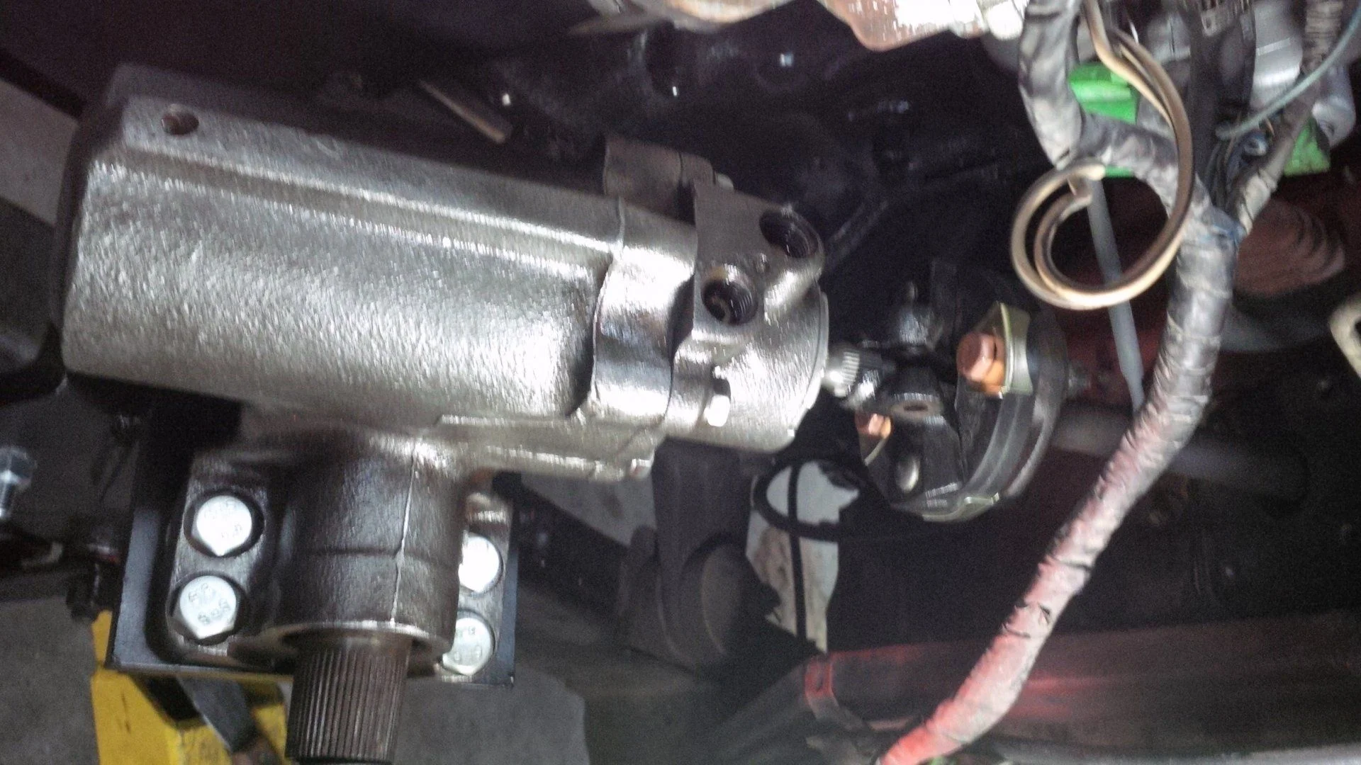

Finally got around to removing the old steering gear box and mounting bracket by cutting off the rivet heads drilling and pounding the remainder of rivets using a rebar with one end shaped into pencil point as recommended by Danny pngunme the removal process was easy although tedious. Thanks Danny!
full
Then I installed the new bracket and new PS gear box
I purchased the PS bracket from Georg orangefj45 and fits nicely on the frame rail, thanks Georg!
full
I used the existing mounting holes on the frame rail from old steering bracket to install the new bracket, perfect fit!
full
full
full
Upon completion of installing the PS box I noticed the PS shaft doesn't line up with the steering column shaft, what did I do wrong?
I tried to align the two shafts to no avail
Does anyone see where I failed in the installation process?
full
full
full
Vertically it aligns well, however, horizontally it is off by +/- one inch
full
full
full
full
Please help me figure this anomaly out,
I appreciate all your input in advance!

Erik, that looks like a great solution! Did you encounter the same misalignment issue with your install? Others have used the same setup as mine with great results, so now I'm wondering if I messed up somewhere along the install, I don't know if I need to drill new holes in order to align the shafts, however, there's no room on the bracket to move the PS box to a more aligned location. It's only a one inch difference but the rag joint will not allow it.
Georg, thanks for your valuable input! I'm not frustrated yet, just trying to figure things out. The body mounts are spot on all around the rig, the frames appears to be true as well just by eye balling it. I think Murphy's law has kicked in with this mod but not sure as yet.
Did you encounter the same misalignment issue with your install? ....... It's only a one inch difference but the rag joint will not allow it.

Is there room to redrill the holes more inboard on the pedestal?? How does the new mount compare to the stock mount as far as hole alignment? I understand the angle and distance may be different, but the relationship of the holes should be similar...maybe?
I just looked at the pics again. When I checked them out earlier ( and responded ) I was looking at them on my phone. Now I'm using a bigger screen and I'd have to say that's the worst mis-alignment I've seen. It's somewhat perplexing since the cruiser supposedly has good body mounts and hadn't been in an accident....... Along with the fact that vertically it looks just about perfect.
Mike, could you try yo install the pitman arm and relay rid to see how much clearance you gave between them and the frame? That should help narrow things down.

It turned out to be a simple fix after repositioning the PS Box a few times, all it took to properly align the box were two 1/16th inch washers as depicted in pics below.
full
The PS box shaft is now in perfect alignment with the steering wheel column
full
full
full
full
Installed the pitman arm temporarily to check for interferences
full
The relay rod is now a bit closer to the frame rail, however, with a few adjustments it should fine
full
The relay rod appears to happy with the new pedestal bracket and PS box, however, I noticed some interference with the two lower bolts which come in contact with the relay rod, I'll trim the bolts and that should solve the problem.
full
Next I'll remove all the PS system components for painting and then final re-assembly.
Question: How did adding 1/16" washers under the left (to the photo) two bolt holes on the mounting plate shift the PS box to the right (to the photo)?

Good problem solving! Can you feed the bolts in from the outside with the nuts on the inside? Then you won't have to cut the bolts and the bolt head is still probably lower profile than the nut.
The box as tilted down and to the left, I suspect. The shims canted the left side up and to the right just the right amount.

GAA, the washers actually changed the angle of the box which had a very short pivot point on the box mounting plate and that was enough to re-align the PS box, I was amazed as well. I may need to tweak it a bit more during the final installation and adjustment period, but now I know the trick. I was really determined to fix it as inexpensively as possible and I didn't want to spring another couple of hundred $$$ to buy a double steering U-joint and also a bearing bushing for the bottom of the steering column since I had recently purchased a brand new rag joint.
