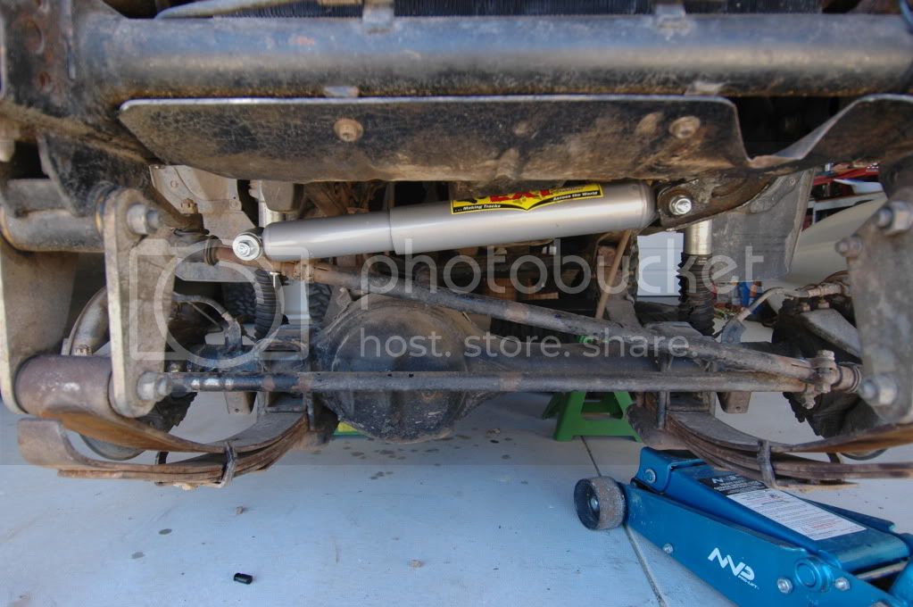

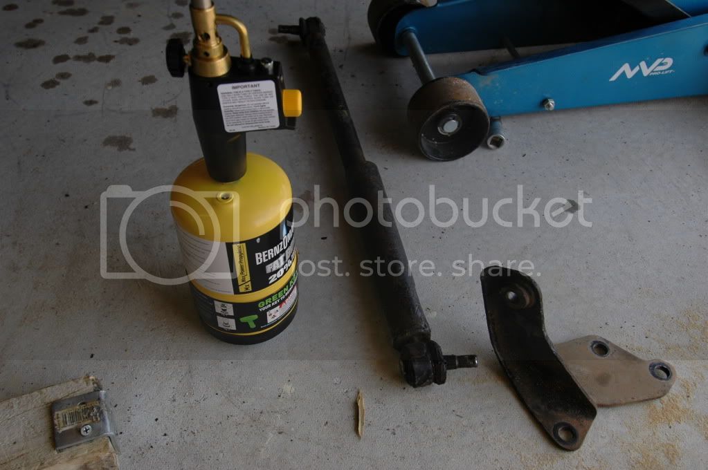

I decided to start with the steering damper. After 2 hours of chocking the mount various ways and hammering the living crap out of it I decided to go to bunnings and get one of these. 10seconds torching around the mount and it came off sweet.
Steering Damper in, I had to fiddle around with the clamp on the left so it didnt bind up on the steering arm. Because my diff is moved forward and the new damper is a much thicker bore than the stock one this proved very difficult!

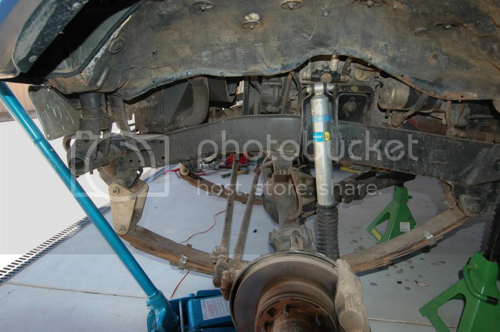

I also flipped my bilsteins round the right way. This was quite a job because the bushes are different on each end so I had to press them out and swap them around before I could flip the shock. While i had the wheels off and the torch handy i decided to loosen the spring clamps a bit more and "widen" my shock towers as they were getting a bit close to the shock on full compression.

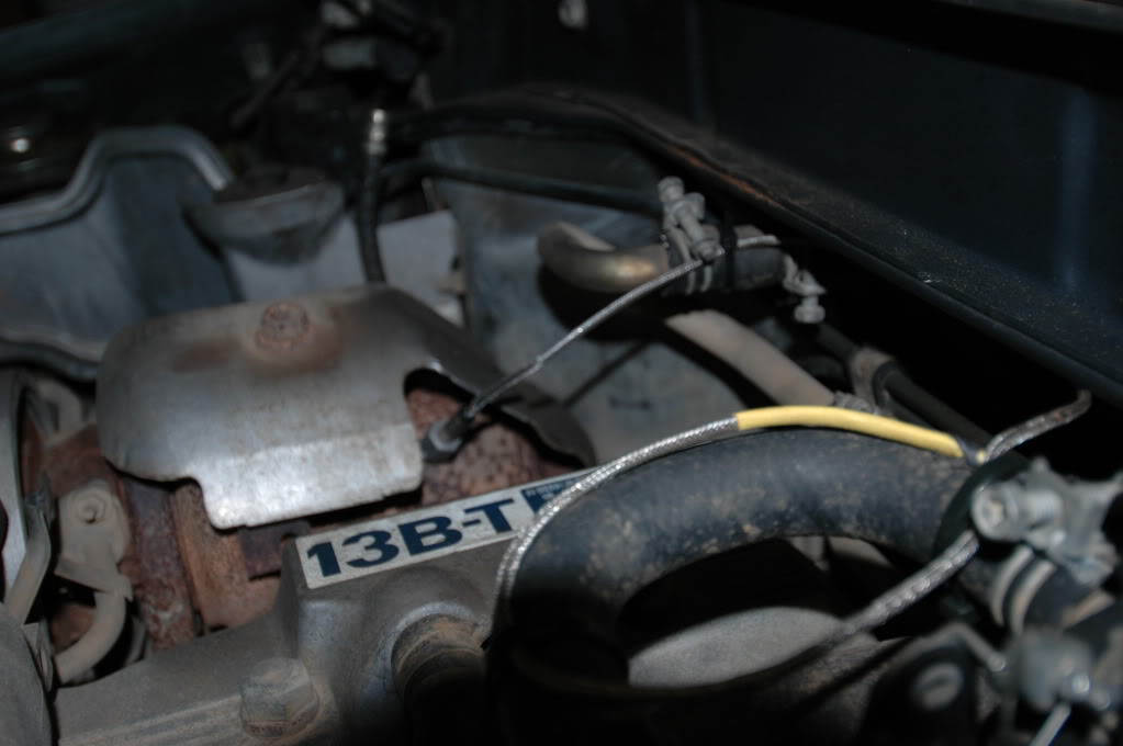

I also managed to source a fitment for the pyro probe. I went to Couplers and found this BSP fitting and bored the centre out to fit the probe. Now I just need to find a BSP tap to fit it. I think I will go post turbo for ease of fitment and engine safety.

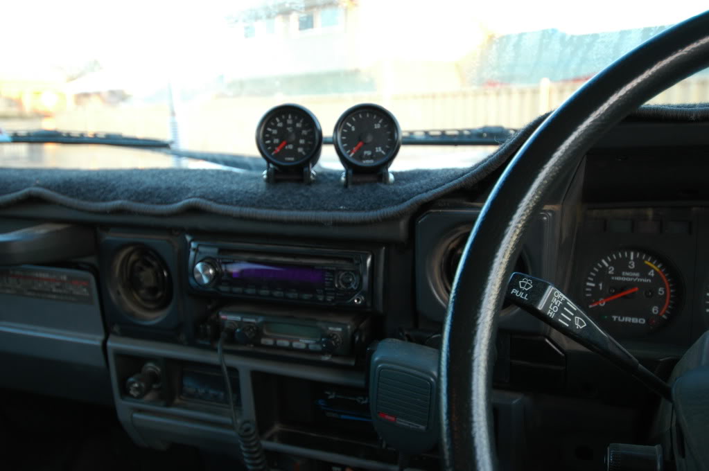

And here is the pyro gauge mounted on the dash

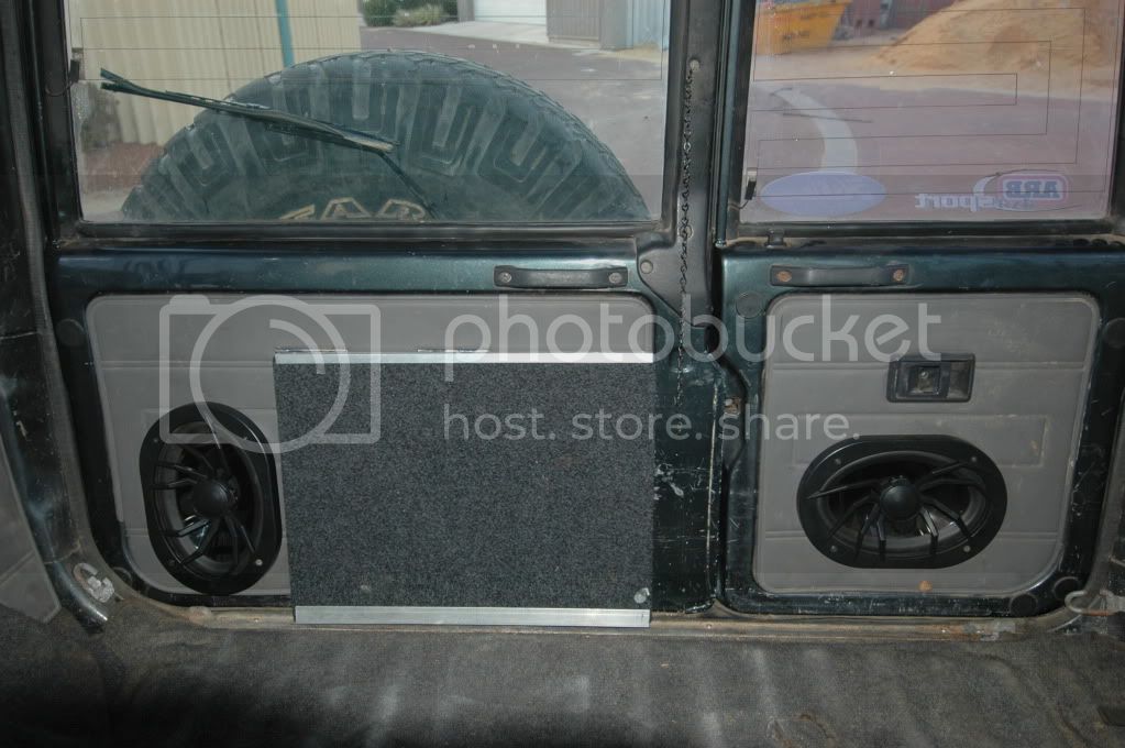

Had these Soundstream 6x9inch 150w speakers lying around from a previous vehicle. I managed to squeeze them in the rear doors, with all the bracing for the spare tyre mount it turns out these are the only available spaces I could fit them in, and it just so happend to let me keep my fold up table :)
I put the old 6inch speakers in the front doors (again this is the only place i could put them with power windows) and disconnected the old 4inch speakers in the dash. For a setup that cost me pretty much nothing man it sounds good!

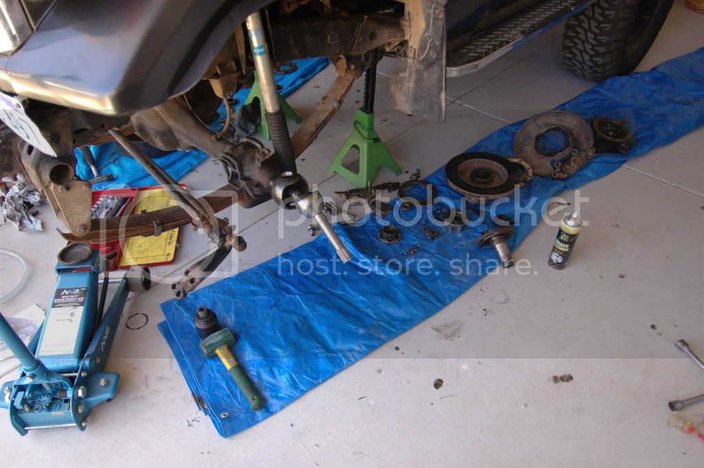

I also did a swivel Hub rebuild, put in new bendix brake pads and new wheel bearings while i was at it.
It was a relitively simple install. Well its probably the hardest thing i have ever done on a car but relitively straight forward with the instructions and service manual at hand. Massive thanks to blair (blurr1604) who came by inbetween shifts all weekend to lend a hand.
Heres a few photos from the install

Oh and I also managed to get the pyro probe installed. My ghetto probe fitting worked like a charm :)

I have only driven it a little bit since doing the pyro. My brakes arent 100% so ill have to sort them out before going for a decent run. On my short little drives to the shops temps didnt go past 300 but i will give a full list of temps when i go for a proper run on sunday.
