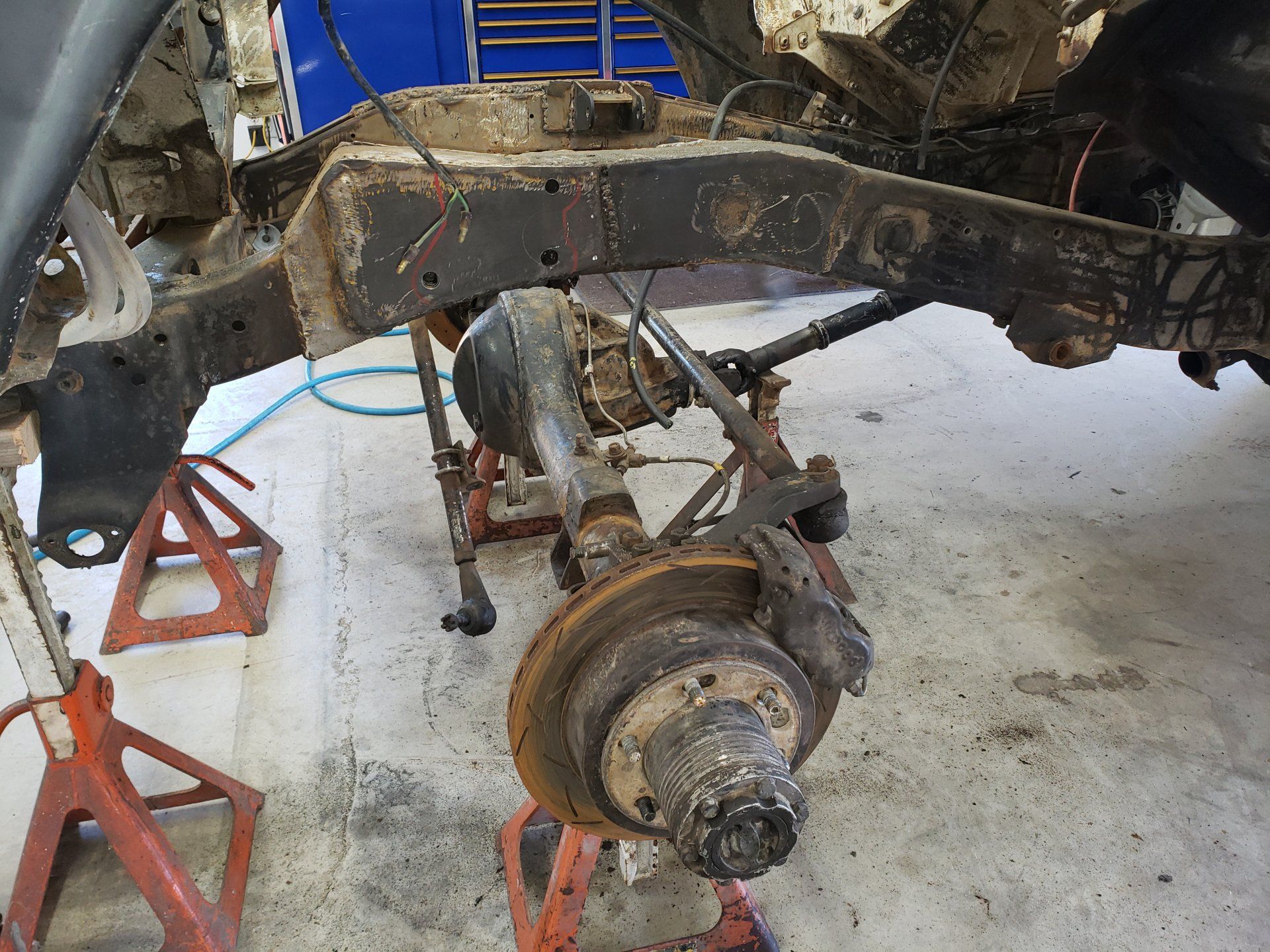

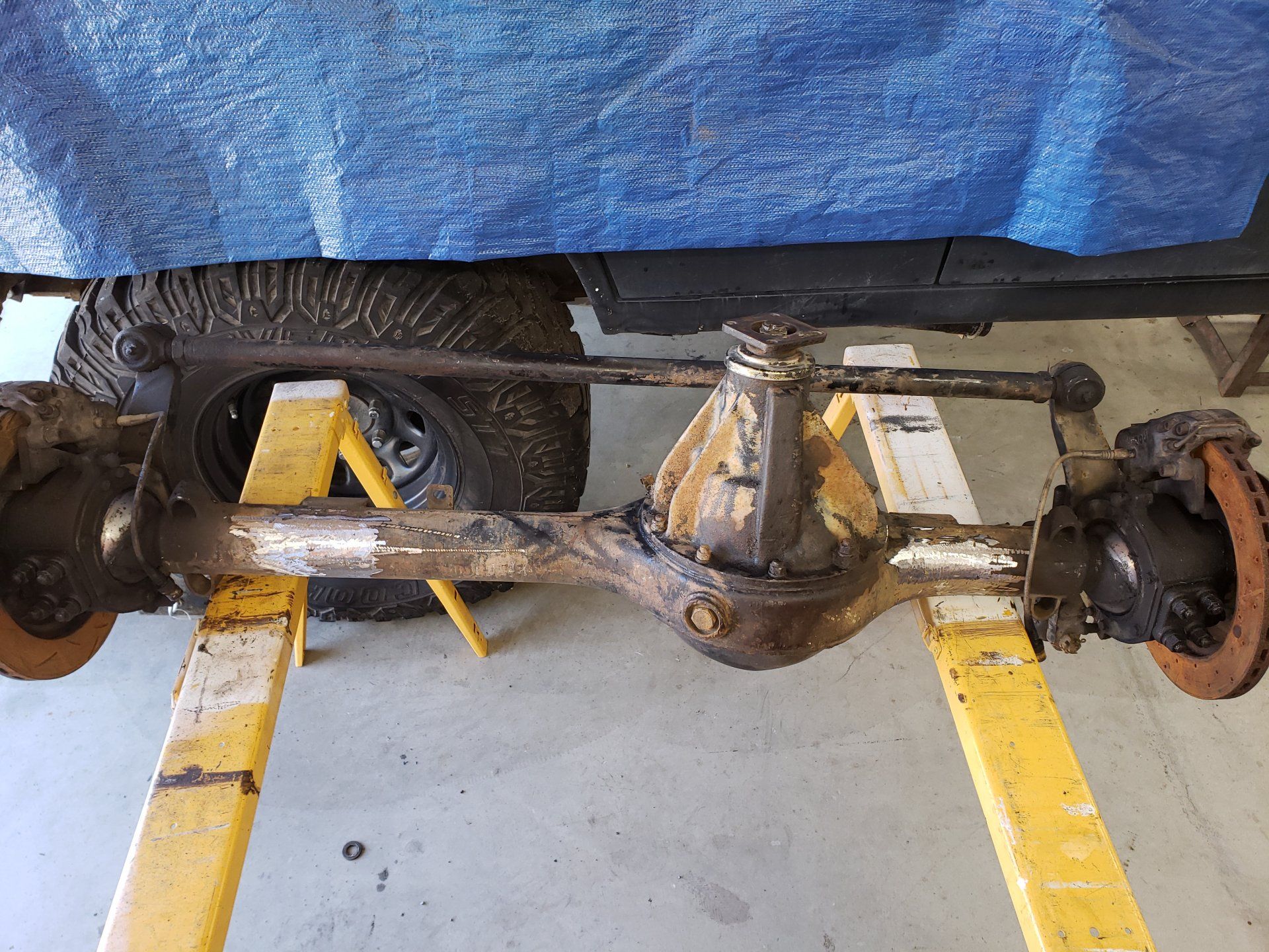

I got the front axle back under the truck and started fitting the radius arms and got some bracket templates figured.
This was just an idea of what it will all look like.
This is the front piece there will be 2 in each side.

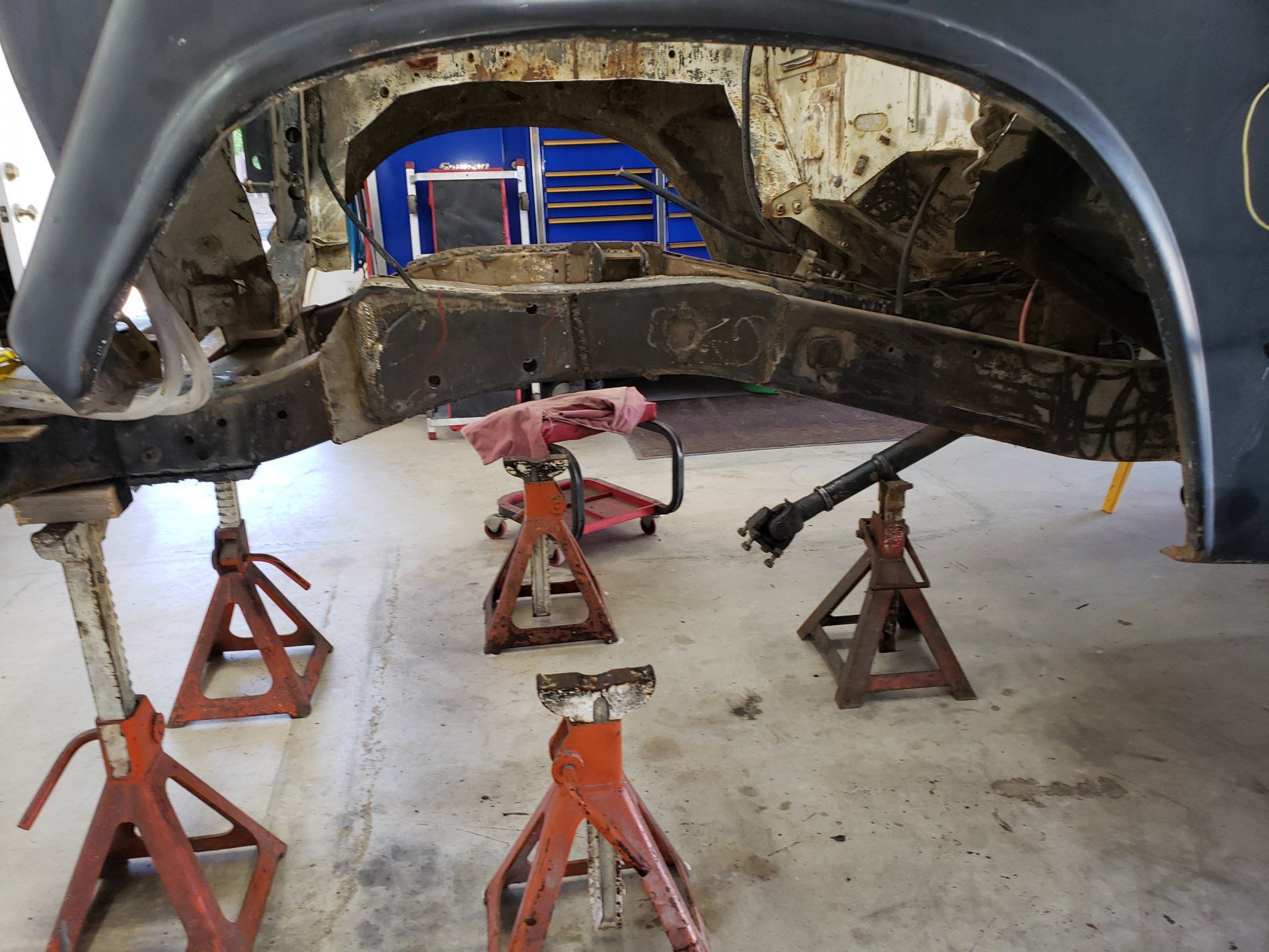

The back part is in 2 pieces. Because the frame is at an angle. There is a bracket that goes on the frame then the second part that bolts to the radius arm will be welded at an angle to match the front part of the frame. Below is a rough idea of that.
Well I can always change things, but going longer will have to offset the mount point more and more because the frame is angling outward. I will also run the risk of the arm hitting the frame on full tire stuff because it is flatter there. Its not convenient but not a deal breaker. I have the arms and they were cheap. I can get the bushing and bolts from Toyota anytime. I like custom but I like off the shelf more.
I hesitate to even post this suggestion given my limited knowledge but wouldn’t it be better to extend the frame bracket to avoid the crossmember? Everything else could stay the same - I think?
Are you saying to skip the part in the middle and extend to the read? I would thing it would leave long portion of the bottom of the bracket without a side flap for strength.
