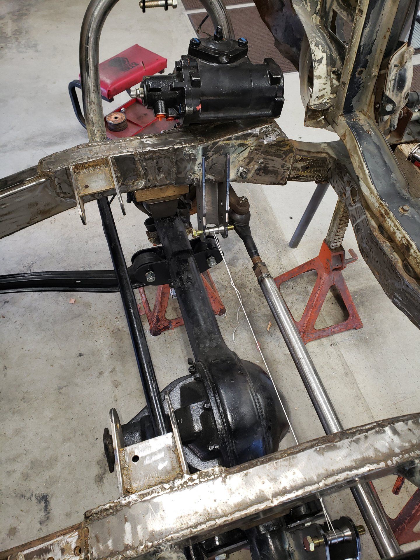

Got a good day in on Black Pig Friday. I am really threading the needle with putting the panhard bar in. The bracket on the axle literally could only go between the radius bracket and turn stop. I had to buzz 1/4" to make it fit. I clocked it forward to miss the shock. The frame bracket had a little more options like 1/2" forward or back. Ran a string from side to side and it was clear a straight bar was not going to work. It was a bummer because a straight bar was almost perfectly level.
Got bar bent and cut and looked great. But the kit comes with heim joints and because of the bend it was going to be floppy floppy. Did some interwebbing and store crawling. Basically bought a link bushing and had to cut it down to fit. This meant the bar we bent was now too short. So we made a new juan. Brackets are still tacked in because I ran out of wire:(

This a 2 weekend update. Last week I got more wire and added cross bars to the shock towers. Also made the panhard bar brackets permanent. The axle on the bracket was a little stubborn. It was hard to see that it wasn't flush all around. Had to buzz a few things to get a good fit. Got new hood hinges and 2x4 tube for the rockers from Landcruisnman.
