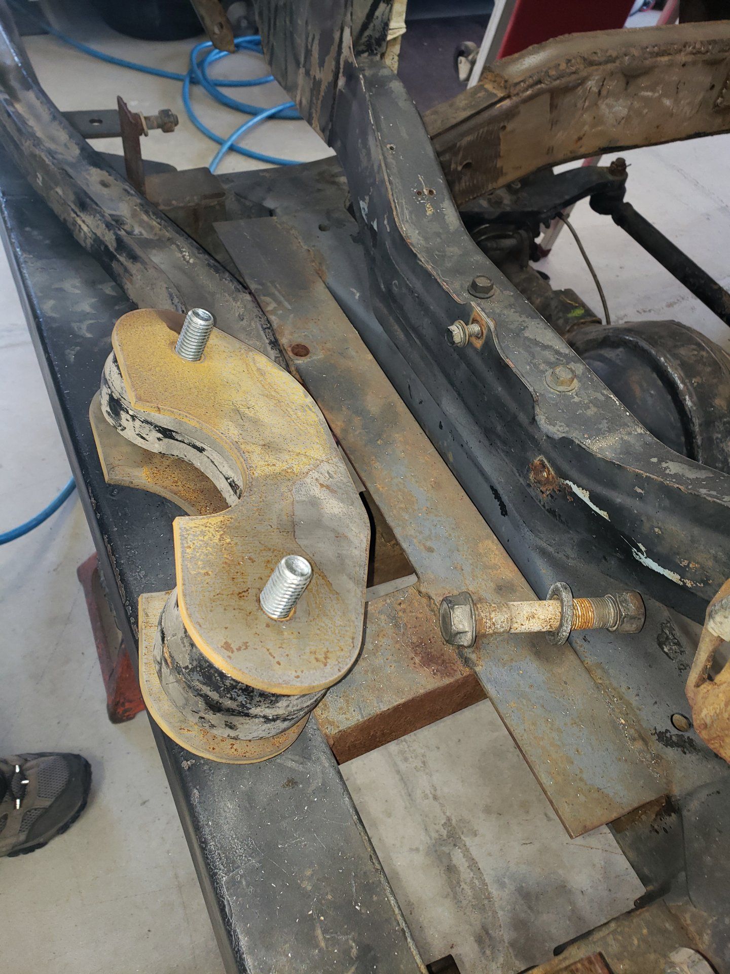

Thats not actually the body mount, its part of the frame! The body mount sits on top of that piece! I build like you were going to but bridge that entire gap on that frame bracket! And weld in triangular pieces on the outside corners on top of that same bracket 😉👍my 20

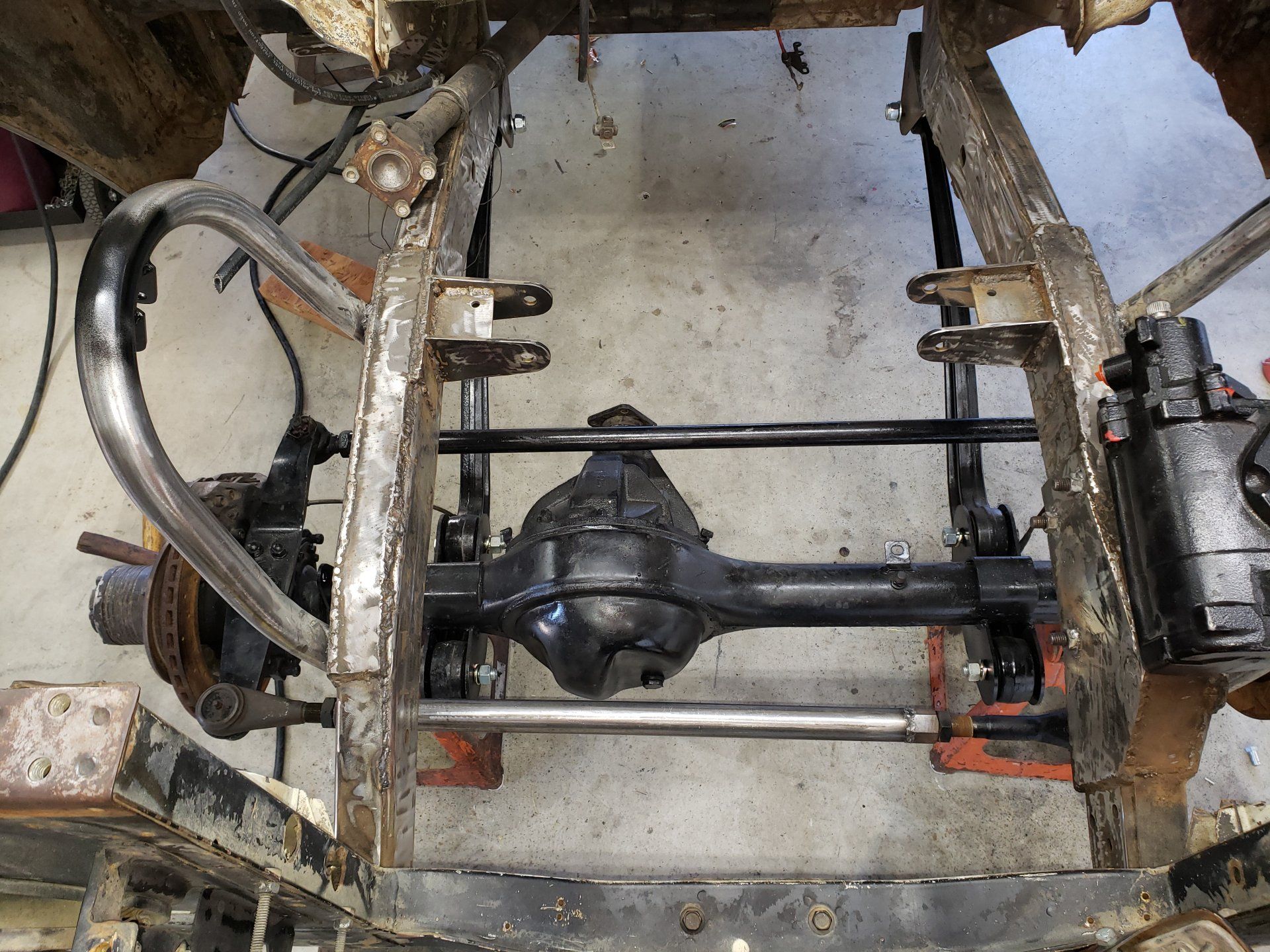

I took the last 2 days off to work on the Pig. Made some good progress. Engine is done save for the intake and a couple of accessories. Finally got the u-joint for the PS box. Took advice from the interwebs and got the wrong one.
Got the new drag link made and the bugs welded and installed.
You will notice there are shock towers in the above pic. We got them all bent up and welded on. The shock mounts are welded. We would have been able to have it stand on its own but we only had some temporary bolts for mocking.
Are you thinking about triangulating those hoops and gusseting those tabs? You’re referring to them as shock mounts, but they are the spring mounts also, with the entire weight of the front half of the vehicle dependent on those hoops to hold together and not distort throughout a dynamic range of motion at high speeds on highways and dirt roads.
Yes, I am going to add some side steel. There is a gusset on the front driver because that is all I can do at that point. I am going to put 2 diagonal bars on the passenger and 1 on the driver. I had been worried about strength but I was at a fabricator shop over the weekend and they had a blazer and they were relying quite a bit on the main mount points. I had been toying with the idea of a brace that goes over the motor. Not sure yet.
