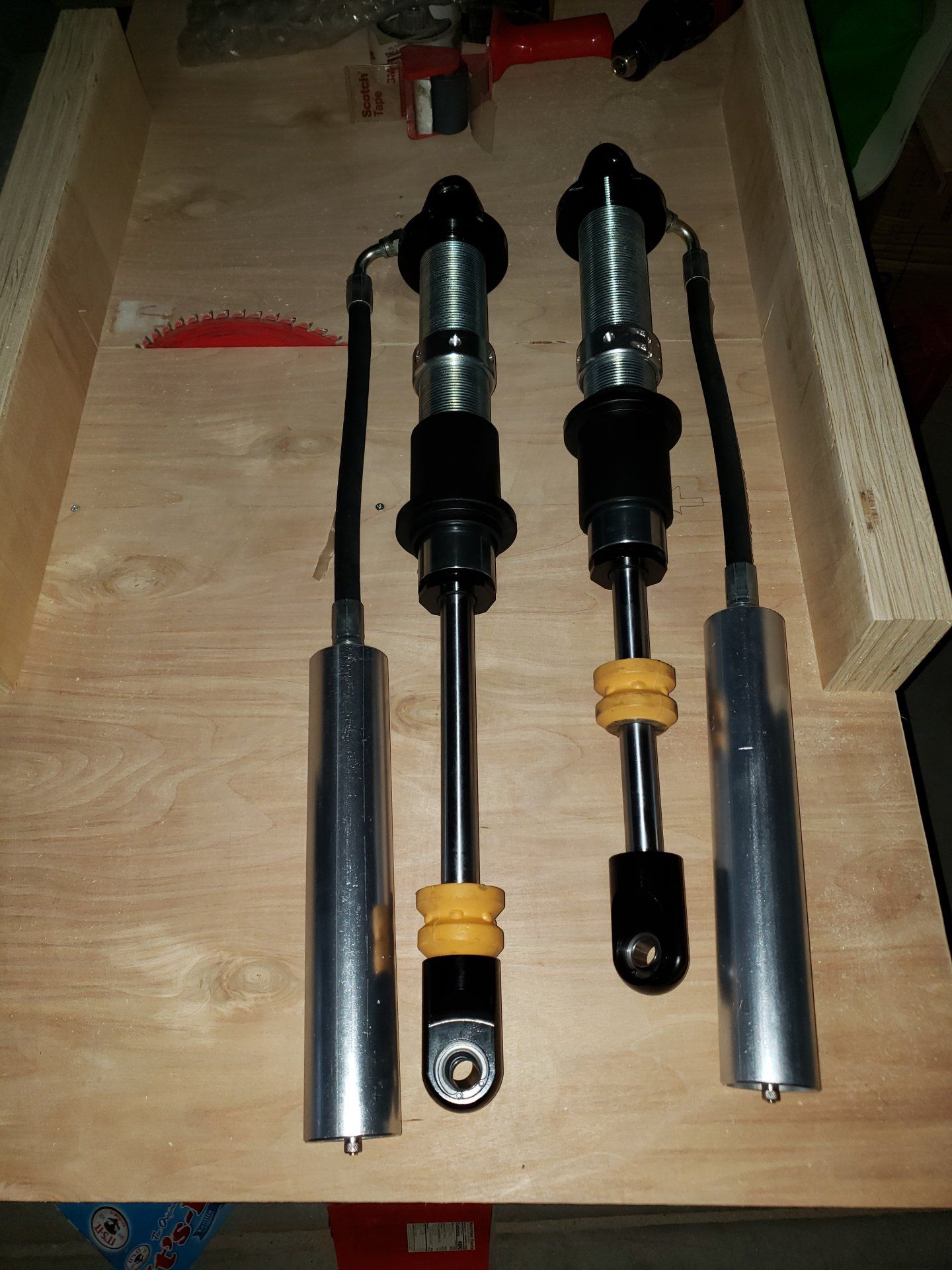

Didnt get anything done over the weekend. I was doing some armchair inganeering for my shock towers and realize I am cramming 10lbs of ....in a 5lb bag. So I pulled the trigger and ordered my coilovers today. This will help me get the towers perfect... er, perfectish.
The shocks came. Still waiting for the springs. Been doing some odds and ends on the frame and few other nothing burgers. Ordering all the motor items tomorrow. New timing chain, water pump, oil pan, PS pump and reservoir.

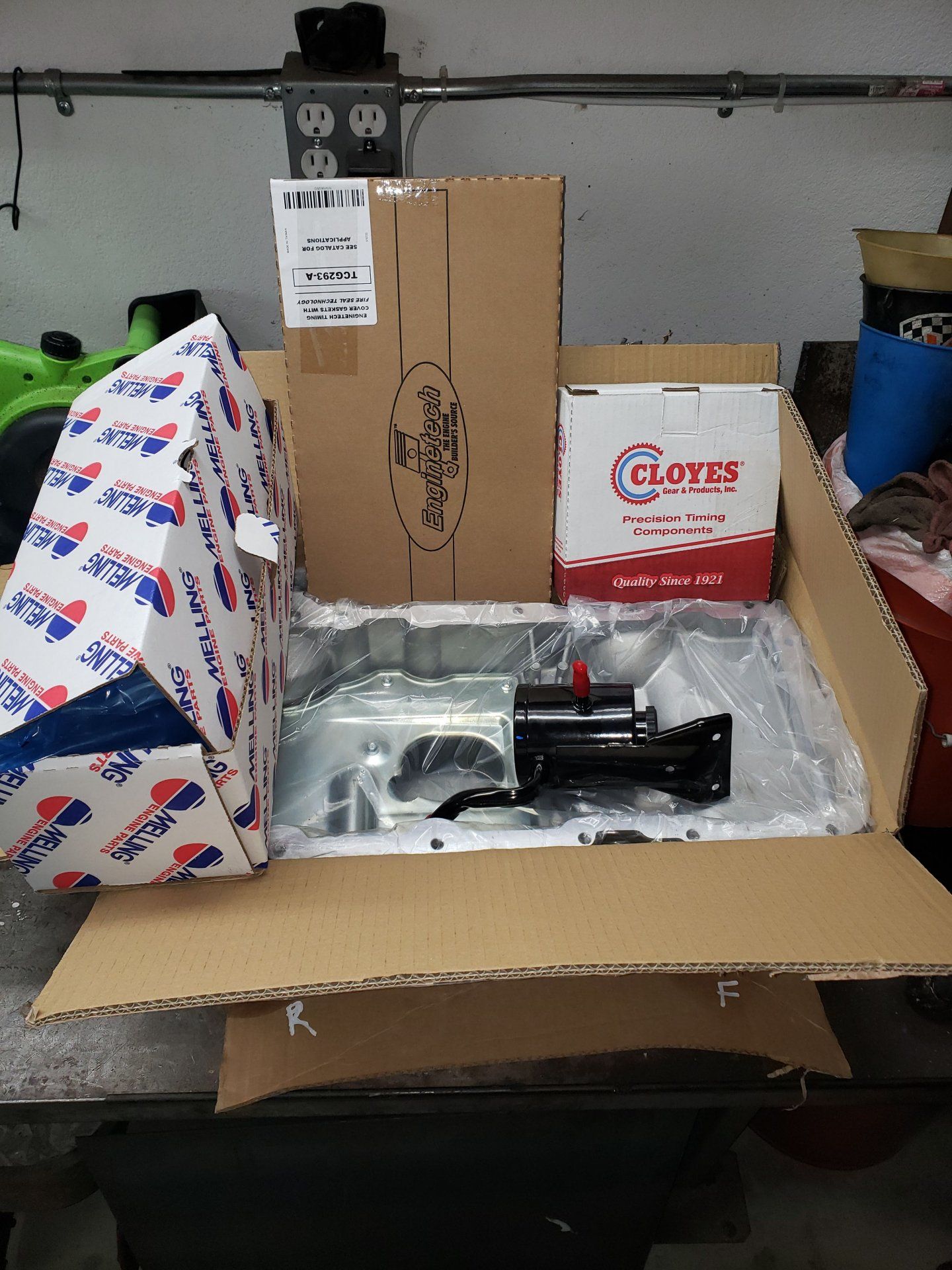

Got a little pile of goodies streaming in from Rockauto.

Here are the shocks with springs. Black of course. I haven't put the retainers on yet. I need the shocks pliable for the tower design.
Reservoir is steel and looks like its powder coated. I also got a Camaro oil pan and pickup, crank seals, water pump, thermostat, o2 sensors.
Opened the oil pan yesterday and decided to get an oil pump. The Vorteq windage tray doesn't fit the pan so I'm deciding to cut it or get a lower profile tray.
