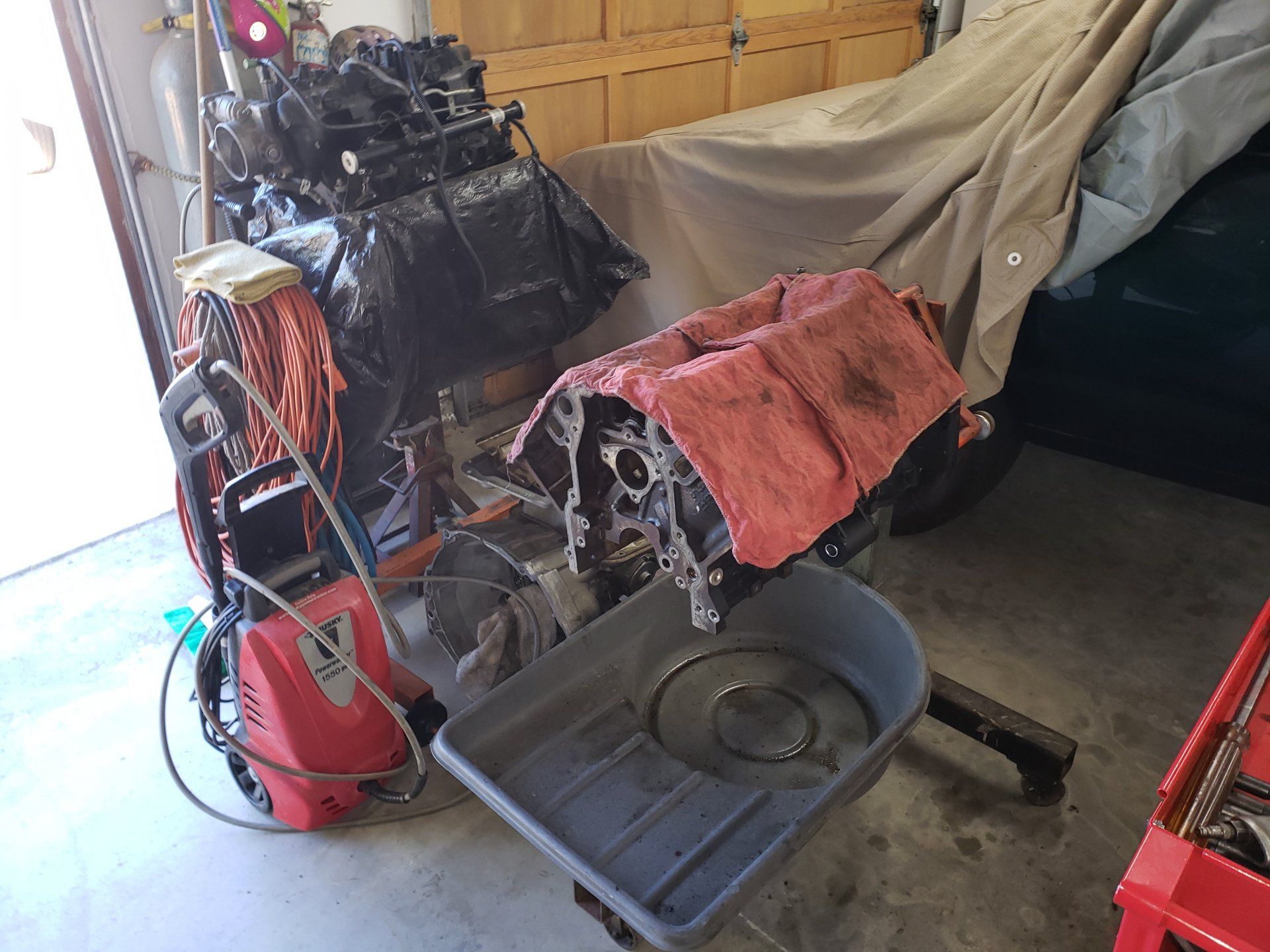

Got a little bit done yesterday. The rebuild kit showed up. The motor is completely stripped and used a few bottles of degreaser and wire brushed every nook and cranny(not the cylinders). Took the pressure washer to it after.
The passenger frame is all welded up so I am ready for the towers. Bought a dustless sand blaster attachment and want to hit the whole engine bay and frame. We are wheeling the pig outside to blast and I have to do it before we cut all the old suspension off.
