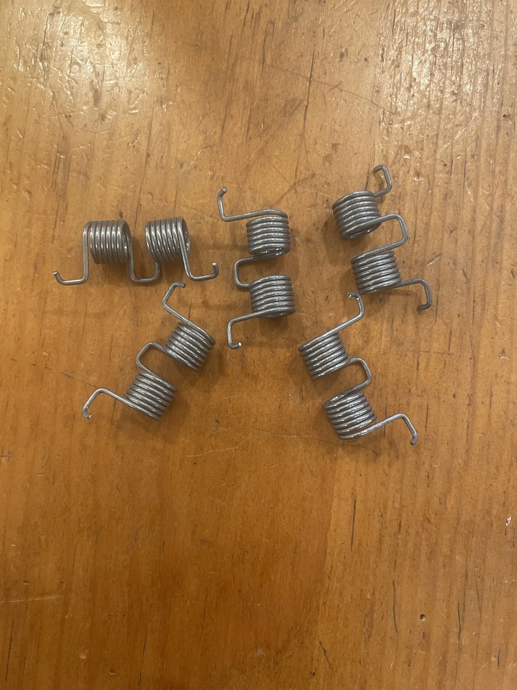

@DoubleNickels replacement door handle springs arrived! These things are beefy. My door handles will close on their own easily for the rest of my existence after I get them installed. Really appreciate you providing these to the pig community.
Did you get the plastic piece as well?
@PabloCruise i did not get the plastic piece. I used a spare I had but seeing as how brittle these things are…He said he would share the 3D print file with me. I need to figure out how to utilize such a thing locally. Although, I did see shapeways might be back in biz.
... and glad to just handle that for you as well, the ordering/procurement. I've a rolladex of vendors I trust. Just let me know how I can help!

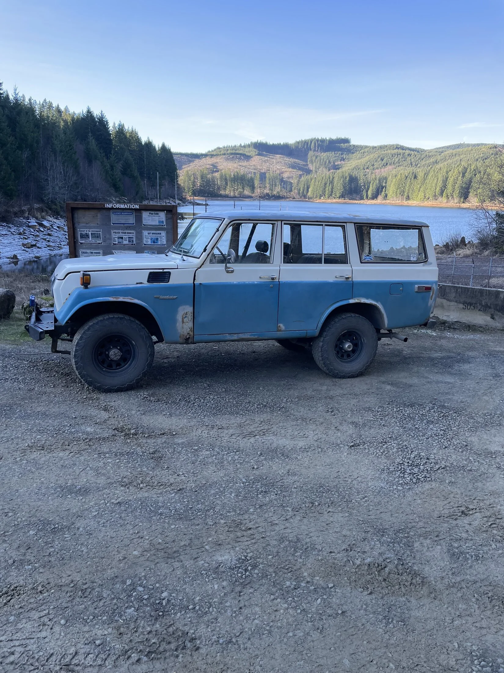

Funny you mention those shackles @RUSH55. I’m thinking they might go soon. Marge still drives like sh#+ after I had the box rebuilt by Mark and systematically replaced every steering component with OEM equipment from the tires all the way to the steering wheel. I get some scary road wander when I hit potholes etc. I also measured and adjusted for toe in using the TMR guides that I purchased after seeing warnog use them in one of his threads. Great product and super easy to use.
The only thing I haven't done is shackles and associated rubber, shocks, and/or looked into shims to put under the springs to correct driveline angle which I have read can be an huge help in correcting steering wander. Maybe if I knock those 3 things out it’ll make all the difference 🤷🏼‍♂️
I’m already 2 summers behind dialing Marge in for reliable summer fun so the push is on!
