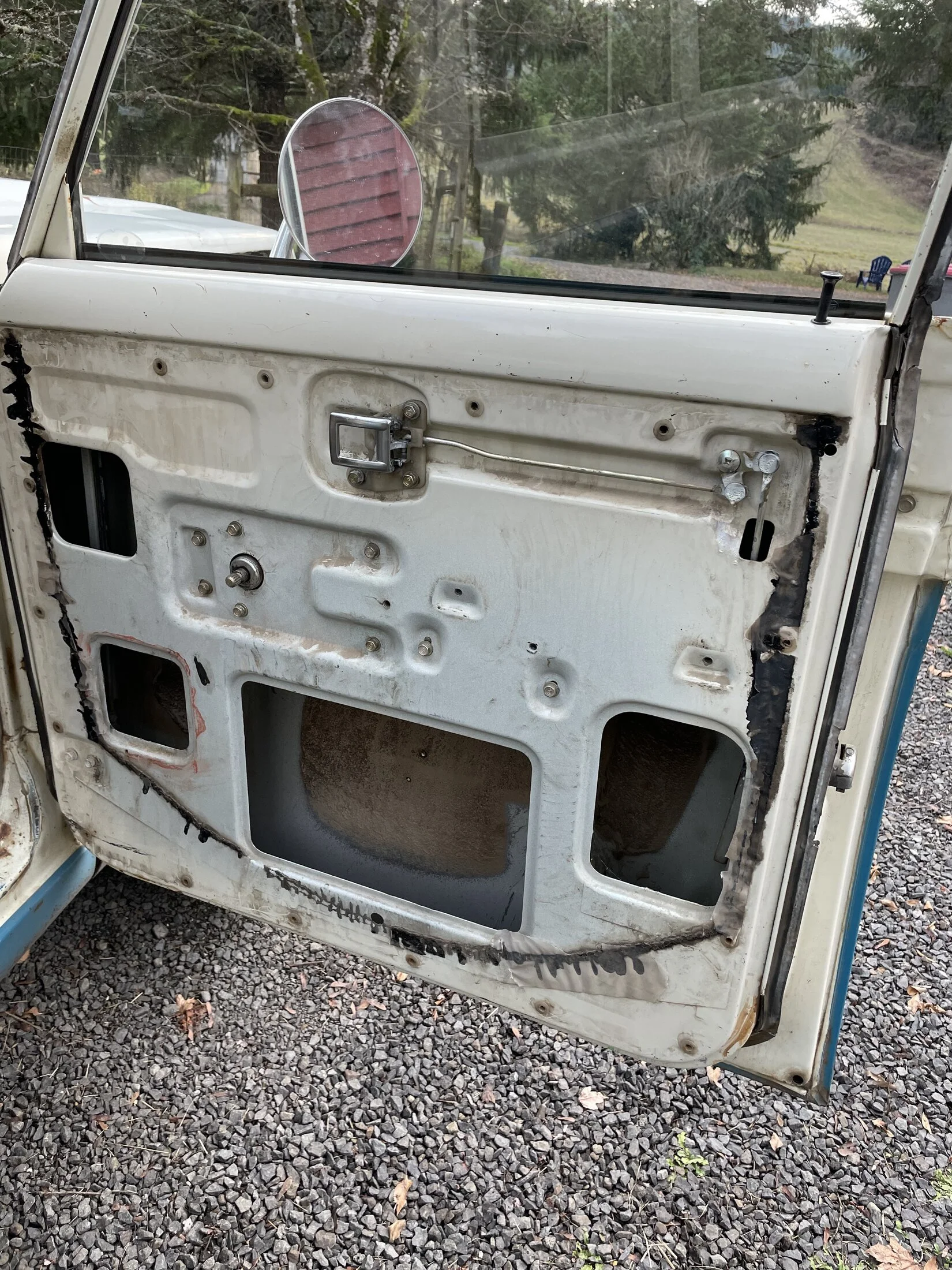

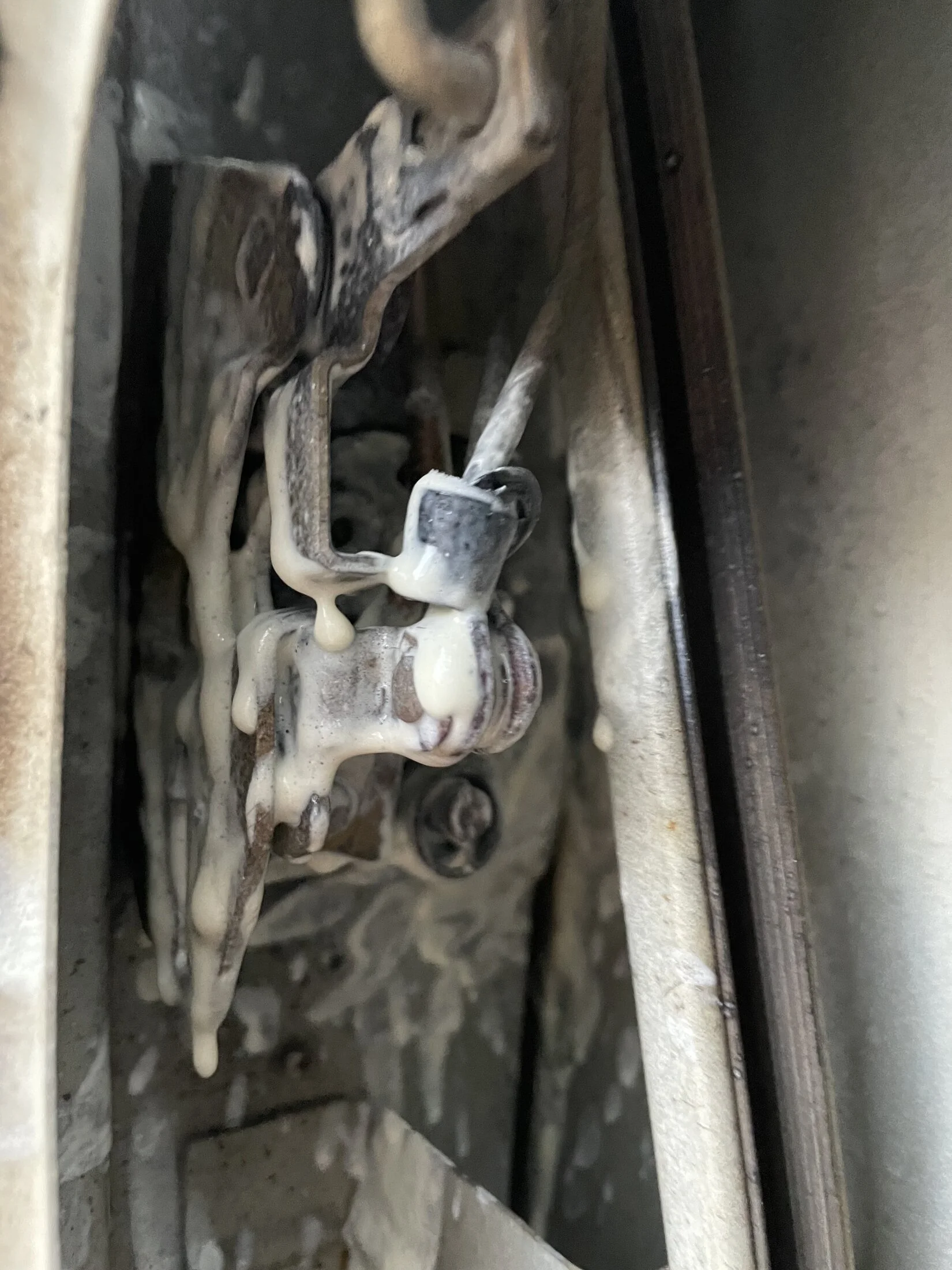

Marge got some white lithium love today. I was tired of all the door handles sticking when we got in and out so I had one of my boy actuate the handle while I blasted everything with white lithium grease. I gave all the mechanisms a healthy coat.

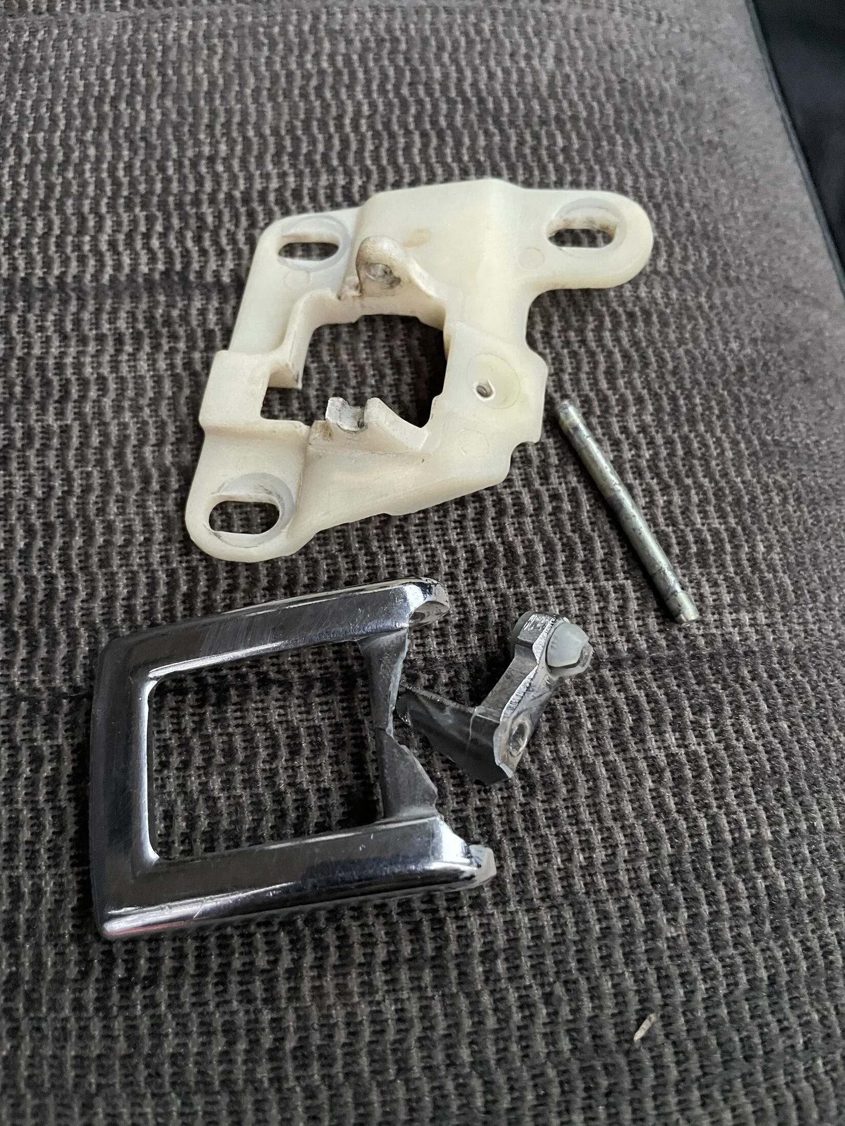

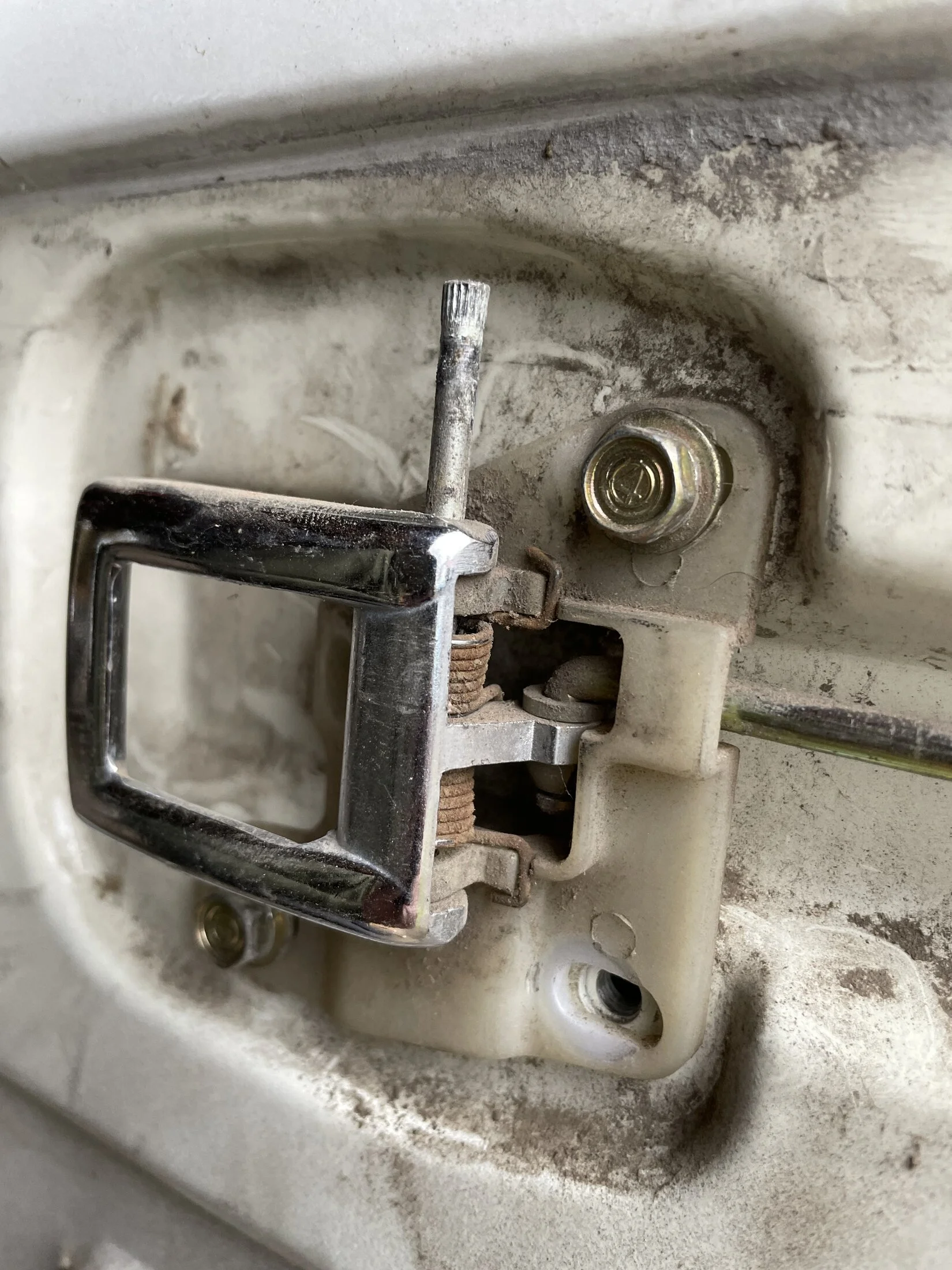

The passenger side front interior handle has been broken since Marge came home with me. Swapped it out with one of my donor door handles. Unfortunately broke the plastic thingy that screw into the door trying to put the pin back in. Ended up using the donor doors plastic doohickey as well. I hate when stuff like that breaks! I could probably knock this job out in 15 minutes now but figuring it out first time was a PAIN!
Also, is anyone making repop springs or has found replacements for the interior handles? I feel like I bought some maybe at one point but can’t find them. My springs are very tired.
