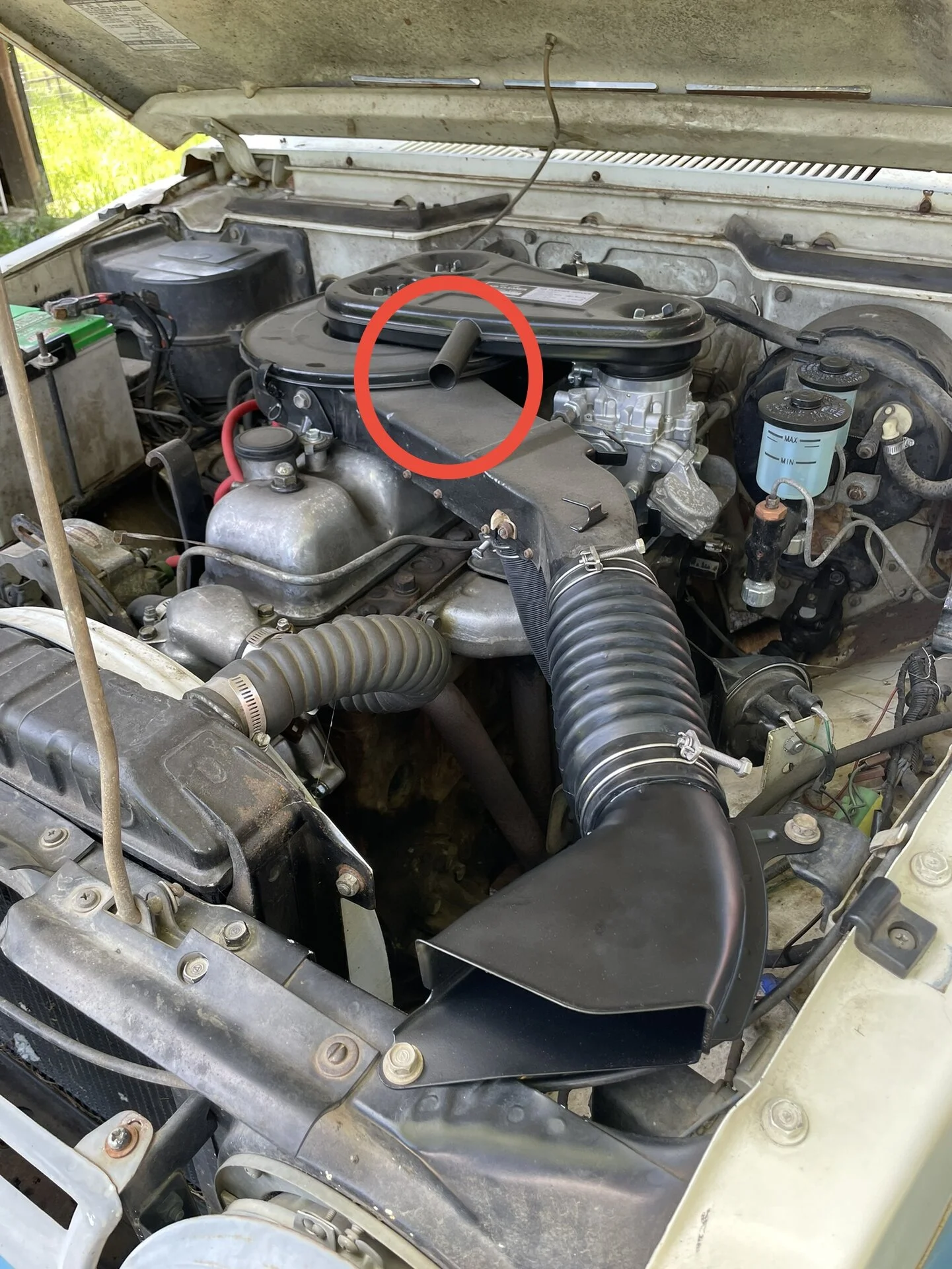

Question. Should I have this capped off? This has probably been answered ad nauseam but I’m being lazy and just asking instead of searching View attachment 3322773
Well it is a path for unfiltered air into your carb, so I vote "Yes!".
It was the path for your air pump to pull filtered air. It looks like you are no longer using the air pump, so no longer needed.

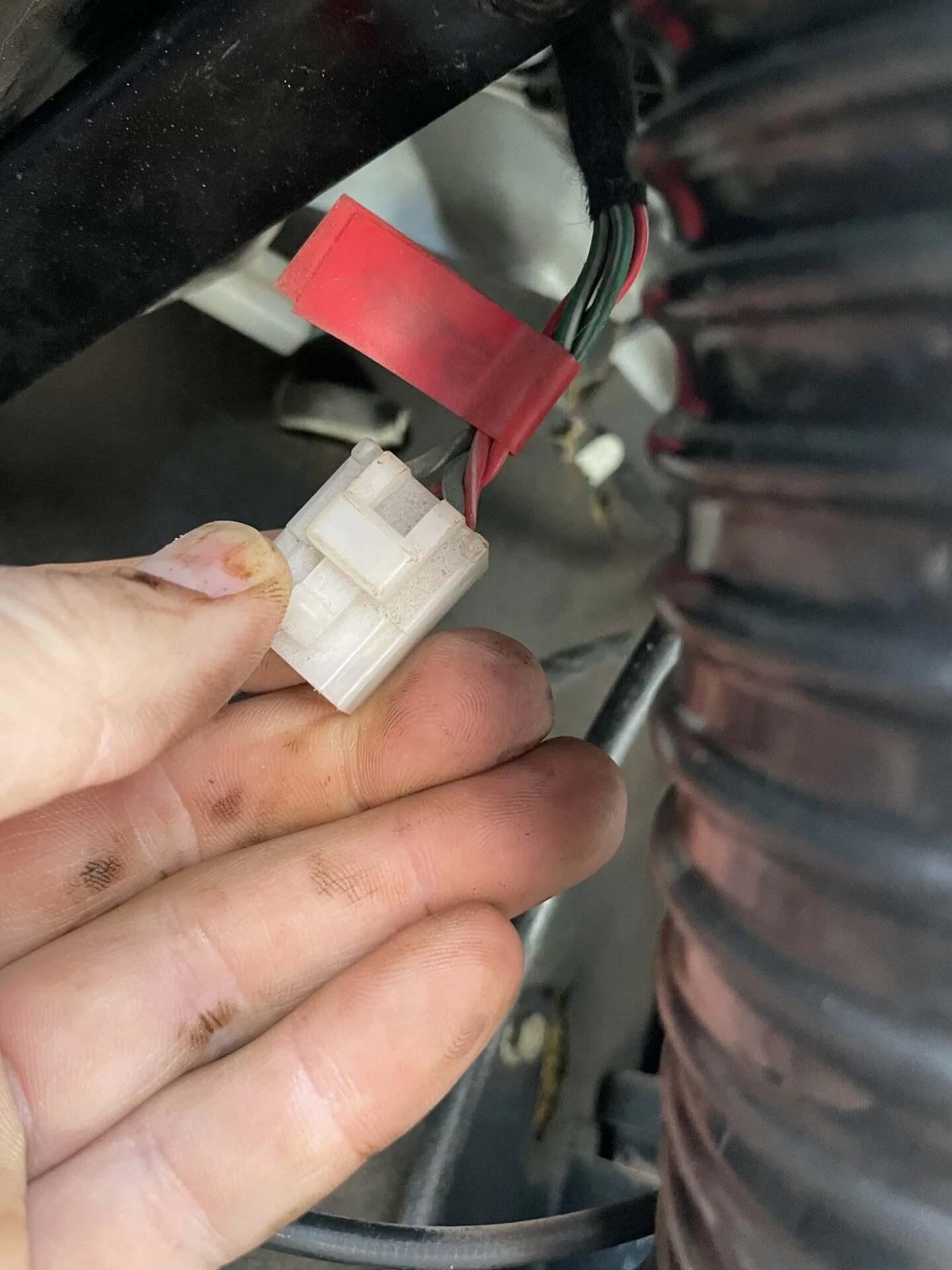

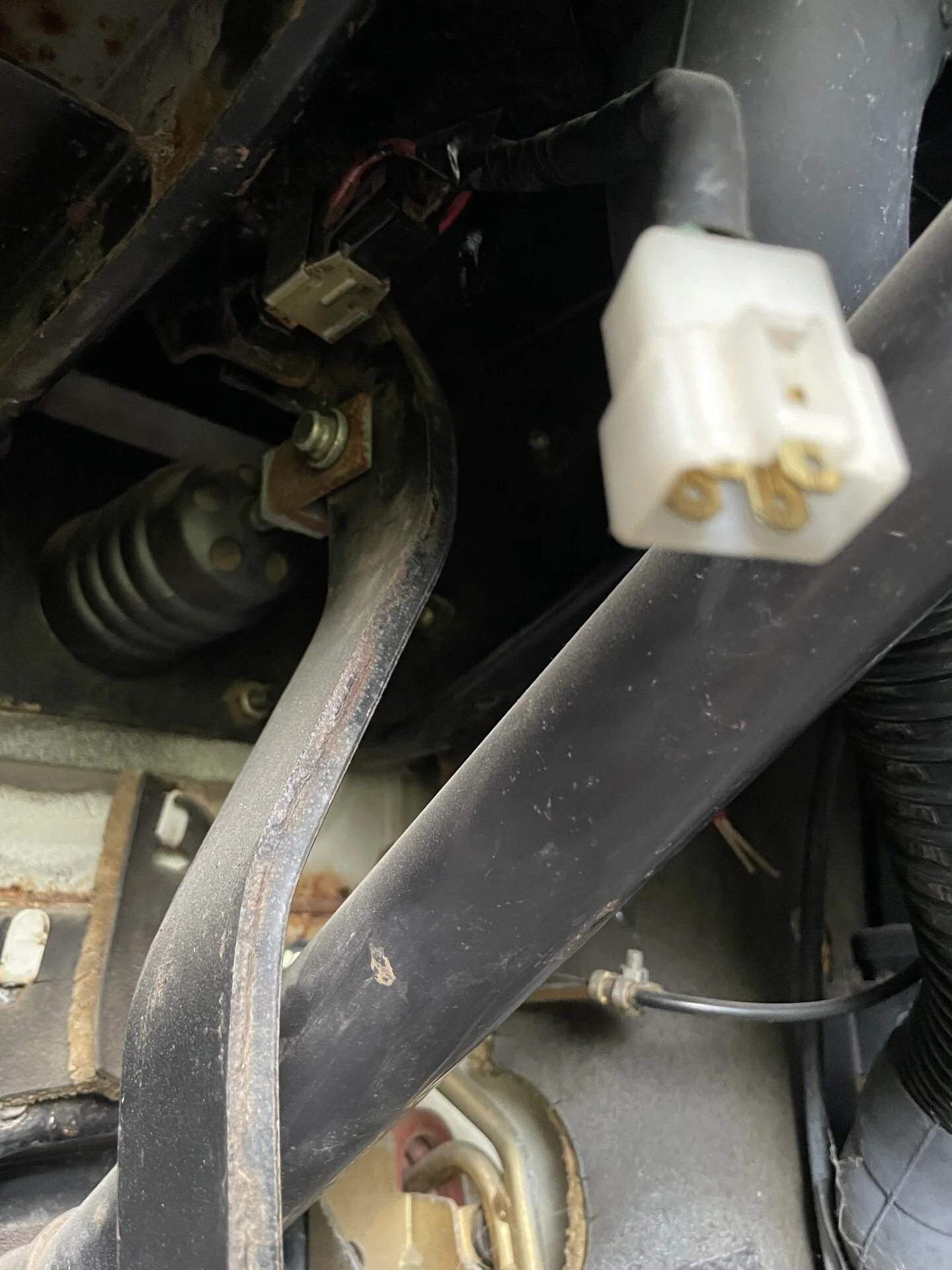

I think I figured out why Marge’s brake lights don’t work. I can’t believe I hadn’t noticed this before… should be fun to try and figure out what the PO did. He had what appeared dang near everything rewired behind the dash. No clue why they wouldn’t have worked this into the program. I’m assuming I’ll have to pull the instrument cluster to find where this is meant to plug into.

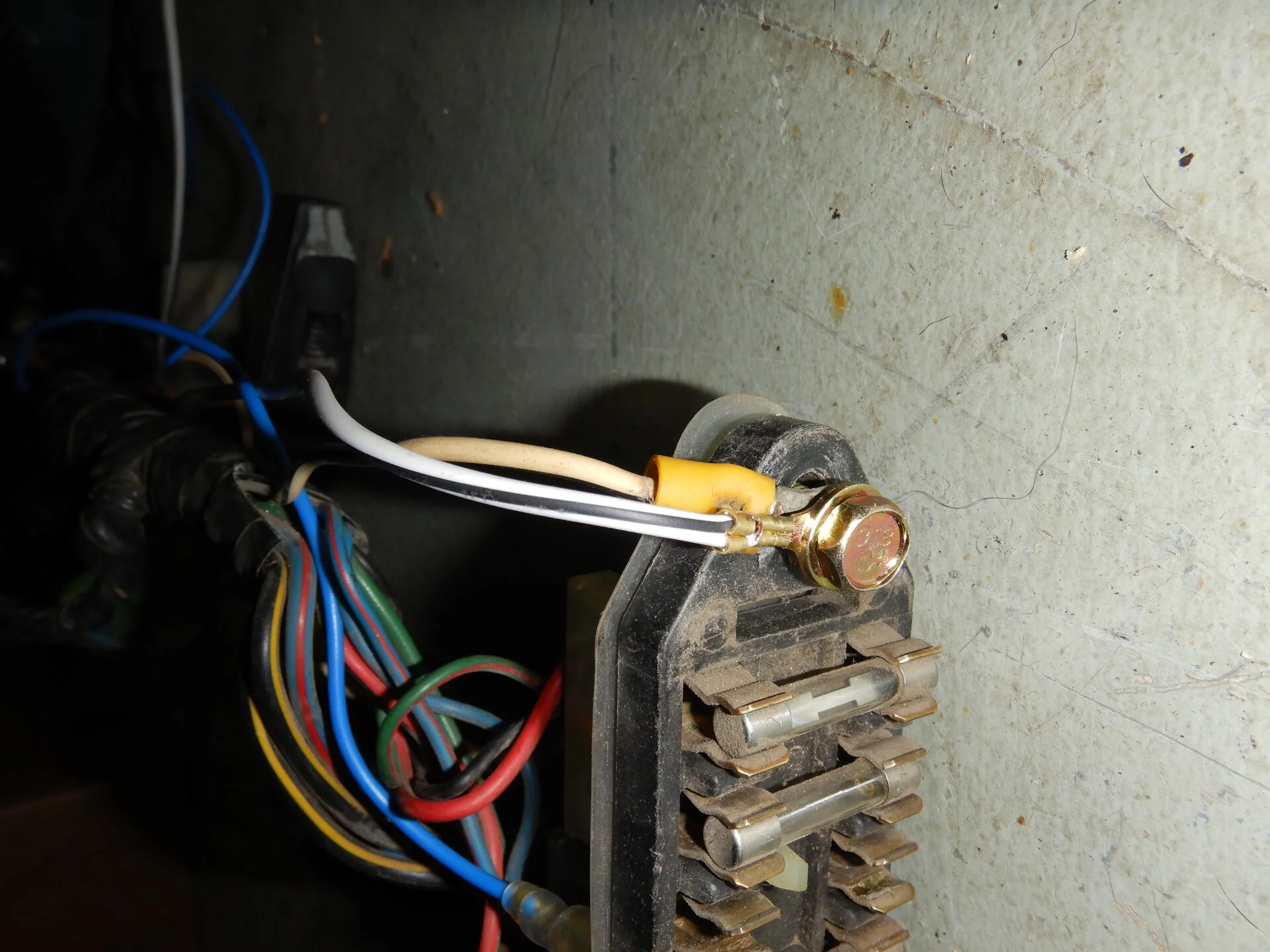

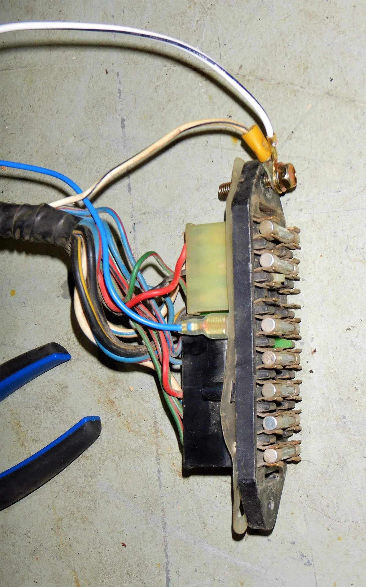

just remember the ACC and KEY ON and BAT + on 3 taps of the back side if the just panel
the TOP1 0mm hex / 6, is the NEG - GROUND for everything !
eazy peezy

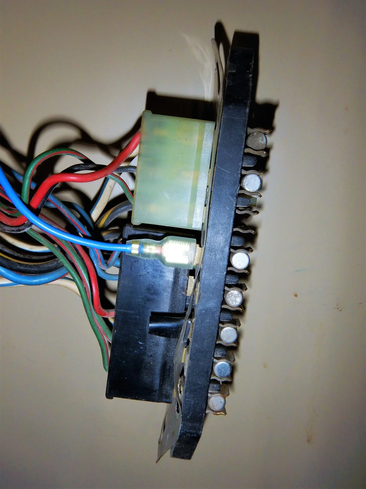

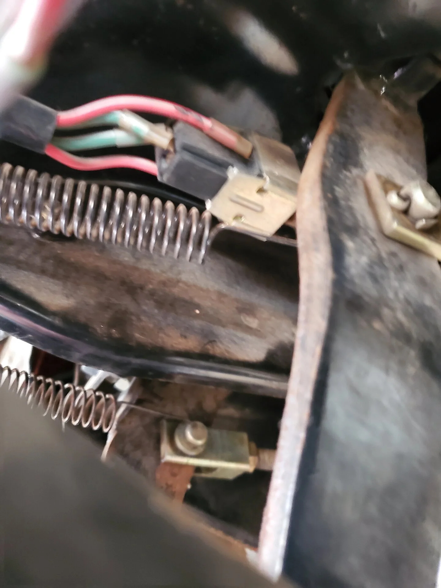

Does the loose plug in my picture from the break light switch plug into the fuse block? That’s what I’m kinda gathering from Matt’s post. Shined a light up there and felt around. Doesn’t seem like anything is missing? 🤷🏼‍♂️
Any good pictures from the sty as to what I’m looking for? Zero issues pulling instrument cluster and looking around if that’s what it’ll take. Like I said the wiring is not original so who knows.
Thanks @RUSH55 i got a better idea where to look when I crack Marge open again.

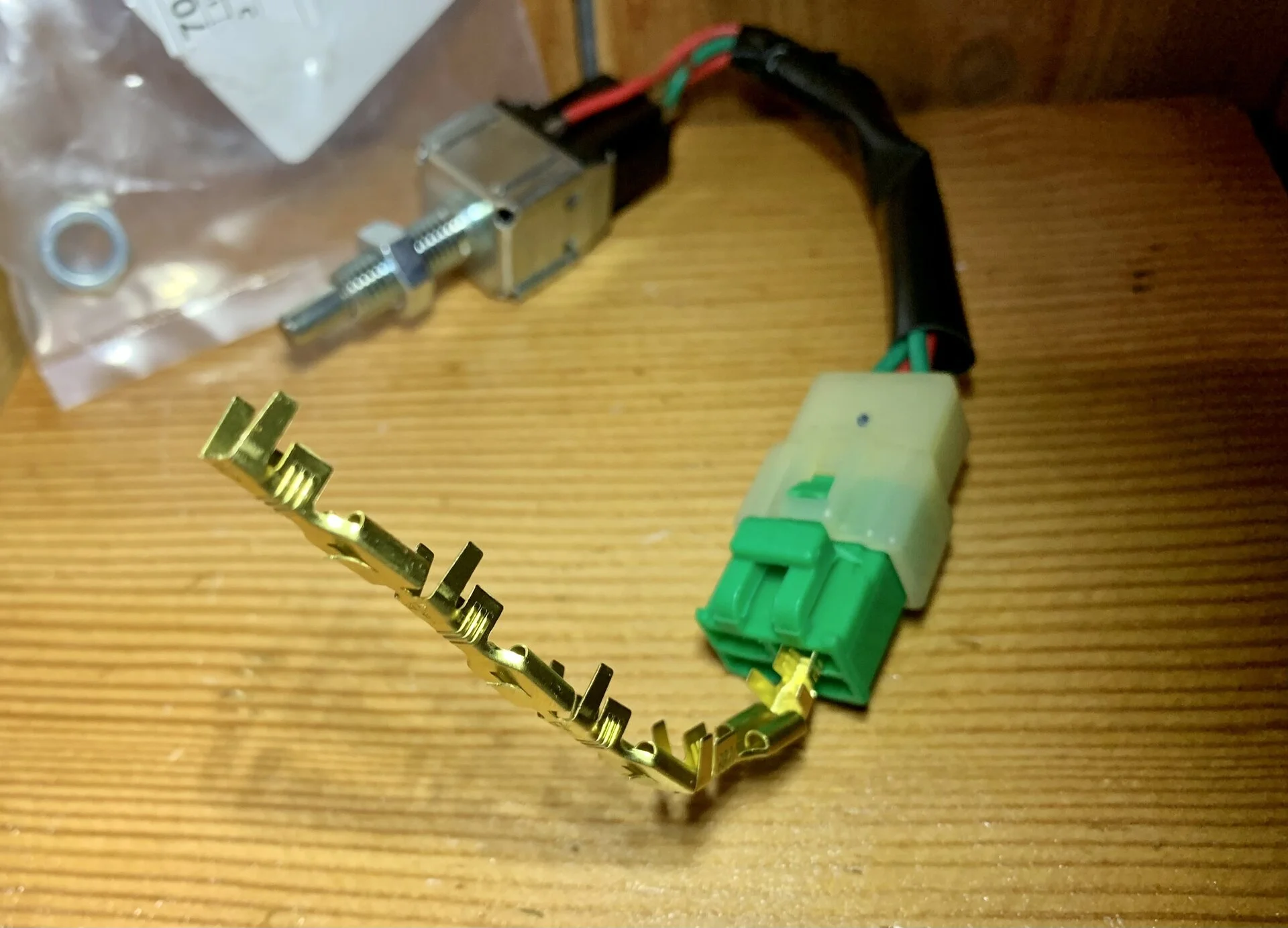

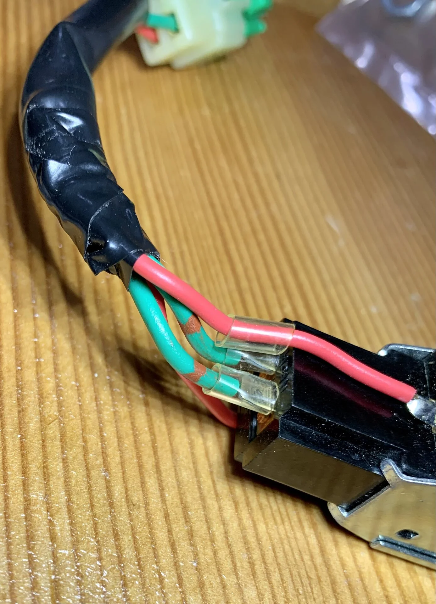

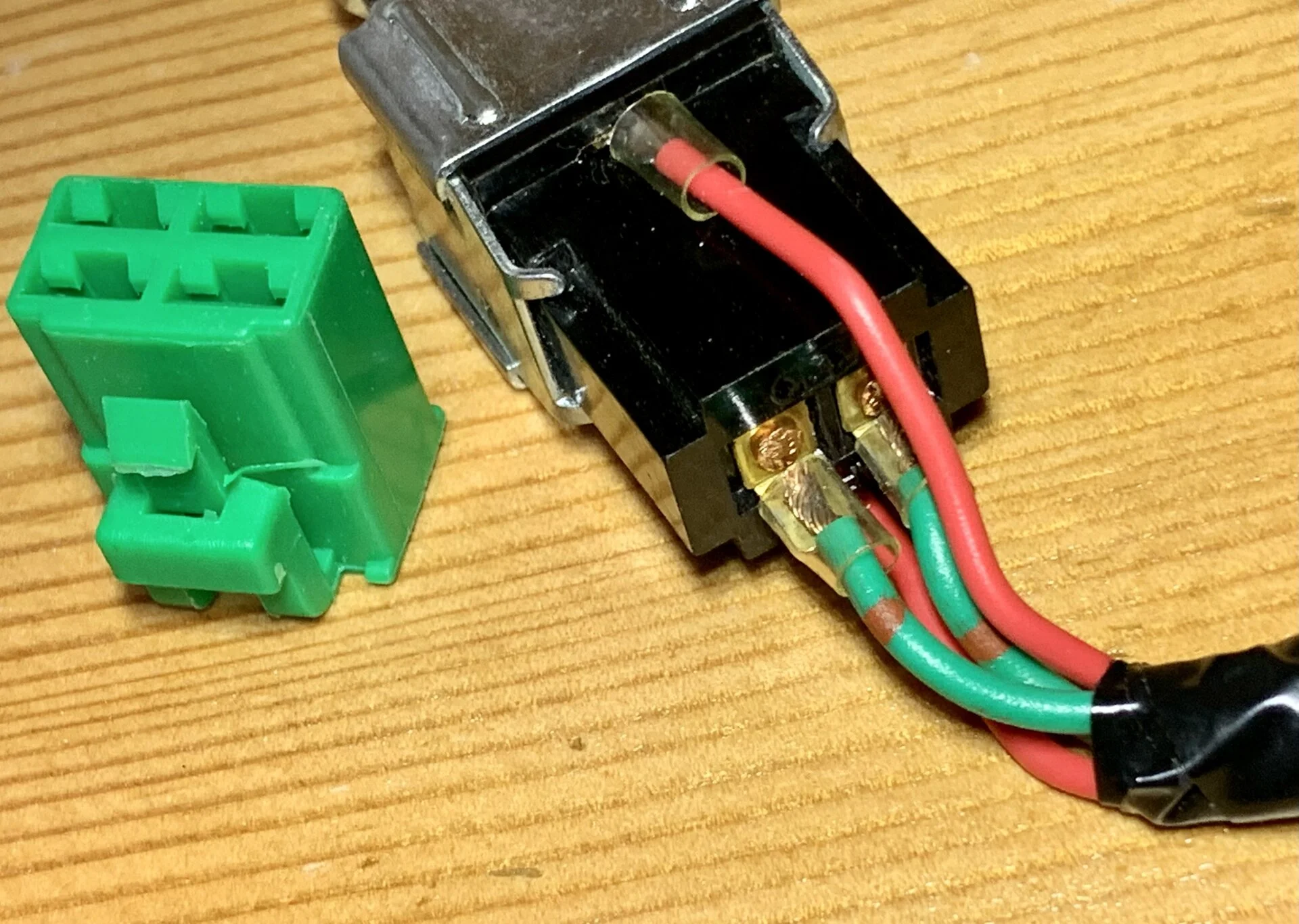

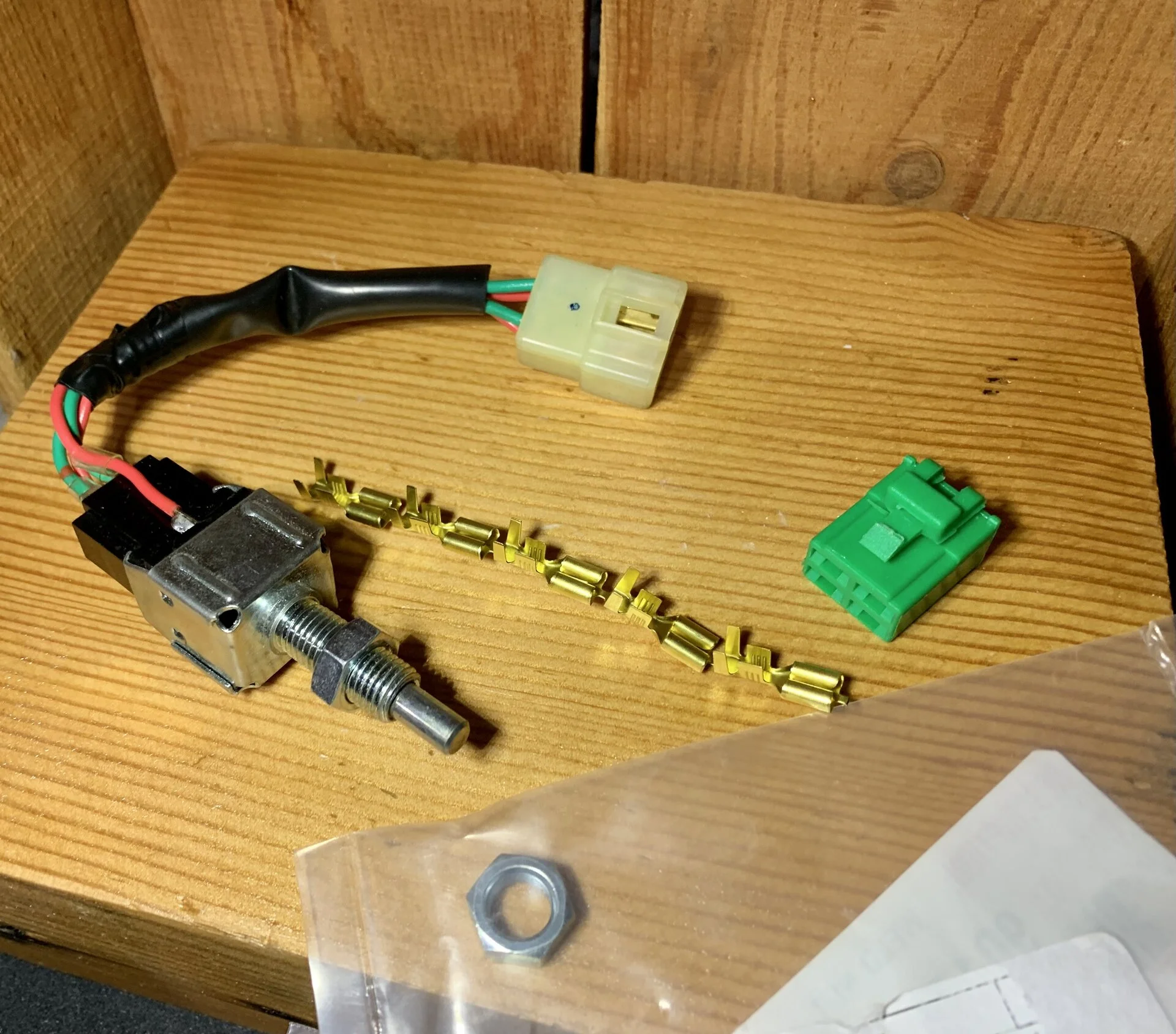

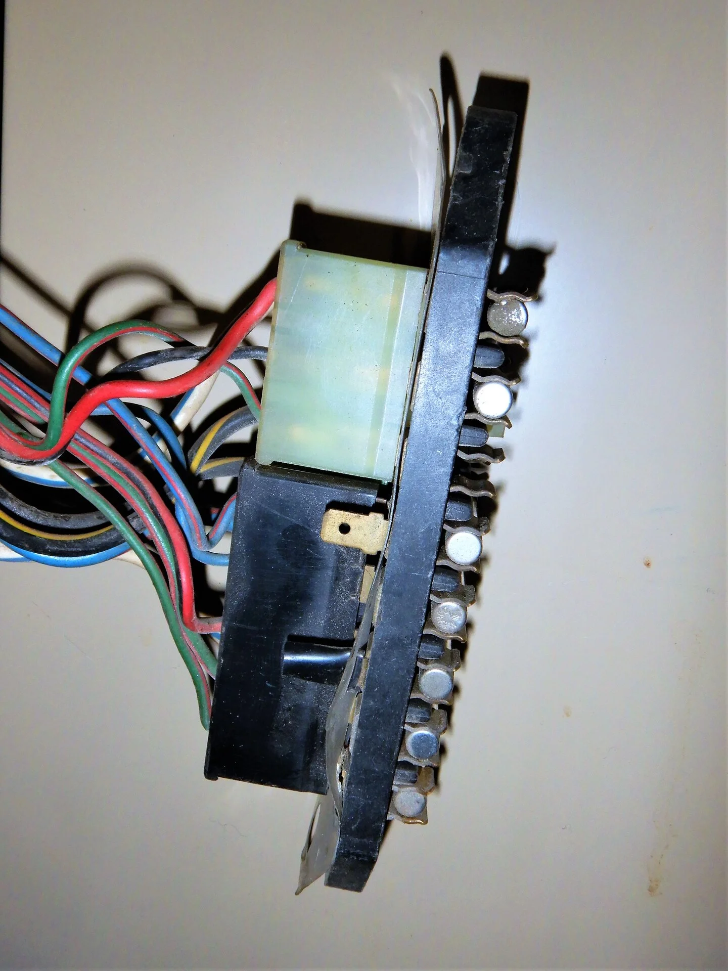

You have a few things going on here at once :
- note the OEM toyota japan 🇯🇵 spec update switch below
- the Maroon paint dashes , thicker gauge wires , copper rivets etc
- the OEM Cushons
x2 also are key here !!!
Now :
You MUST replace both the harness side Female and it’s old terminals at the same exact time to skin this CAT
If you don’t ? , your setting your self up for failure from the get Go
both cushions too , a bad or missing one contributed to this , for sure
If you do this as I outline Above , your set up for success the moment you make that last crimp , plug and play …
PM me your shipping info , I’ll Gitte up pony express this kit and the needed lock down nut out 1st thing ..
Marge deserves only the best here …
You and I both know this …:cool:
Matt
Well I pulled Marge out today and spoke sweet nothings in her ear for a bit before I jumped under her dash. Disconnected the battery and pulled the gauge cluster out. Dug around for quite a bit before I found the correct connection for the brake lights. It was buried deep in that rats nest back there. I was pretty sure it was the correct connector and my assumption was confirmed when I cut of the electrical tape marker on it and noticed it was labeled “STOP” 😂😂.
Someone must have forgotten to simply plug it back in after they rewired everything OR due to the brake light switch only working intermittently the left in unplugged and never got around to replacing the brake light switch. Had one of my boys push the pedal while I was checking out the brake lights and they work 85% of the time the pedal is pressed. I know this could be a grounding issue as well. If I have time today I’m gonna pull the light housings and clean them up to hopefully get better contact then try everything again. If that doesn’t clear it up 100% then we’ll go with a new brake light switch. Appreciate everyone’s help pointing me in the right direction in terms of locating the plug.

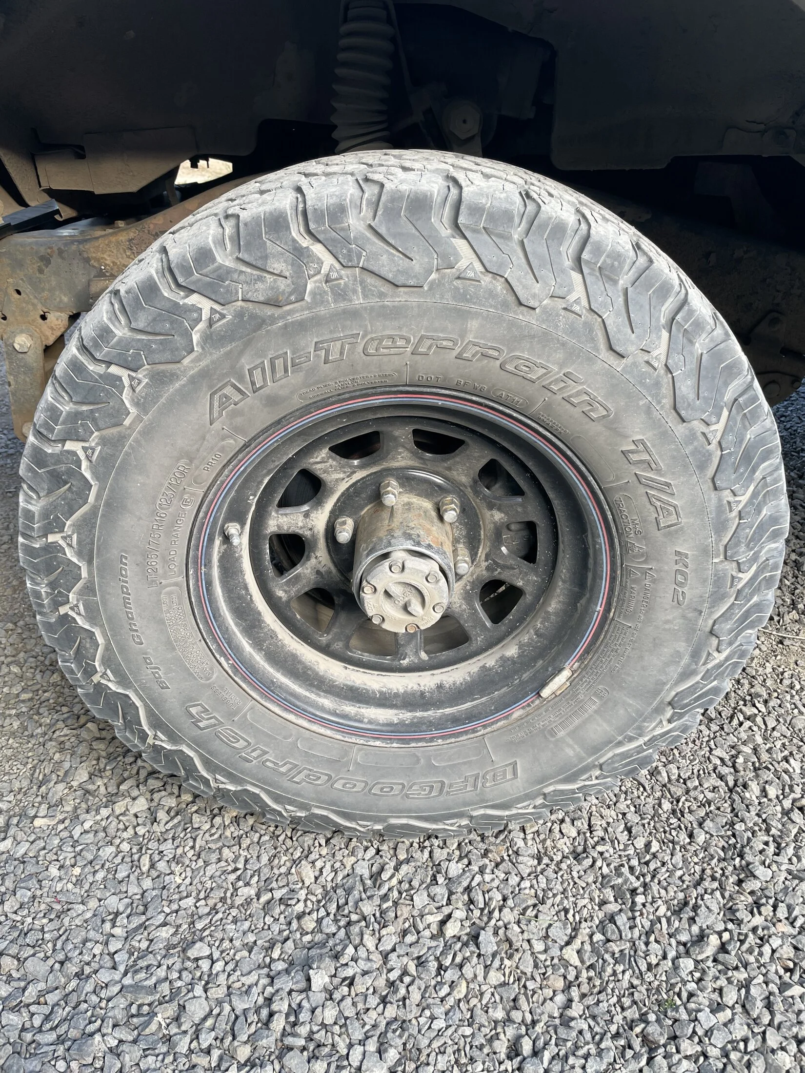

Ok this isn’t really contributing to the build but it sure as heck contributed to drivability and I need some feed back.
I’m running 265/75R16 KO2’s on Marge. Picture attached. As the thread states I have dang near gone through all steering components other than shackles and shocks. I’m happy with the steering as it stands, could maybe be a bit better but not much. Just for S’s and G’s I upped the front tire pressure from 30psi to 40psi today and it felt like I gained power steering. I know I know a DUH moment for sure.
Is 40psi too much to run these tires at? It says they can go up to 80psi on the sidewall but that seem ridiculous to me. How would I even know if 40psi is too much? A lotta shakes and rattles seemed to dissipate as well at the increased psi.
Any and all conversation welcome. Not that I’d expect anything else from the sty…
