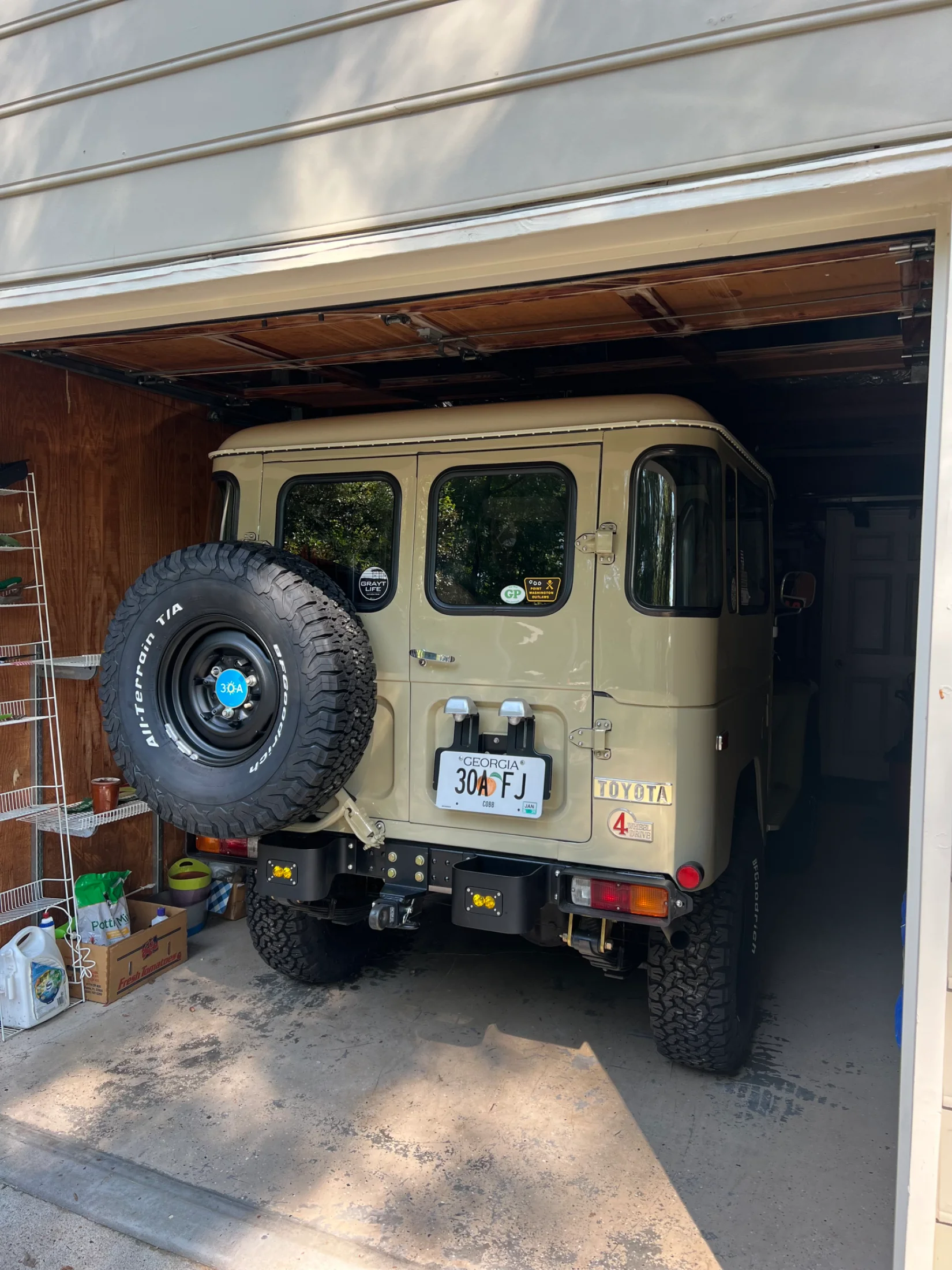

Have an 81 so has the different triangular tire carrier on back. Curious to max weight that people have seen in the past. Right now, I have a BFG-TA 33x10.5-15 on stock steelie (75.5 lbs maybe?) and has been fine.
Looking to add a rotopax and strap mount and may be another 30lbs max.
How hard do you push the rig off road? If you are a low and slow guy, it will likely be fine. Weight up close to the rig is easier to carry - those gas cans move the weight away from the rig. I'd look at the hinges and the mounting backing plate inside the cab every so often to look for cracking/metal fatigue
Hey Charlie, will not be doing any heavy off-roading…maybe light trails a couple times a year. Interested in what others say.
Interesting they don't show the backing/stiffer part inside the cab.
Static load of just hanging there is one thing. Taking the shot from a 2 foot drop at speed is another.
Moving the center of gravity out away from the hinges likely has as much effect as increasing the weight.
