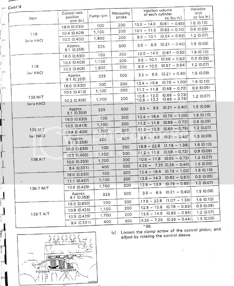

First big question, what can the injection pumps put out for cc/1000 shots?
not sure I am a IT geek not a diesel makanik :(
I will investigate and see what I come up with. is there a formulae I can use based upon fore the specs of the injectors? Or do I need to do an actual test?
You really need a bench test of the injection pump.
I figured so and the cost of removing the pump and flying it over the ocean for a few hours is not worth the cost as its only ever going back to the shop who set it up not a local shop :(
So at 14.3cc/cyl for 200 strokes, you are at 71.5cc/cylinder for 1000.
You can see there is big potential in the pump. They look identical to the 12HT pump with 2 less cyl.
Not big in the fuel department in stock settings, but neither should it be given the stock power.
looks like if full 21mm of rack used (assuming same as 12HT), you might be able to get around 150cc or even more......
