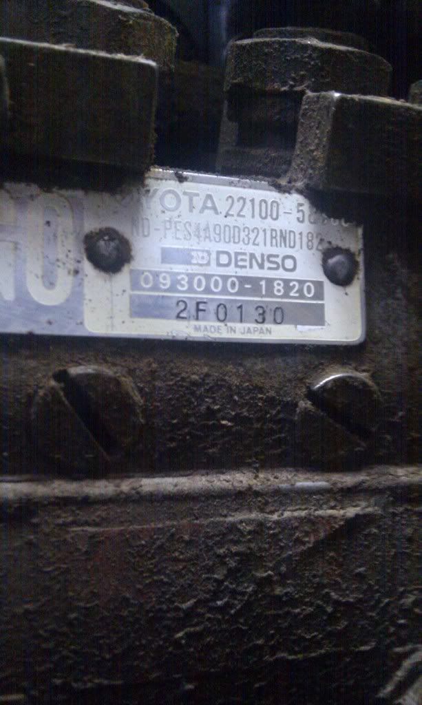

Have you posted up the numbers on your fuel pump? The tag includes a code for the size of the plungers.
I think from rough calcs posted earlier that you've got maybe 113cc of fuel per thousand shots. This is based of airflow and the safe EGT's you've got at the moment. At a guess you'd have around 8mm plungers. Isuzu do A pumps with 10mm plungers capable of around 200cc of fuel per thousand shots.
Yep, aluminium tag on the side with a long code on it. I just edited my post above too.
The A90 means you have 9.0mm elements. They should be good for around 140cc/1000 of diesel.
Another Isuzu owner with 9.5mm elements has bench tested his pump at 180cc/1000 shots max.
I have 10mm elements and not enough air to get anywhere near max fuel. I still haven't fitted an intercooler.
