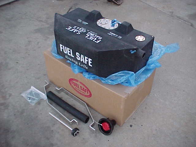

22 gallon capacity... measures 30 inches wide, 18 inches depth (to back), 12.5 inches tall; has a sloping rear area so back doesn't hang down...
markh11
Mechanically challenged
SILVER Star
Aug 26, 2009
117
Leonard, TX
And some other pictures so you can see the angle and bottom...

Based on your pictures it would appear that Fuel Safe is no longer making these for Mark? Is your cell like a Fuel Safe with the internal bladder bag or is it a poly tank with baffles? Does it come with the top plate and all the hardware shown in the picture with the Fuel Safe cell?
It is one and the same... comes with all the hardware... including fuel sensor (matching the stock sensor in the front tank, so I can use an electric switch and valve, and the stock gauge in the dash will reflect the tank in use...
