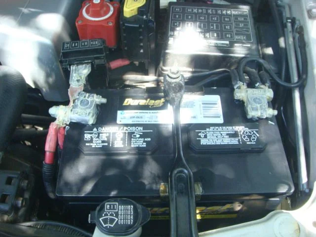

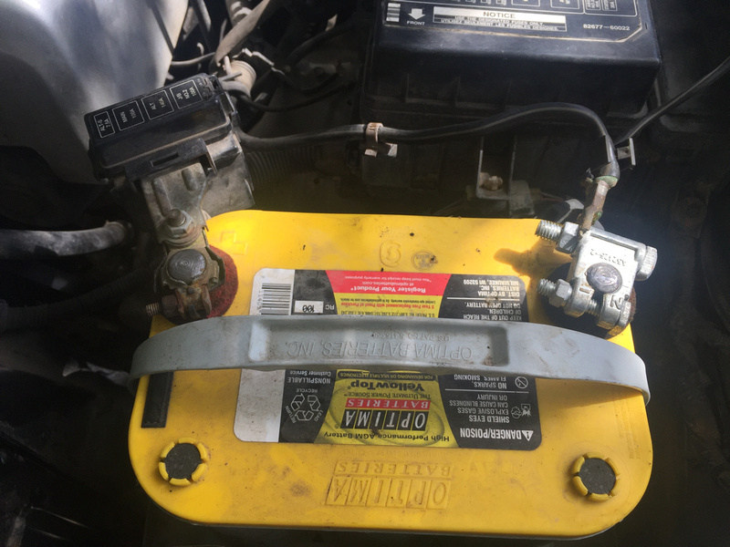

One way is to just take a piece of copper bar, drill a hole in each end, then twist it 90 deg. in a vice. That's all I did.
Like so......

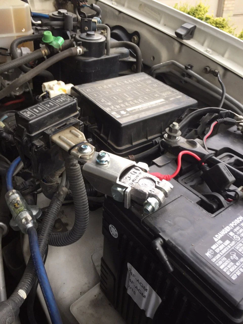

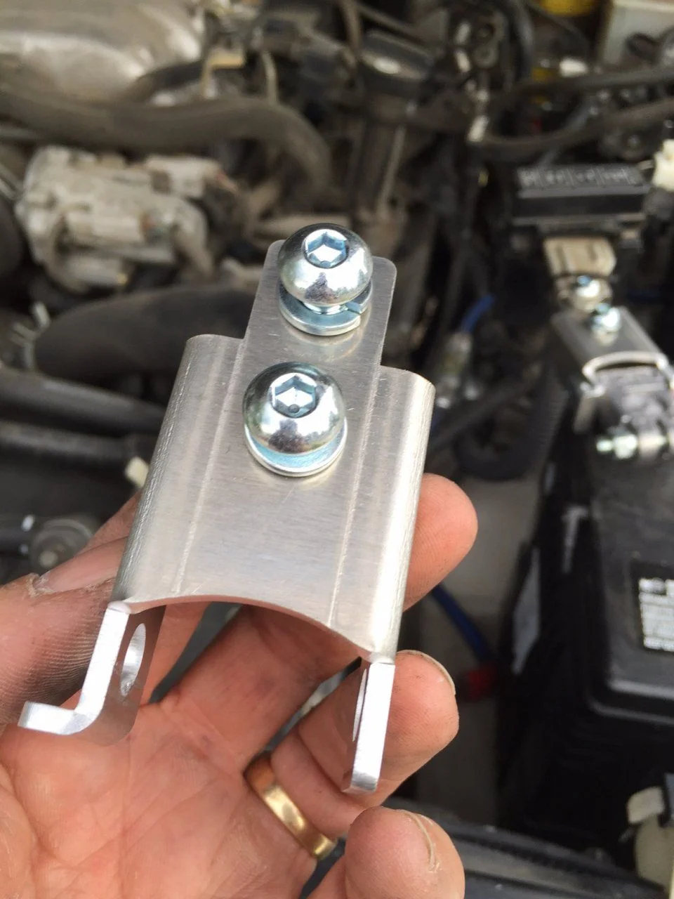

Another option is get one of these terminal extensions and a military terminal from our good friends at Slee Offroad. The copper bar trick looks like a great idea too, but for less than $20 this was an easier option for me. It probably makes more sense for me since I can just drive over to Slee and get stuff when I need to. It only shows up on Slee's website as part of the group 31 battery tray, but they will sell it separately.
View attachment 1304662 View attachment 1304663
What is the cost of that part, <$20?
How much addition length does it provide? Enough to use the more popular opposite post battery?
Like so......
That's also what I did... I think it cost about $4 for the copper...
Price for the extension was right around $10, by the time you add the military style terminal it gets up the the $18-$20. As far as the opposite post battery, it doesn't provide much extra length, maybe 1". I don't think it would be enough
