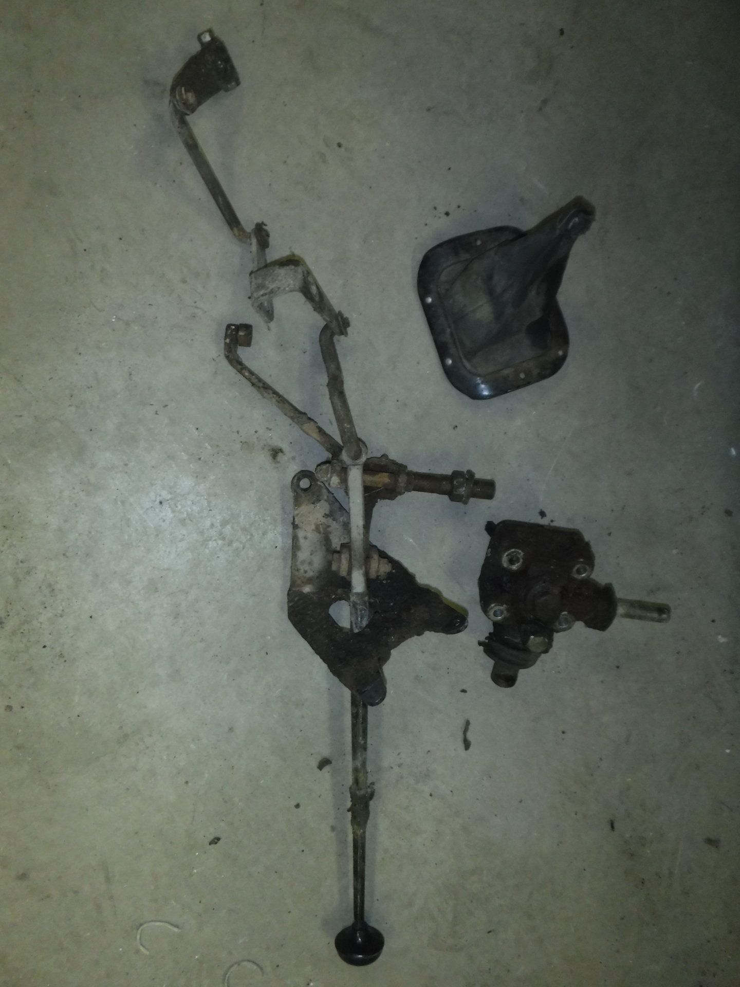

Get rid of it. As I under stand it, I can replace all the vacuum stuff and the lever under the dash with just the lever though the floor, I am correct?
Here's a pic of the 1 I have. The boot is torn and the knob is wrong.
Paul
I'm not sure, but I think that knob is a highly sought after PTO knob.
Thanks Mark. I'll double check it against my pto linkage.
Paul
Let me know what you want for that. I will pay for shipping. I really don't care about the knob. Send it or keep it, quote both ways.
