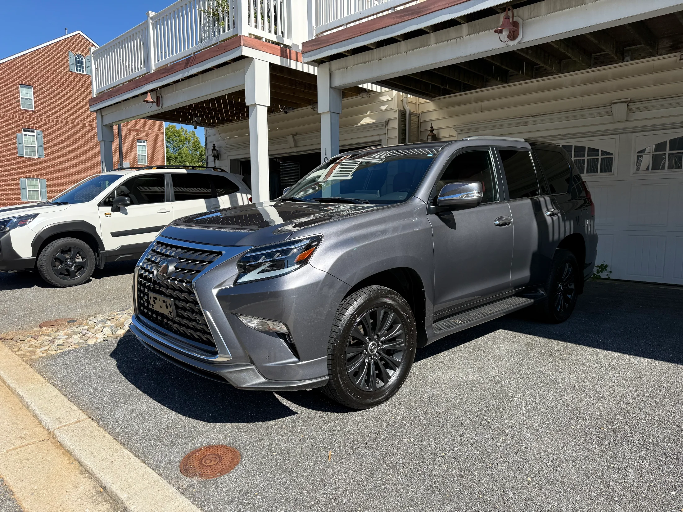

Hey Mud fam.... Long time lurker, but I guess it's time to post something finally. I run a small business that advises clients on vehicle selection and modifications specific to their needs as well as trip/route planning to physically get to those intended locations whether that involves paved roads or not.
Last weekend I traded in my '25 Tundra and switched up our travel vehicle yet again for a '22 GX460... It's a L/Certified truck with 30k miles and a good set of starting specs for the purpose it'll serve ( :rofl: , we'll see about that).
The name? That started years ago with a 2018 4Runner, as a tongue in cheek joke because it was far from a mall crawler, with battle scars to prove it; then switched to a '21 Tundra, then a '24 Grenadier, then very briefly (14 days in my possession, exactly 11 weeks of ownership) to a '25 Tundra. Between the first Tundra and the Grenadier we also built out a '22 Sprinter 4x4, but that's a whole different story.
The GX's goal will be a daily and travel vehicle... I know these words will come back to bite me later, but I think the goal will be a soft roader. Once the Sprinter finds a new home a dedicated trail truck will join the fleet. Allegedly of course.
Enter, the GX. It's a Premium Plus Sport Design w/ Captains chairs in Nebula/Rioja

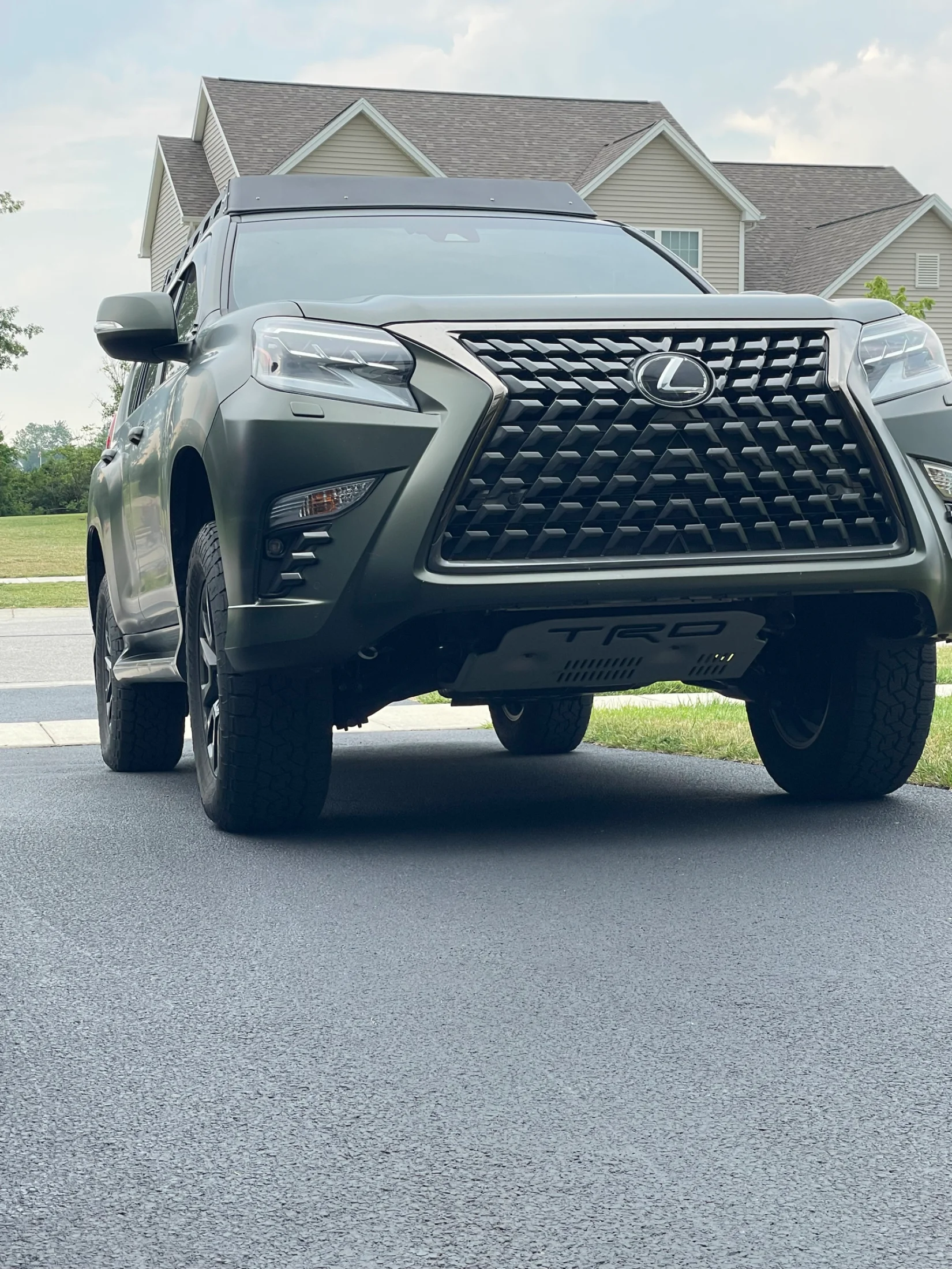

As for skids, the reality is that the front skid will turn into all of them :P I like to lie to myself sometimes and say I'm not going all in
Are you planning on removing the sport design package front and rear spoilers? I've got them too and have been looking for info about what I'd be left with after removing them. Not much out there aside from a video showing someone sacrificing the rear one to the trail gods.
For now I'll be leaving them... But, if they get removed forcibly, I don't think I will be heart broken over it
Here is the front sans spoiler.

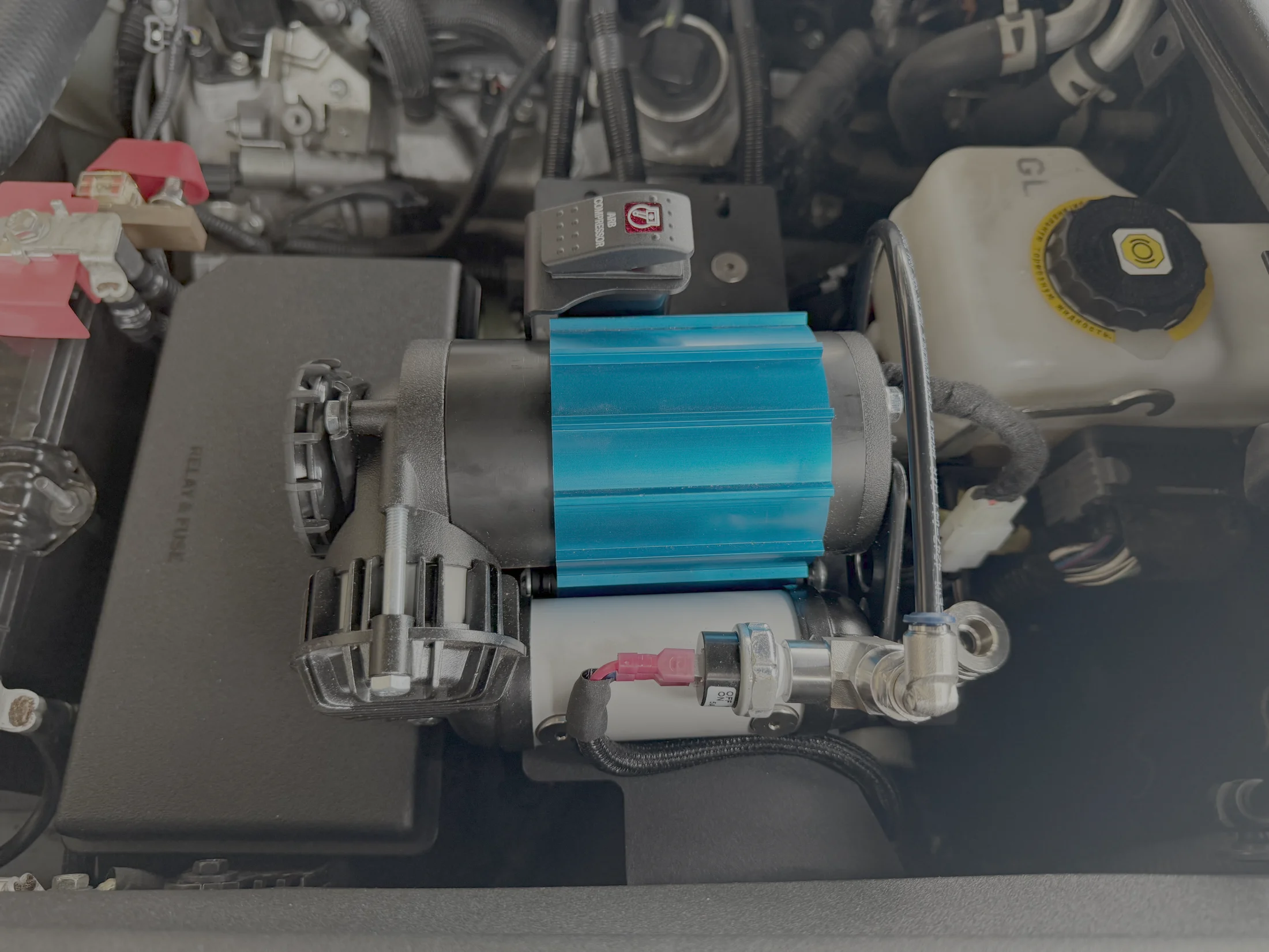

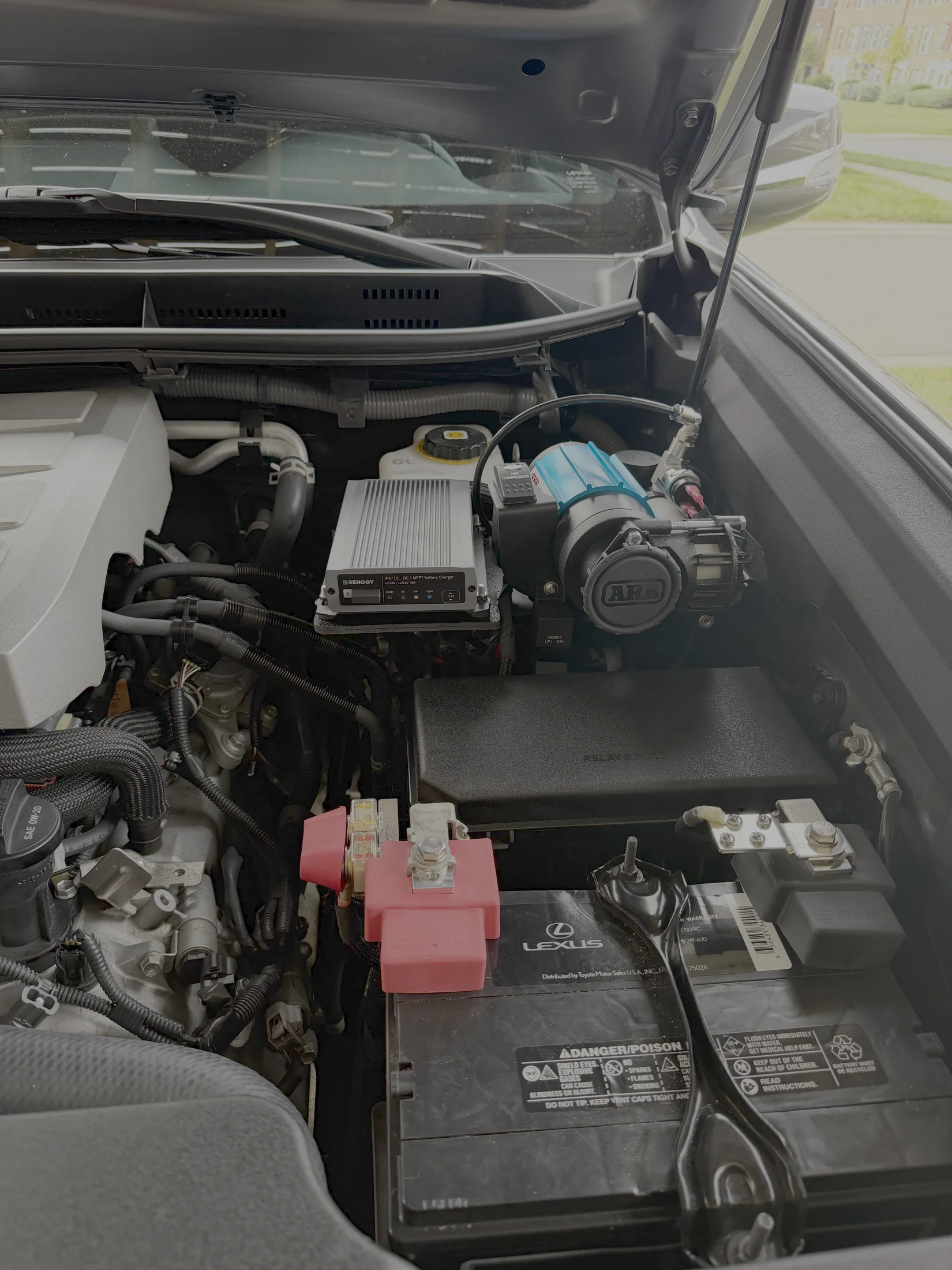

Today I had a few minutes and assembled the SDHQ air compressor mount, an ARB Single I had laying around, and wired it up using an OTRATTW switch I ordered last week. I considered doing another ARB Twin (that has been my compressor of choice for the past 4 builds), but with this only ever getting 31.6" tires and (hopefully) rarely using/needing it, I decided to go with what was sitting in the garage. It was originally ordered for my GF's Forester Wilderness, then tossed into the Grenadier for a few weeks while I waited on the twin to arrive, then relegated to collecting dust in the garage again, now she's considering trading the FW for an NX F-Sport in a few months, so perhaps her car doesn't need a compressor :P
Also popped on the SDHQ billet battery terminals. To note, the terminals being slightly taller were an issue for the positive cables being ever so slightly too short for my comfort. Loosening the battery tie down and sliding the battery about 1/2" to the midline of the vehicle was plenty to allow for sufficient slack in the wires. Perhaps this is a sign that I just need to go pick up a Group 27F AGM.
I know, I know, interior TESA tape in an engine bay isn't a great look. The last time this compressor was installed, it was mounted inside, thus the soft tape, I didn't recognize it until after it was installed and I just didn't feel like unwrapping and rewrapping the short section of harness. I'm pretty sure now that I've photographed it, I'll be irritated enough to want to fix it.
In lieu of the inline fuse ARB supplies with the harness, it's wired to the dual post MRBF fuse block; the other position will be for the DC-DC charger for the LiFePO4 battery. That install may happen (at least the exterior bits) on Monday, since we have some form or another of rain in the forecast from Tuesday through next Monday; and next Wednesday we leave for Overland Expo East

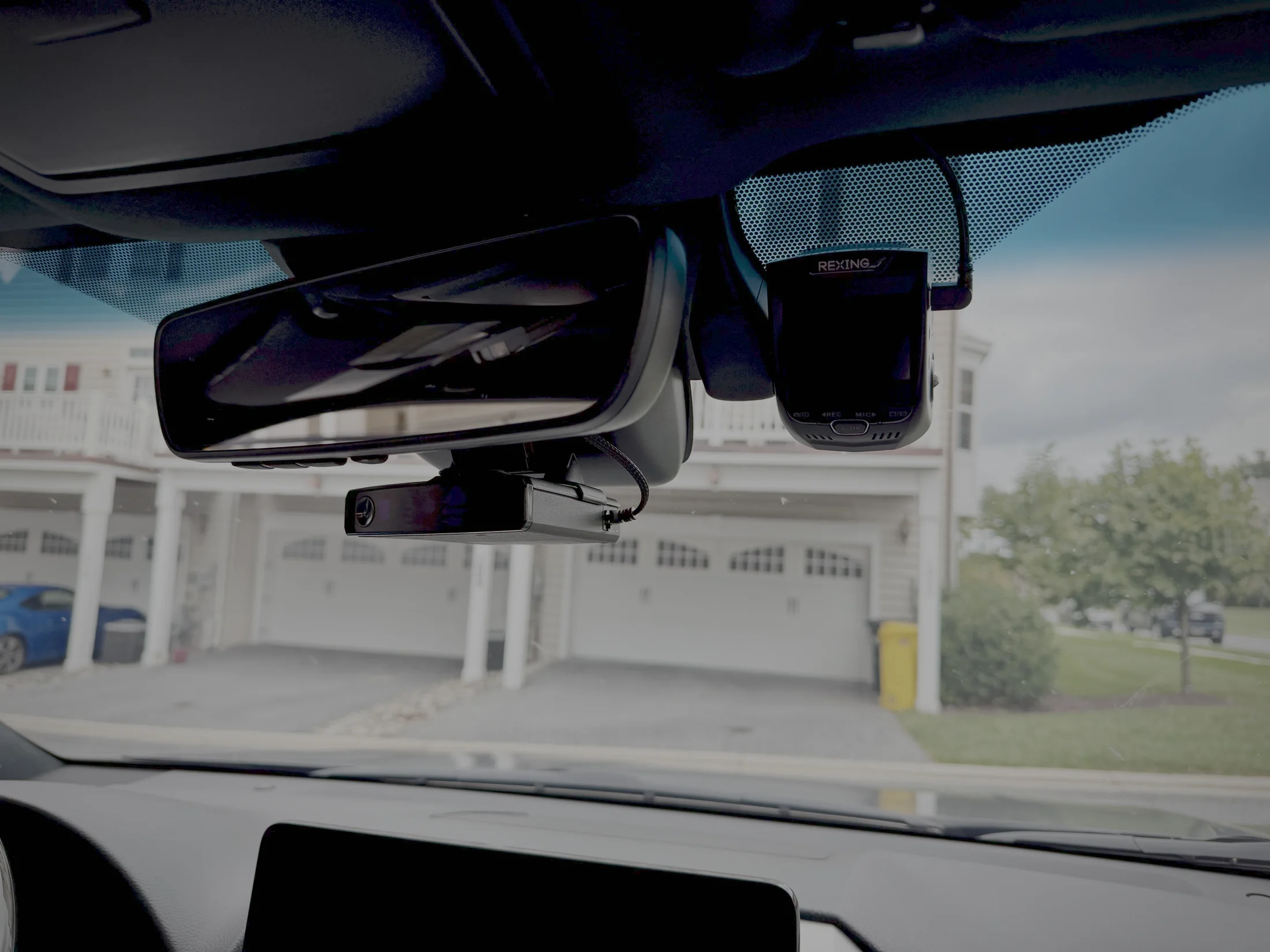

Blendmount has been in for about a week holding the V1 Gen2. it is powered by tapping into the OEM harness behind the mirror. Also from the same source is the Dongar dash cam power adapter, powering today's install of a Rexing V1P dash cam. I wanted to wait until the windshield tint cured before sticking it on, thus the delay.

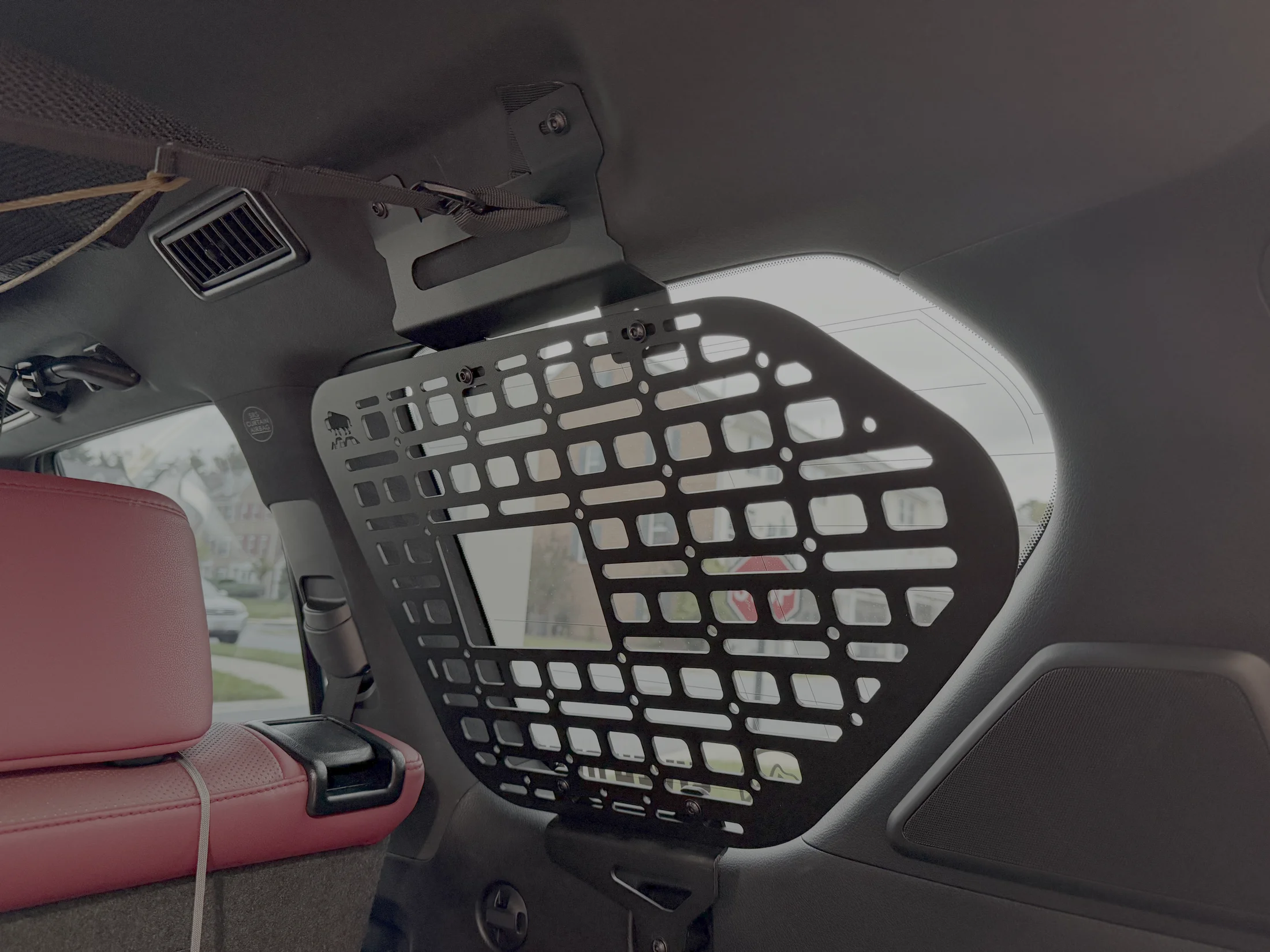

Also got the Bison Gear cargo window MOLLE panels the other day and quickly installed them as well. Now to take all the stuff that has lived in drawers in previous builds and make use of my sizable pile of Blue Ridge Overland Gear bags that I've ordered and never used through the years to mount it all. Barely visible in the photo is the BROG Attic that I installed a few days ago

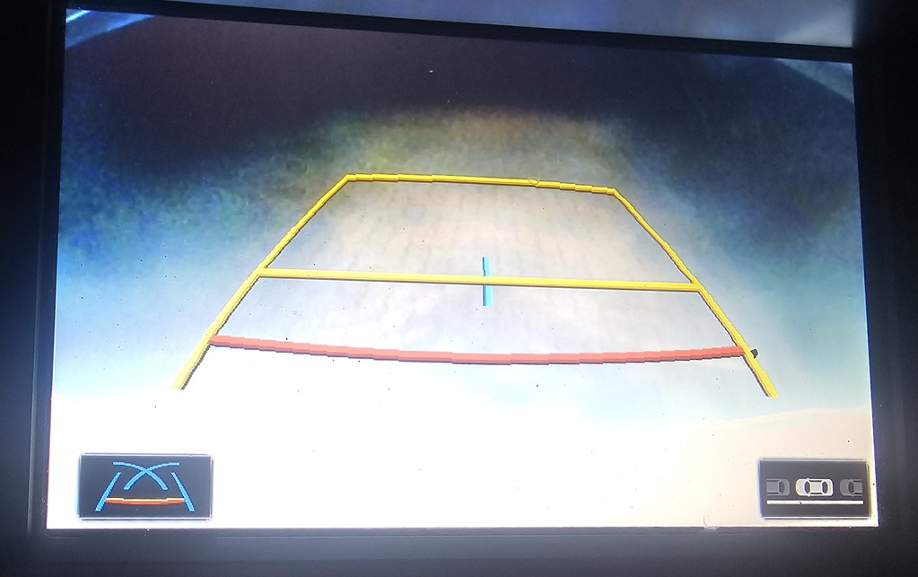

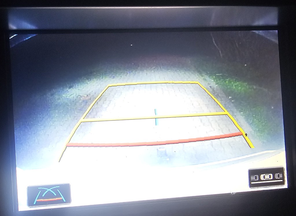

The XPR reverse lights are head and shoulders above others with thermal power kick down protection. For those that travel in herds and always go all the way through a trail likely not a big deal. For the rest of the world that actually explores and often have to backup from a dead end for up to a mile or more it is a huge deal. Sounds like you already know that ;)
Factory reverse lights
DD XPR lights

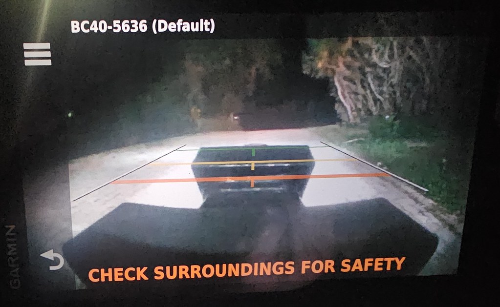

Much gooder. But the limiting factor is the display, and I suspect the camera. On my previous Polaris Northstar I installed a Garmin BC-40 camera connected through BT to my Garmin. I upgraded that buggy to a Northstar Trail Boss with arched A arms and 14" of ground clearance. And built in front camera with a rear camera with thermal infrared no less. So didn't need the BC-40 any longer and moved it to the GX. It is how the GX should look IMO
Some time as above with DD XPR reverse lights and Garmin BC-40

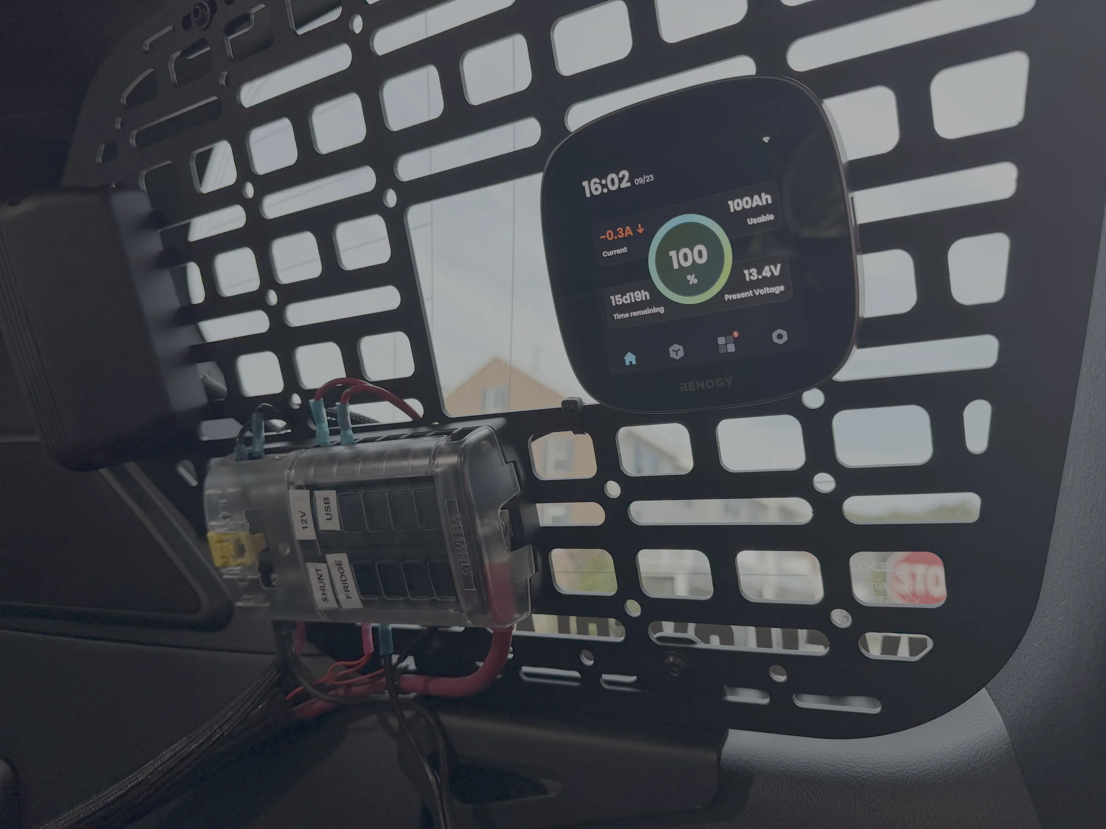

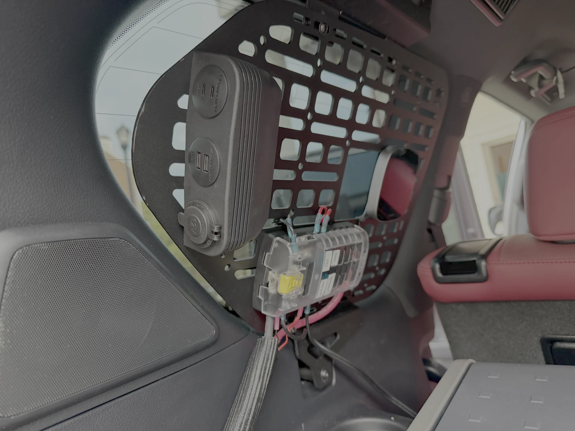

Finally got the second battery installed and wired up, albeit a totally temporary install until my GooseGear plate shows up so I can make a real mount for the battery and fuse block. I've got a good bit of experience among different brands/ecosystems (Redarc, Victron, Battle Born, Dakota Lithium, X2 Power, etc.) between my own previous builds and clients, but one (fairly) popular one I haven't dabbled with is Renogy (beyond using their solar panels), so this truck has a good bit of their stuff.
Power system consists of a Renogy Core Mini Heated 100Ah battery, Renogy 300A Shunt, Renogy ONE display/monitor/hub, and Renogy IP67 50A DC-DC Charger w/ built in MPPT controller. Depending on space with the final layout, I may add their 1000W inverter as well.
Since it's a temporary install, the Blue Sea 12 outlet fuse block is bolted to the MOLLE panel, as are the USB/12v outlets, and the battery is wedged between the side panel and the fridge, with some 3M MiniCell as a cushion on all sides. Forward of the fuse block is the Renogy ONE display. The location definitely isn't ideal, but it isn't too bad to lean in and tap it to turn it on, the big plus with the display is that it acts as a communications hub for all the BT Renogy gear, and then connects to Wi-Fi to make it viewable remotely. I've gotten really spoiled over the past handful of years and builds by using this same technology with the Victron Cerbo GX.
Charging the battery is the Renogy IP67 50A DC-DC charger w/ MPPT... From what I've read this unit is apparently somewhat (internally) a clone of the older Redarc BCDC1250D, we'll see how well it works in the long term. I know that while idling in the driveway, within 25-30 minutes it thermo-throttled itself back to 27-30A, which I'm not super opposed to given the fairly weak 150A alternator these trucks have. I'm sure that if driving the added airflow through the engine bay may help slightly, but its case temps remind me of the older Victron Orion-TR 12/12-30. I'm running a trio of those in our Sprinter, in a climate controlled cabinet, and each of them have 3 40mm server fans blowing across their heatsinks.
While I don't see my self using the compressor on this truck very often, the DC-DC charger is isolated on a set of rubber mounts from the main mount to eliminate vibrations (although Renogy advertises it as safe for drops???) Not visible int he photo are MC4 plugs behind the compressor to connect the Lensun Solar panel next weekend at Overland Expo when I pick it up. As with the install of the compressor, there's still room to open the fuse box cover without having to move/remove anything.
