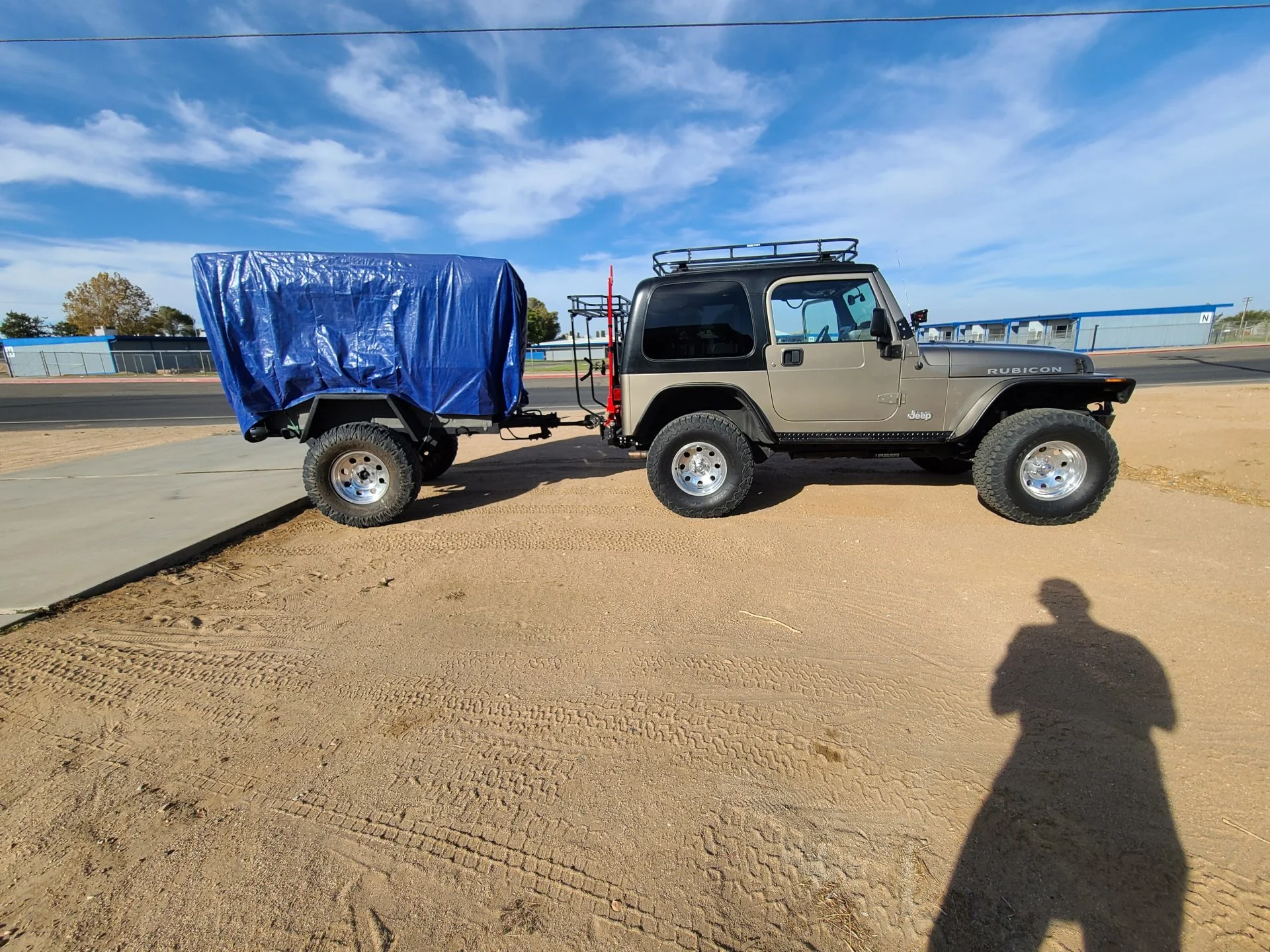

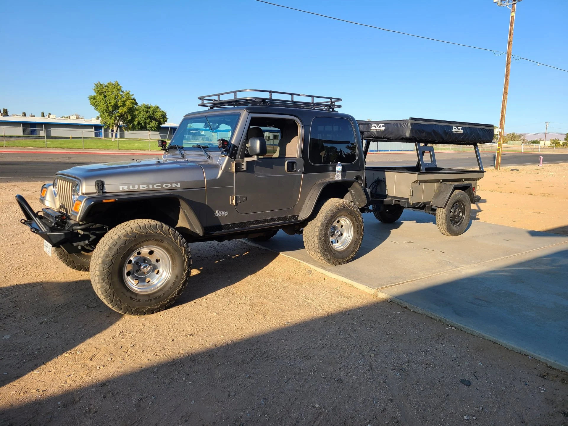

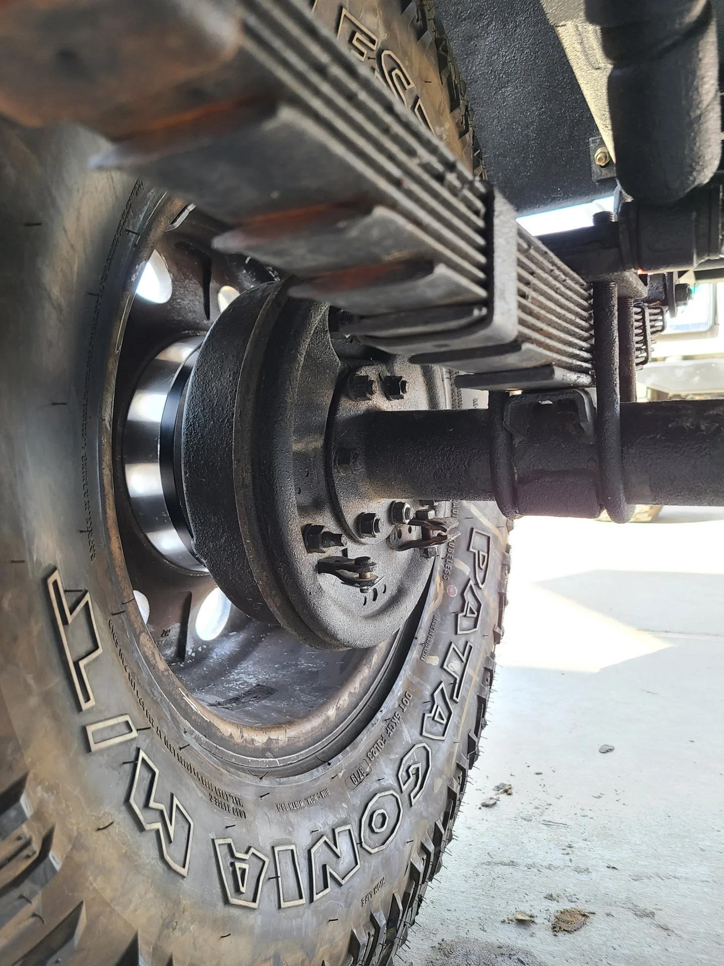

Thanks for the response. I am going to flip it this weekend and throw some 33's on it. I will post some pics.
