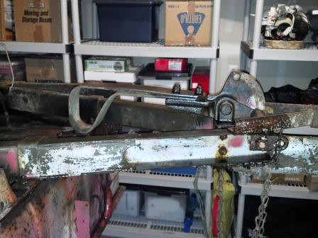

Frame deconstruction updates.
I spent a few hours this weekend tearing apart more of the frame. Out of all the bolts I worked through only 6 of them came off using the impact wrench. The rest had to be ground down.
Here are some updated photos.
StandInGarage..03.17.12 by XRover, on Flickr
This is a test using Flickr to host my photos. I will edit it out if it does not work.
The only thing I was really wanting to mention at this point is that I intend to save the jack stand because I think they keep a lot of the original character. I will have to extend it slightly if we go with a Axle under setup though; but that's for another day.

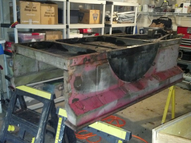

First is the obligatory "my trailer is upside down in my garage" photo.
InsideGarage..03.17.12 by XRover, on Flickr
Seems like the Flickr hosting is working for me. It is actually much simpler than I thought. You just need to know what code to copy and paste.
This photo also shows the shocks taken off. I spent most of Saturday morning working on those and all the small screws and nuts holding the wiring system in place.
I removed the stuck fender (one of the only bolts that actually unscrewed) but the consequence of that is my house now smells like PB.

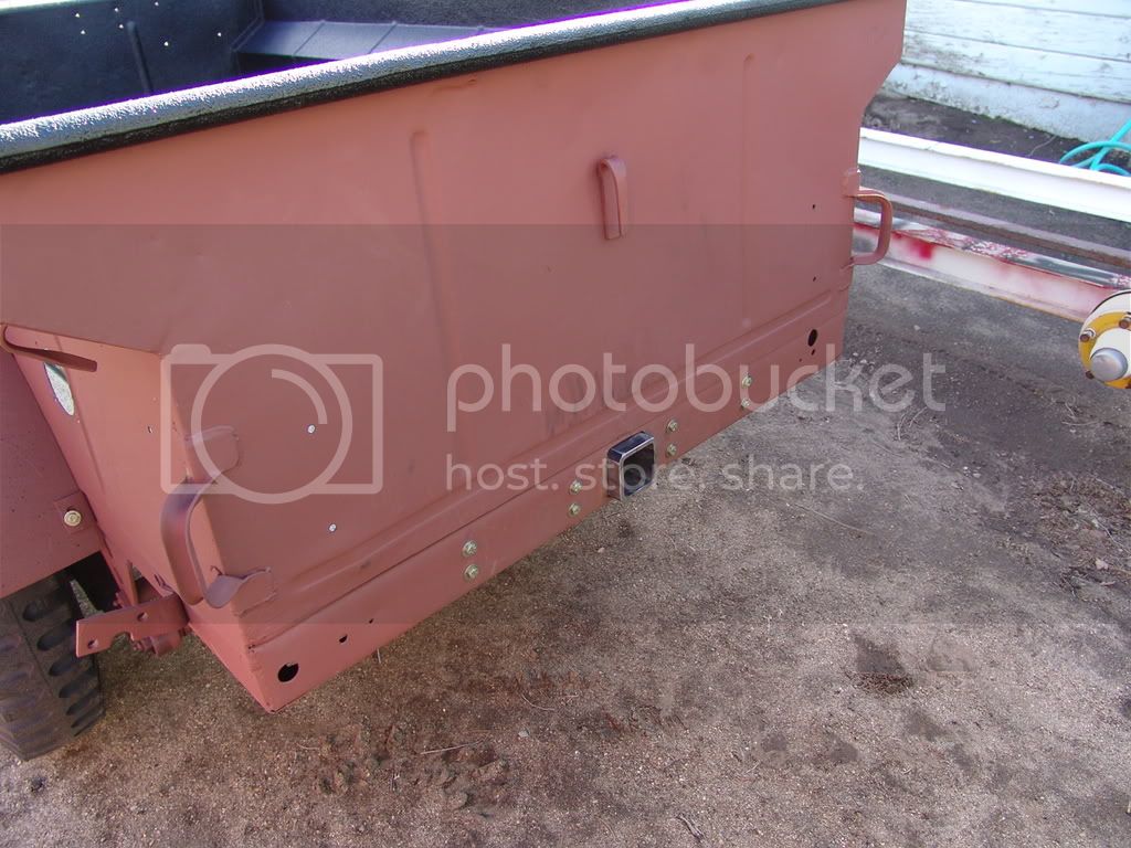

I wouldn't extend the rear bumper further rearward...
as I'd think it would limit the exit angle out back
especially during any extreme trail duty.
I would think to reinforce that rear support for the receiver
and then add a skid plate of sorts out back.
Not sure why you think you need/want
to install an extended rear bumper ?

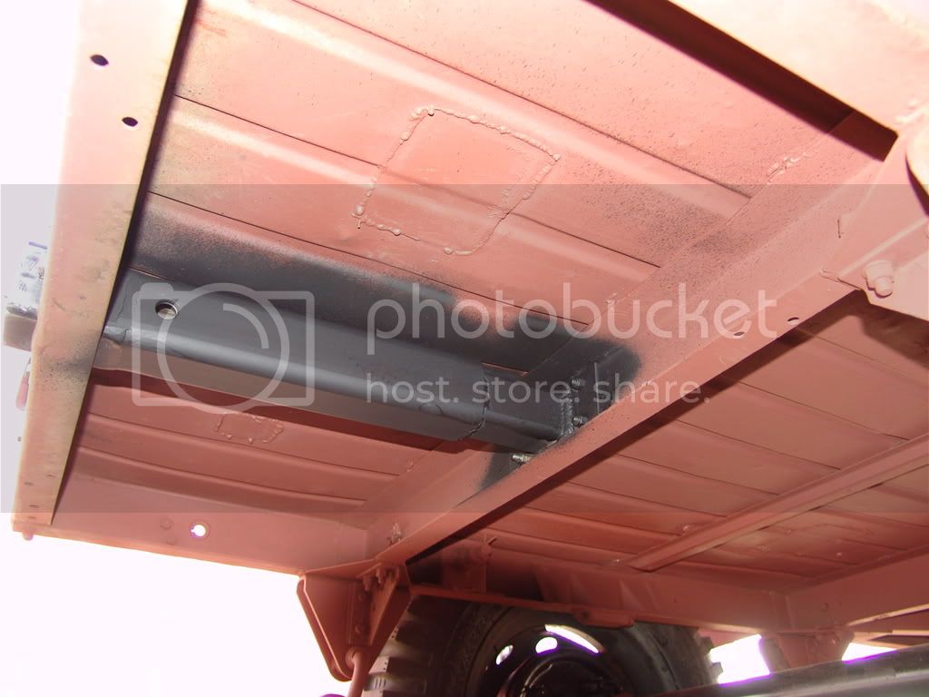

I'd also think of "C" channeling the frame to give that more
strength.
http://i28.photobucket.com/albums/c221/cbrRRman/M100 frame strengthing/M100framerepairs20.jpg
http://i28.photobucket.com/albums/c221/cbrRRman/M100 frame strengthing/M100framerepairs21.jpg
also reinforced my shock mount(s)...
for spacing and added support with the "C" channel work
(was welded into position later)

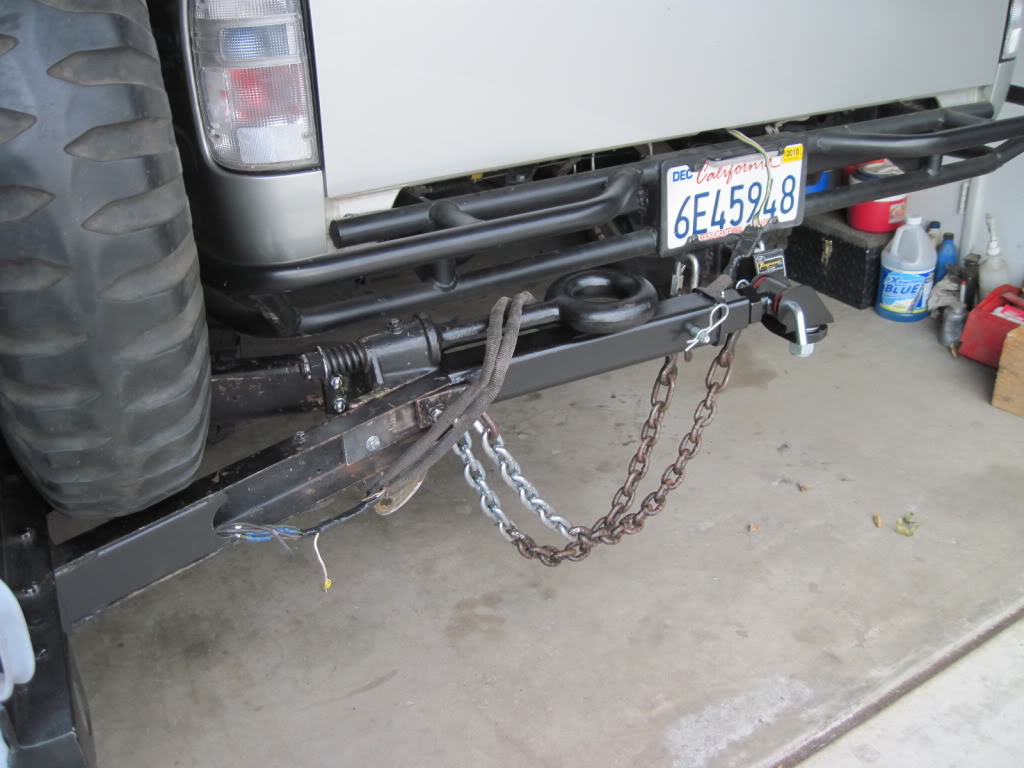

Here's another option if you don't want an external bumper. It's tied to the crossmember in front of the rear frame piece.
fireflyr said:
That is great looking. I hope I can make my mods look that clean. Is there a flat piece bolted to the frame and welded to the hitch extension? Can you shoot us a picture and load it up here?
