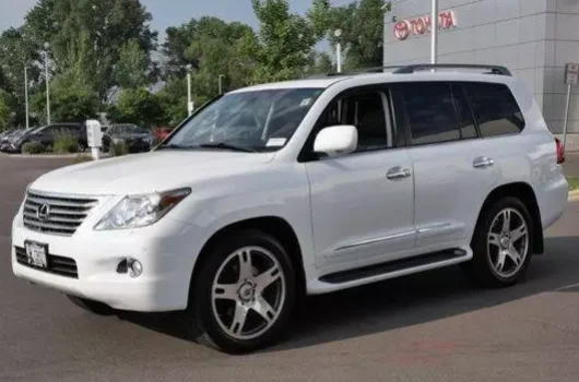

Hello I am thinking about pulling the trigger on this LX570. I see that it has the F-Sport / TRD Forged wheels. I believe they are 22". I do not want to run street tires and want some type of All-Terrain tire, BFG/Toyo etc.
Do you guys think I would be able to put an AT tire on this rim and have no rubbing issues. The options at a 22" size for AT's are limited but BFG makes one and have not looked at others yet.

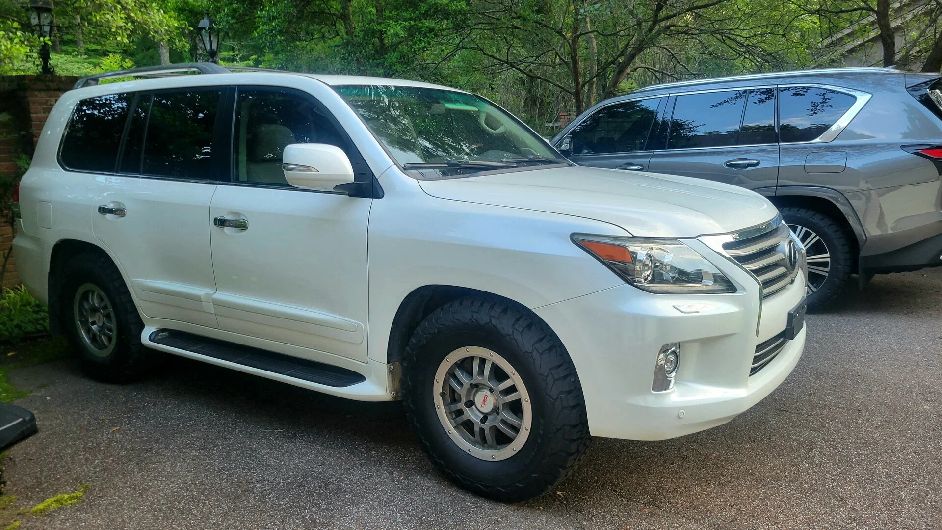

On my LX570, i swapped the 20" stock rims with 17" rock warriors and some BFG's (295/70R17). I prefer the smaller rims and they will be better offroad too, though that is a tiny portion of the time.
I would recommend getting rid of the 22's and going to a 17" or 18" set of rims. I was not a fan of the 22's.
Here's my LX570 with the rock warriors and BFG's.

with a 22" wheel, you would not have much room for anything with any sidewall. There would be little to gain from running AT tires. It would provide minimal performance on the trail and really do a number on your ride quality. I would skip right past the 22s and get something more suitable.
Thank you for informative post. I will ditch the 22" or hopefully sell them.
Or just keep the 22s as spares for city driving and get an additional set of 18s with some AT rubber. Depending on if there is any interest in the used market for those 22s and how much you can actually get out of them.
Those rims are rare and valuable to the right buyer. Personally, I think 22’s are stupid and wouldn’t own a truck with them.
