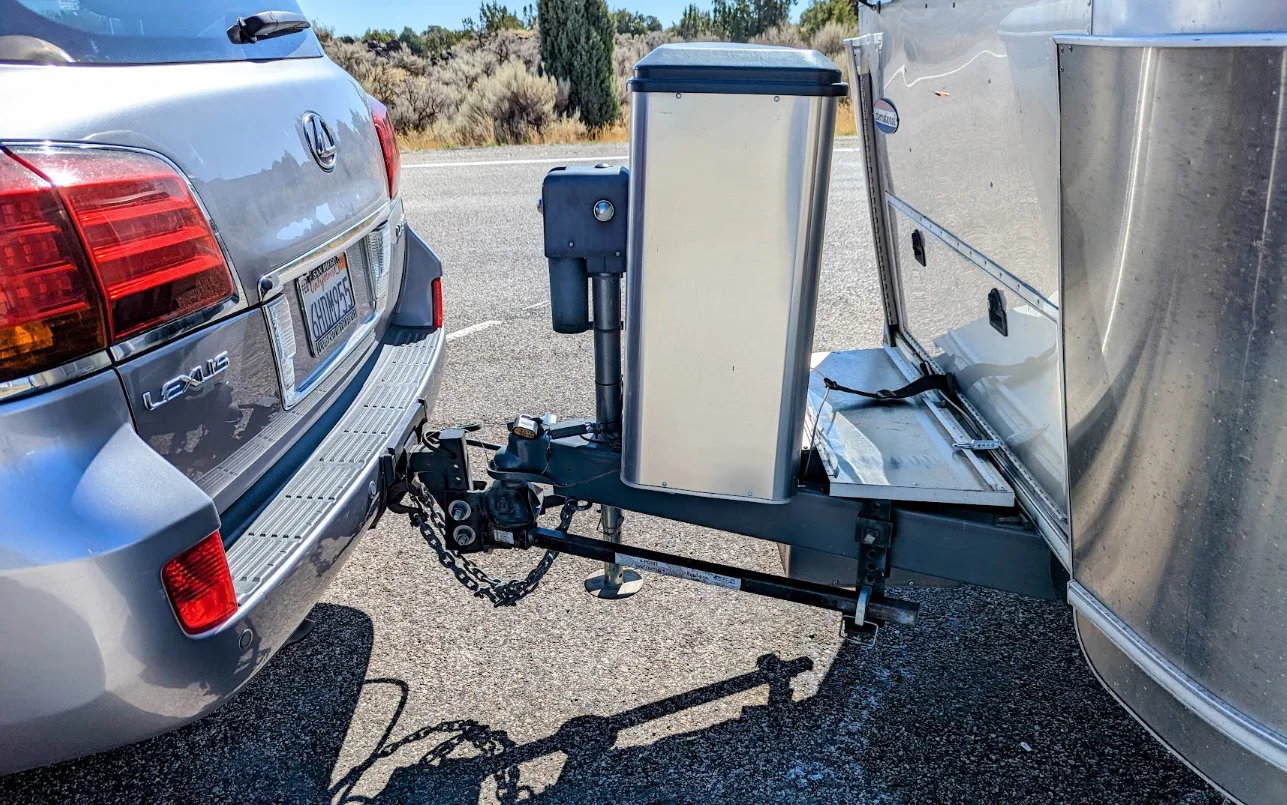

I think you can see above that I'm at 15,620lbs combined doing my longest 3k mile trip to Yellowstone for SoCal with an extended family of 6. Over some of the largest mountain ranges and highest speed stretches through Arizona. She did great and I have no desire for any other tow rig from a towing perspective with no lack for power, stability, or towing smoothness. Agility is exemplary towing longer trailers. Add to that, no other single vehicle will do what the 200-series will do with room for 8. Off-roads like a beast. Coddles the family in 4-zone A/C, Mark Levinson audio, and leather lined luxury.
A shortcoming as others have mentioned is MPG, but more specifically range. ~10MPG is the norm towing that size trailer. She'll hold 80MPH easily (with a well dialed in WD hitch) provided you're willing to allow her to drink at 7MPG. Honestly those numbers come with the territory for every tow vehicle towing larger trailers. The factory tank size is on par with just about every other 1/2-ton save for the Tundra and Ford that have extended capacity tanks. With a stock rig with HT tires, 230mi range at reasonable speeds works fine and I did that for a number of years.
The 200-series can be fitted with an aftermarket LRA aux tank which handily solves that issue for a combined capacity of 38G. Range of 500mi solo or 300mi towing in my setup with larger 35s.

Agreed and never worth putting the family at risk. Stock and setup right, the rig is uber stable. On account of its significant mass and big bones.
Honestly all my mods should generally make towing worst. Because of that, I did everything in incremental fashion to respect the limits. I only modded (for offroad performance) when I was absolutely convinced the rig towed solidly, that I continued to build it on 33s and 35s, and with more incremental weight. Always with proper supporting mods including brakes and re-gearing.
I've helped another buddy setup an identical rig and he tows a similar Airstream 27FB with a 2008 LX570. He's happy.
aden weights with no accessories or gear. It is well known in the AS community that Airstreams specs are very much on the light end. While I don't have actual weights (yet), those who have, generally report tongue weight in excess of 1000lbs, and trailer weight about 10-20% more.

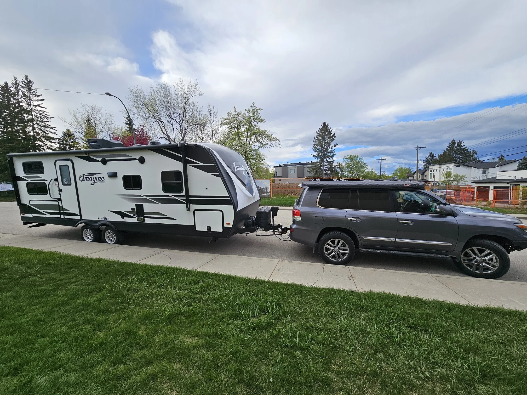

I feel like I am towing a bit more modestly than some. Sold the Class A recently, and picked up a travel trailer yesterday. The LX tows ~6,200lbs like a champ...sure chugs fuel though! Will report back after towing the big hills in the Rocky Mountains.

WHat model of WD hitch is that?
Also, @TeCKis300 can you be more specific on the model of yours?
Thanks!
do you know the difference between that one and this one that seems like similar specs for $200 less?
That looks to be an Equal-i-zer 1000, but it does not include the 2 15/16" ball. If you want the ball you need this one:
I would see if you can find a used one if you wanna save a few bucks. There are like 5 for sale at any time here locally.
I also run an Equal-i-zer 1000 lb and its great. Ive put about 30,000 miles on it and its always kept my trailer super stable. That said, looking at that one in your link, you may need more drop on the shank. The receiver on the 200 series sits super high, higher than my F150 and GX460 did. I have to run my shank at the lowest setting and even then Its still a little high with my larger tires. I bought a new shank with more drop for when I finally sensor lift my truck.

It's a "Pro Series 49904 RB3" . It works great. I've added a friction device / anti-sway (just in case). There are lot's of great options out there.
Subsequent to my last post, I've towed all over the Canadian Rockies, and I have no concerns pulling the fully loaded Grand Designs 2400BH up the 93 north / 93 south, and frankly any place I want to access by road. I'll probably upgrade the trailer suspension prior to taking her to some of my preferred boon-docking spots on the forestry trunk roads.
