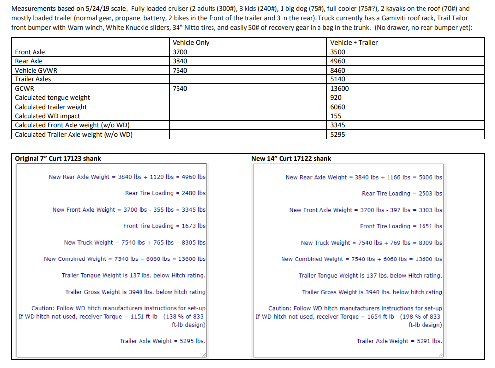

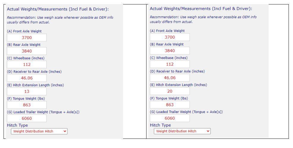

For #2 I read it adds about 1% additional TW (and thusly 1% less front axle weight) per inch of shank extension. I found a fairly advanced calculator online at one point and did the math based on our existing rear overhang from the axle and that showed less impact (about 1% total). Screenshots of what it calculated are below, so feel free to re-do my maths if anyone disagrees.
It would be better to extend the coupler on the trailer, but that's harder to do in most cases, and less portable to other trailers.
I didn't notice significant differences in porpoising, not any real difference in sway or handling. There probably is some for sure, but it's not significant in my experience.
The details (for those who care):
I weighed my truck with just 2 people and a full tank of gas and with my bumper it's currently 3540 front/3700 rear.
I did do a weigh-in while traveling this time, and my additional gear and people shown below was basically the same. Now I have a ~50# drawer and a ~220# bumper on the vehicle. I definitely had some fresh water in the trailer. My front axle was 3300# and my rear was 5420# and the trailer axles were 5360#. I am not sure the TW as I didn't weight it separately but even with maybe 7-8 gallons of fresh water in the tank (which sits forward of the trailer axle). My old #s shows 4960 on the rear axle, so add 50# drawer and 220# bumper as shown above and I'm at 5230. There's the weight of the spare off the rear so whatever effect that has on the rear axle weight plus another 100# of water in the trailer (assume at least half of that is on the tongue) and I'd wager I'm at 5300# at least without accounting for the longer shank. Diff is 120# for the extra 7" shank length which is about 2.5% weight penalty... not that far off from the 1% shown by the original calculator.
Calculator says:
Calculator says:

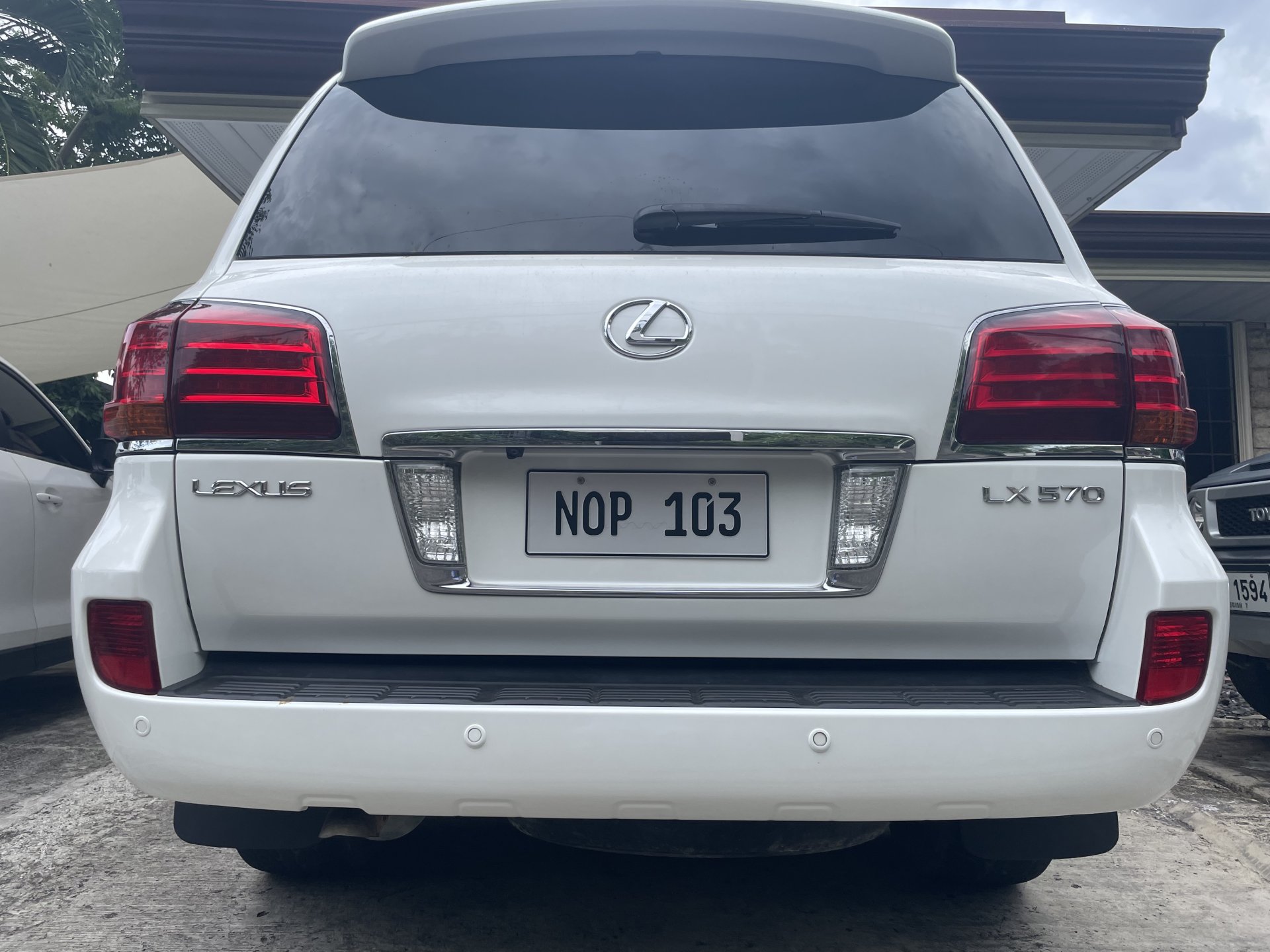

Hi, Im new here. Wanted to ask what my options are for towing? I have a 2011 LX570. As far as my research shows, the LX570 has a tow hitch cover to access the receiver. See photo, mine doesnt? Maybe previous owner swapped his bumper? Do I have to mount a receiver below the frame or is it as simple as putting a hole onto my rear bumper. Advise is much appreciated!
I've never seen an LX from the states configured like that. Where you able to do any discovery to figure out if it has a tow hitch?

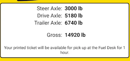

Just re-weighed my rig to check the WD after re-working the suspension for AHC Long Travel. I'm also on a longer road trip to Yellowstone with an extended family of 6. So loaded to the gills. Hit a high watermark for Gross Combined Rig Weight (GCWR) at 15,620 lbs o_O . I didn't get on the scales exactly right so looks like 1 set of trailer axles was on the same plate as the LX rear axle. Still useful as I can distill the following numbers. WD is in the right ballpark.
Even at this grotesque weight, the LX rides like a cloud, so far 2k miles into the trip. 42 psi front tire, 46 psi rears, 18 psi rear airbags. The family and I couldn't be more satisfied with the ride and comfort. The new suspension globes, shocks, and fluid seems to have made a solid improvement. Lots of mountain roads, 75-80mph in stretches, on 35s. There's discussion in other threads for re-gear, and I'm still of the opinion that even at my weight, 4.3s are the right re-gear for anything up to 35s. Torque converter lock-up is spot on. 4th gear allows some margin of additional power to keep lock-up even on small grades and wind. Gas mileage has been rough at 8 - 9MPG most tanks, as we're trying to make distance holding higher speeds with most stretches increasing in elevation. Fortunately gas prices outside of CA have mostly been in the $4 range.
Steer Axle: 3,120 lbs
Rear Axle: 5,460 lbs
LX: 8,580 lbs
Payload: ~2200 lbs
Trailer axles: 7,040 lbs
Tongue: ~1200 lbs
Trailer Gross: ~8,250 lbs
GCWR: 15,620 lbs

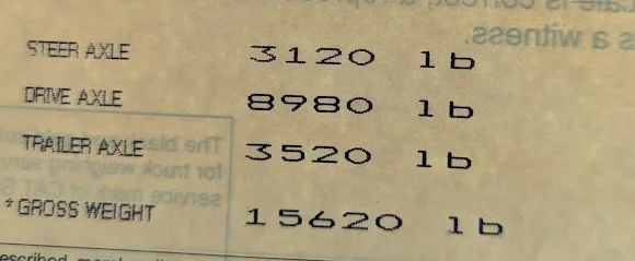

I think you can see above that I'm at 15,620lbs combined doing my longest 3k mile trip to Yellowstone for SoCal with an extended family of 6. Over some of the largest mountain ranges and highest speed stretches through Arizona. She did great and I have no desire for any other tow rig from a towing perspective with no lack for power, stability, or towing smoothness. Agility is exemplary towing longer trailers. Add to that, no other single vehicle will do what the 200-series will do with room for 8. Off-roads like a beast. Coddles the family in 4-zone A/C, Mark Levinson audio, and leather lined luxury.
