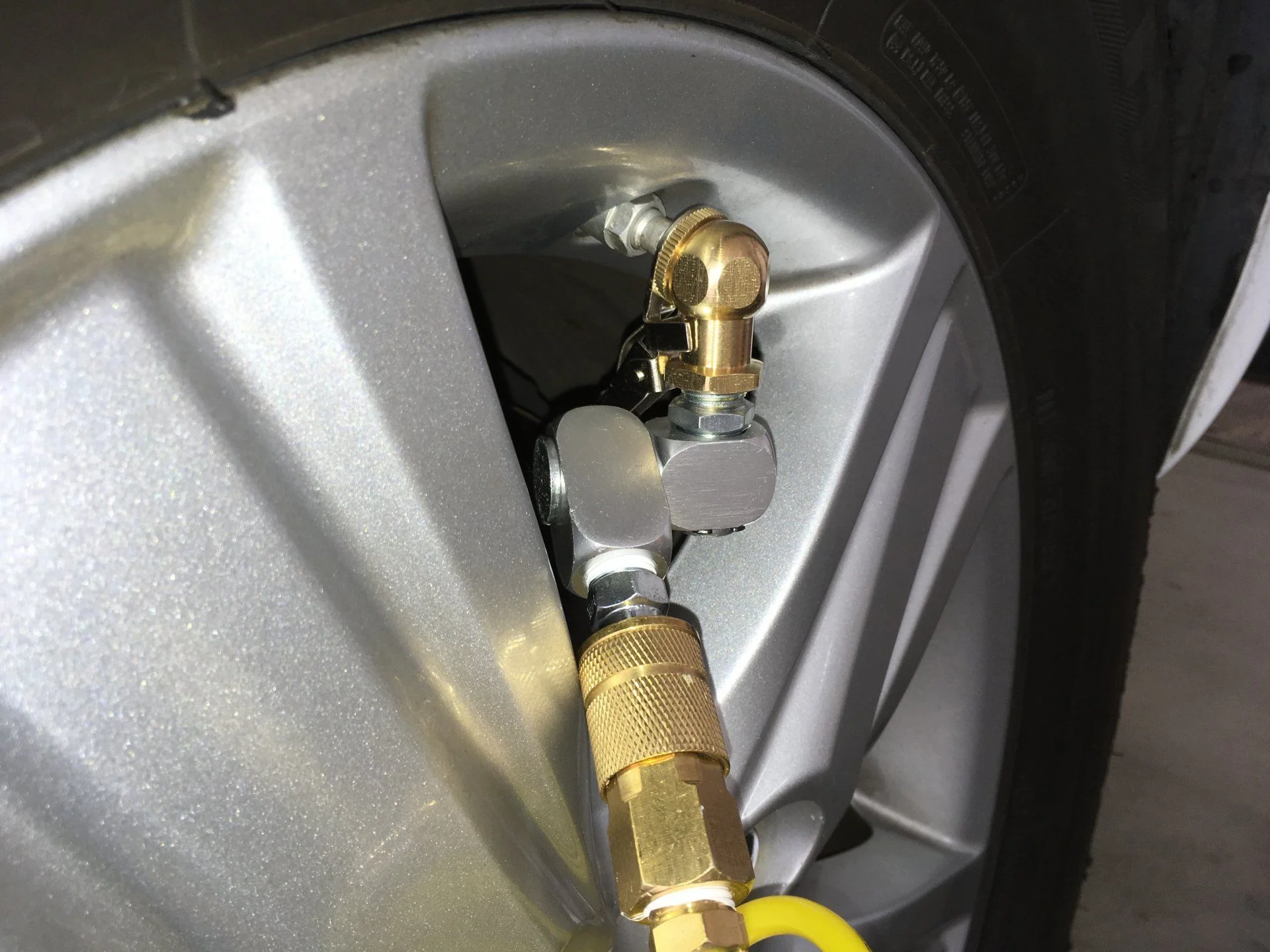

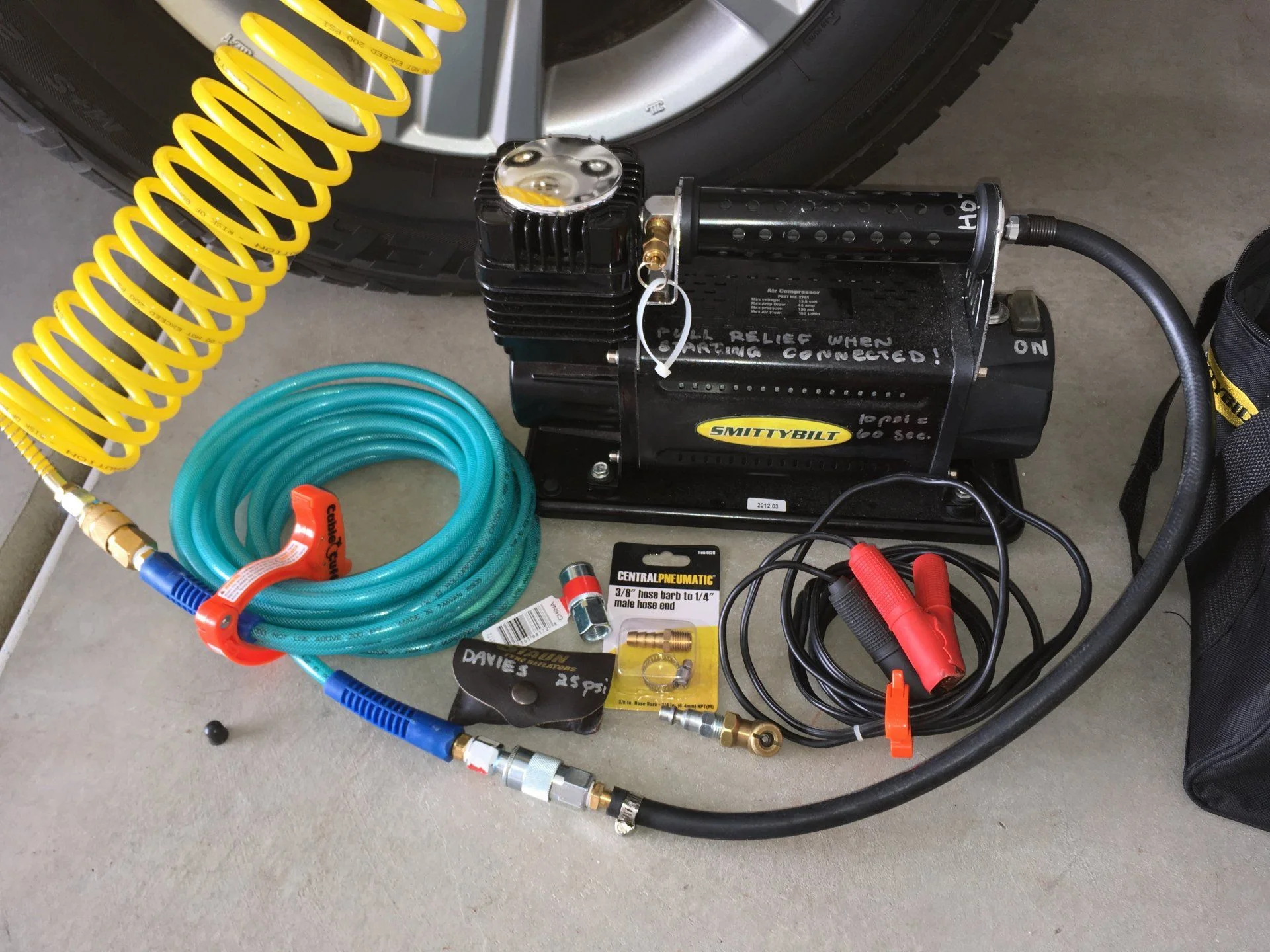

Here are some pics of that Smittybilt pump. I cut off the stupid weird fittings at the black hose coming off the pump. I installed standard QR air hose fittings everywhere. The hose coming off the pump requires a 1/4 inch barbed to 1/4 MPT adapter at the far end. The pump end remains untouched.
The coiled yellow hose is a replacement with MPT fittings, the blue hose is a 1/4 inch x 25 ft extension. I made a swiveling air chuck. All except the blue hose are from Harbor freight for about $20... I can't recall the source for that.
With the engine running, the pump inflated a stock 200 tire from 22 to 34 psi in about 1 minute 20 seconds.
You do not need an inline gauge, just time the pump - it raises the pressure about 10 psi every minute. Over-inflate each tire and then drop the pressure to the correct amount using a good digital gauge.
Keep some spares in case you need to repair a hose in the field. Everything shown except the gauge fits in the supplied soft case.
