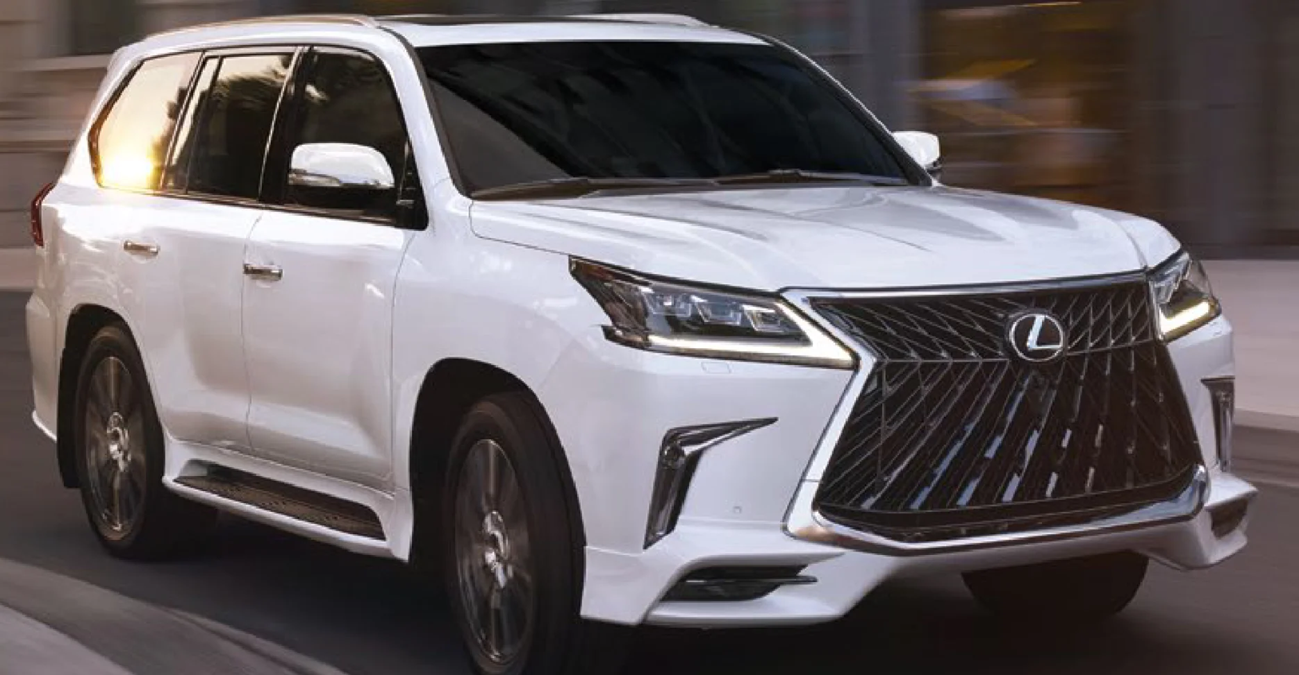

Does anyone know if the Sport package grill will fit onto a non-sport LX570?
My main concern is around the bottom of the grill where they add the splitter, it looks like the shape of the grill trim is different.
The listings on eBay say you have to have the fairing kit for it to work which is a bummer

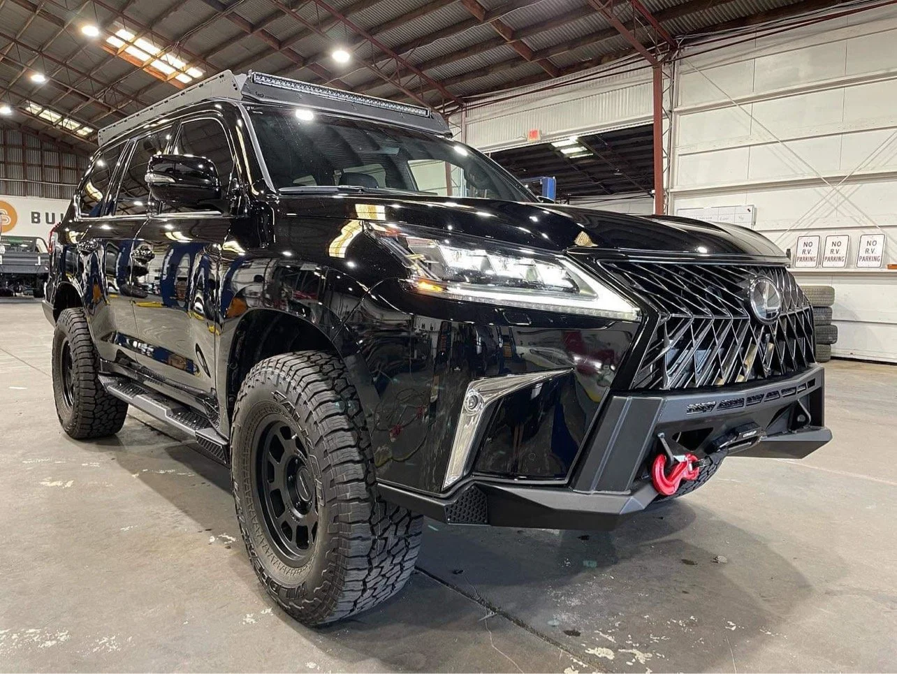

They have knockoffs on eBay but they're still like $500 which is borderline offensive. Definitely think it would look sick with the newer 460 style or the spiderweb F-sport grill
I would ultimately run a bumper and end up hacking the bottom of the grill off anyways, I just really don't like the regular 16+ LX grill.
This dudes setup is mint:
Agreed 100%. This is exactly what I want to do on mine. I should probably make at least one payment on it before I start cutting it up though lol

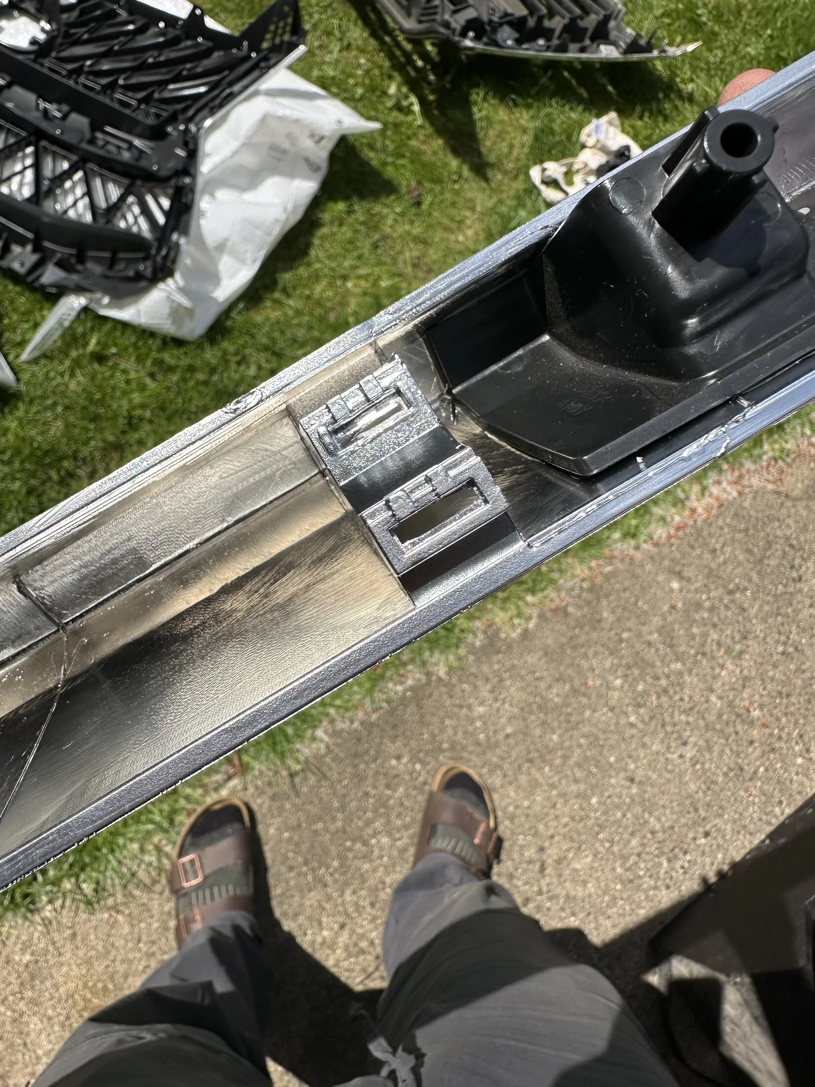

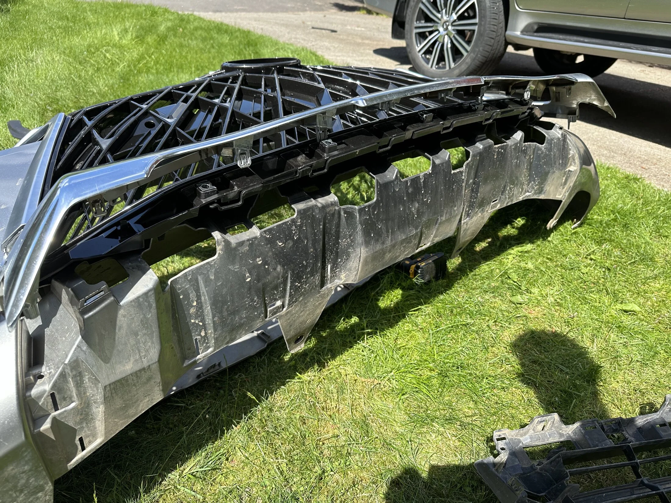

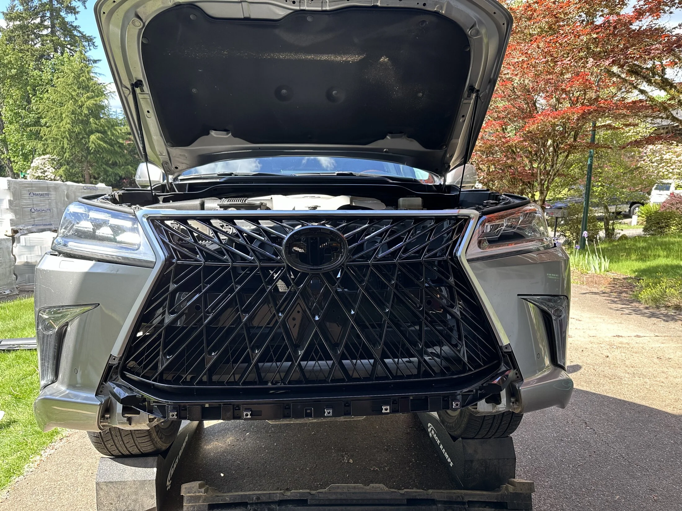

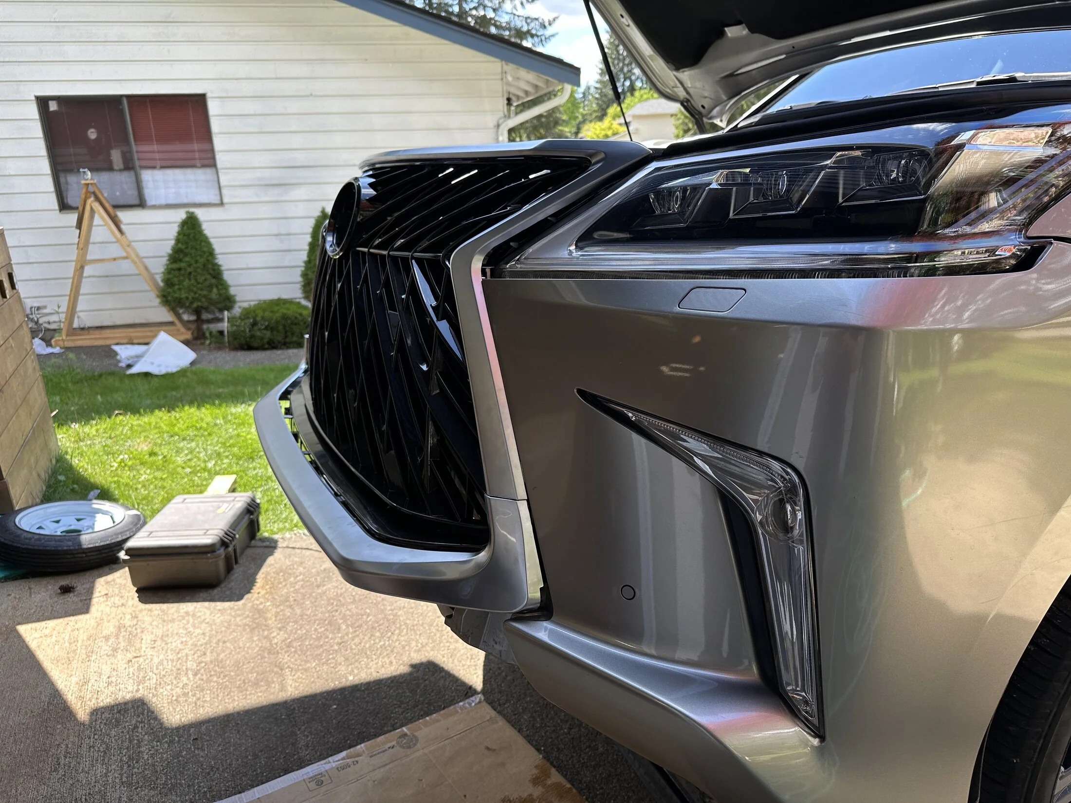

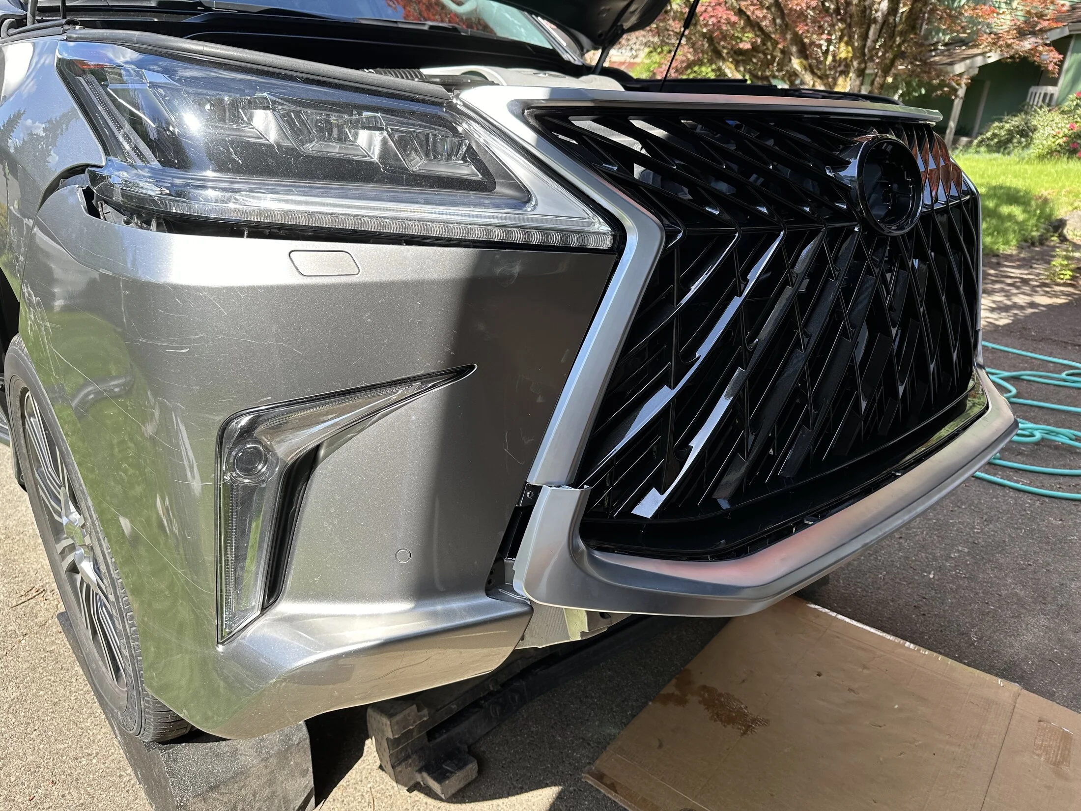

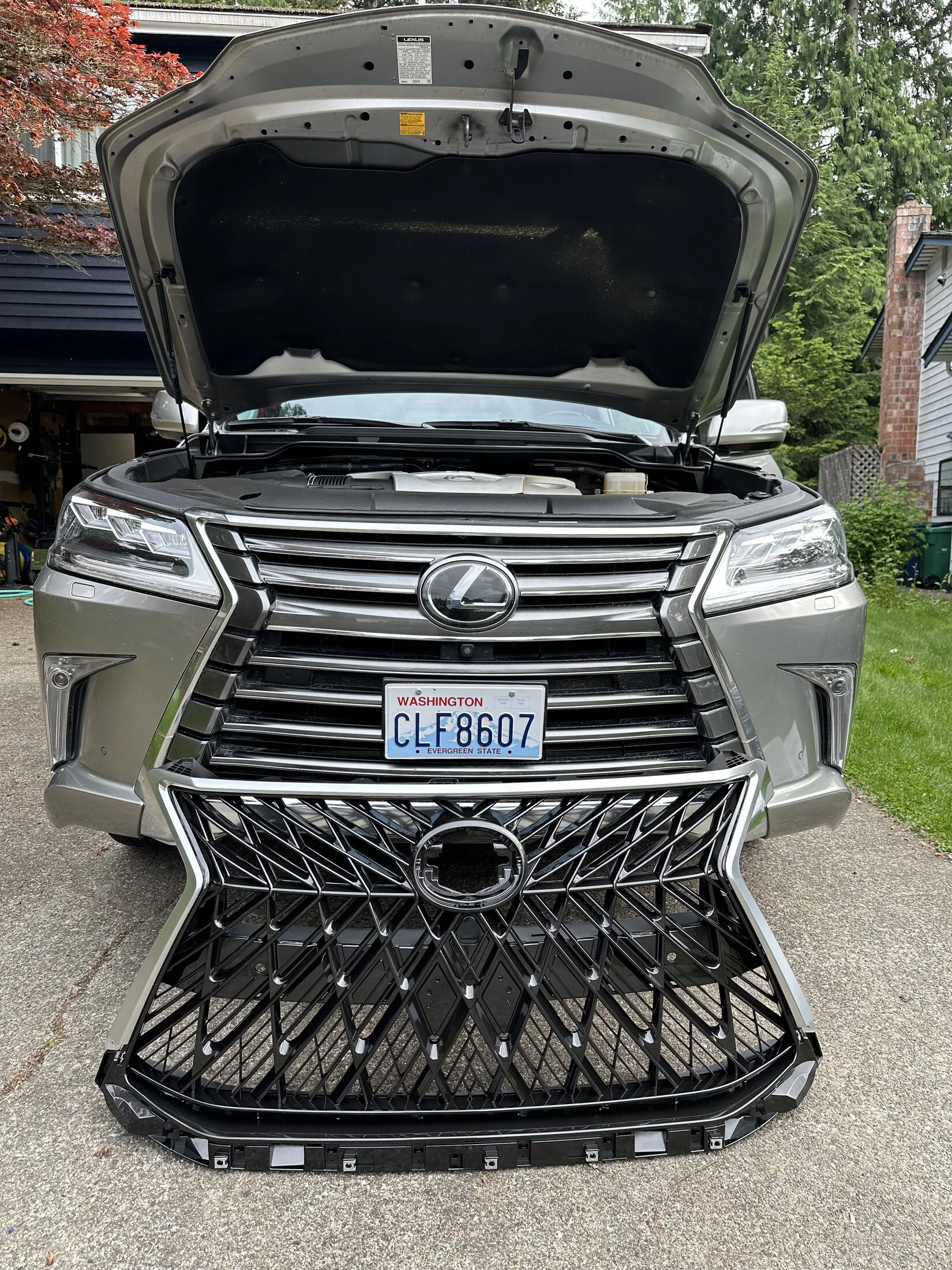

I’m pretty sure it won’t, but it lands Friday so I’ll try to carve out some time this weekend to see. Know of any tutorials on how to get the grill/front clip off?
I am cautiously optimistic.
Verdict is no unfortunately. The bottom trim is made for the 19+ with the lip and the one from the old grill doesn’t fit. Might work with a ton of effort but i don’t have it in me. On top of that, the materials are junk and the fit and finish totally suck. Not worth $370 and definitely not worth $500.
Oh, I will add, if you’re going to do the CBI bumper, this will totally work, the only real shortcoming other than quality is that bottom trim piece.
Thats too bad because it does look a lot better.
Thanks for sharing. I was interested in buying an ebay kit like this because I do like the newer grill more. I think I'll just keep my stock one and maybe black it out. So you know of any aftermarket lips for our year?
