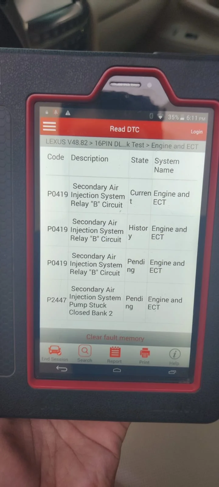

I have a LX570 2009 model. Got Check engine light, slip sign, and 4lo blinking. Managed to pull the below codes from scanner.
P0419: Secondary Air injection system relay "B" circuit
p2447: Secondary Air injection system pump stuck closed bank 2
