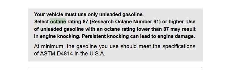

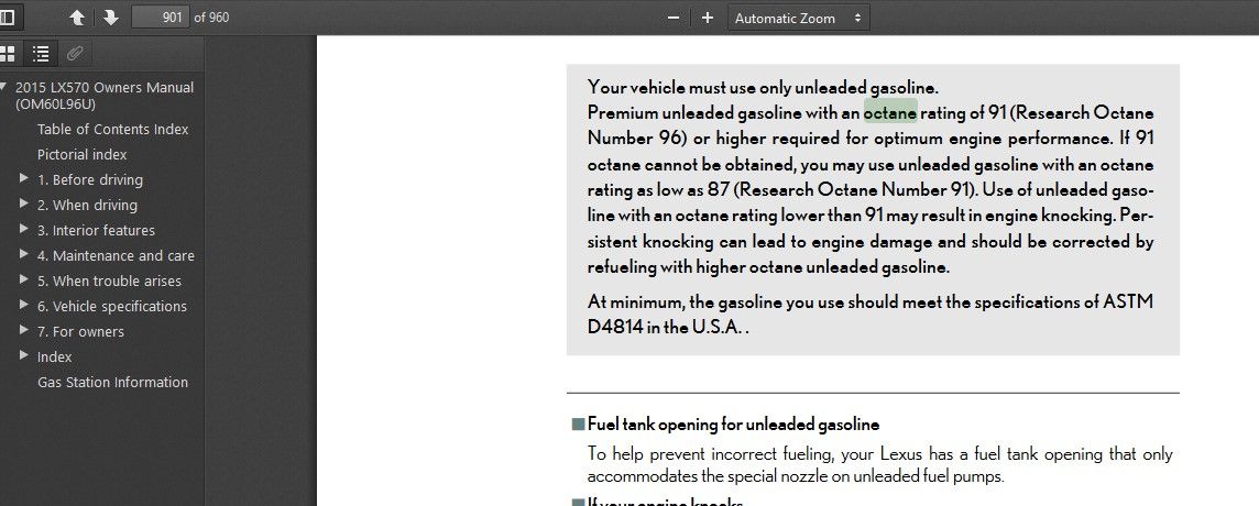

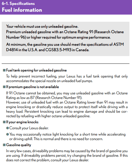

The main difference I see here is the LX says “for optimum engine performance”, whereas the LC does not.
It also says "use of unleaded fuel with an Octane Rating lower than 91 may result in engine knocking or drastically reduce output to protect itself while driving with a heavy load. Persistent knocking can lead to engine damage..."
I don't think many would reveal they've shot themselves in the foot and destroyed their engines because they tried to save a penny. This could very well be a case.

IIRC, the HP difference between the Lx and Lc is three (3) (380 v 383)
So, with regular in an LX you might knock long enough for the ECU to compensate by adjusting the timing to what the LC comes with and then you'll have 3/383 less HP which is roughly a loss of >1.0%.
I suppose the only caveat is "as long as your knock sensor is good."
To answer OPs question: regular wont harm your LX engine because of the miracle of technology and shouldn't void your warranty. If you get some knocking and/or a check engine light with a knock sensor code, switch to premium and get it fixed.
