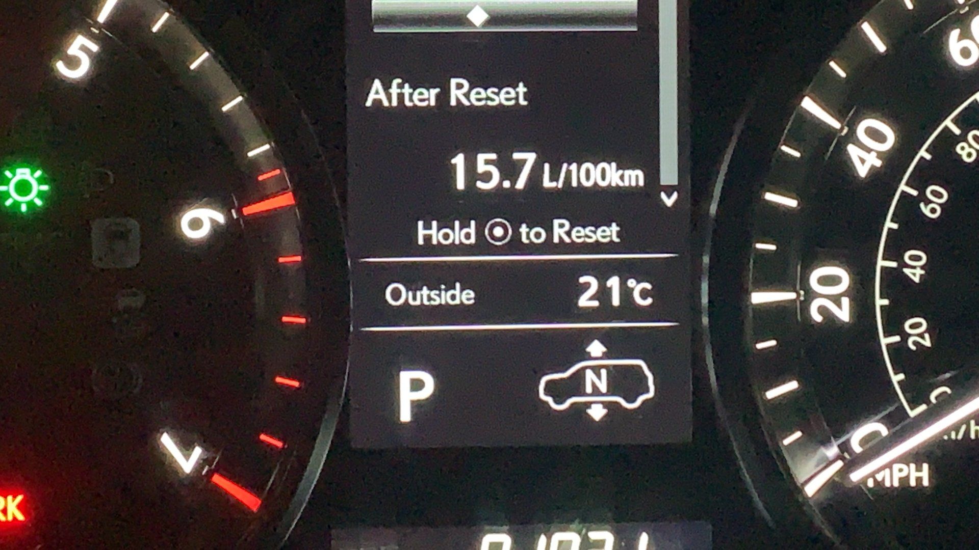

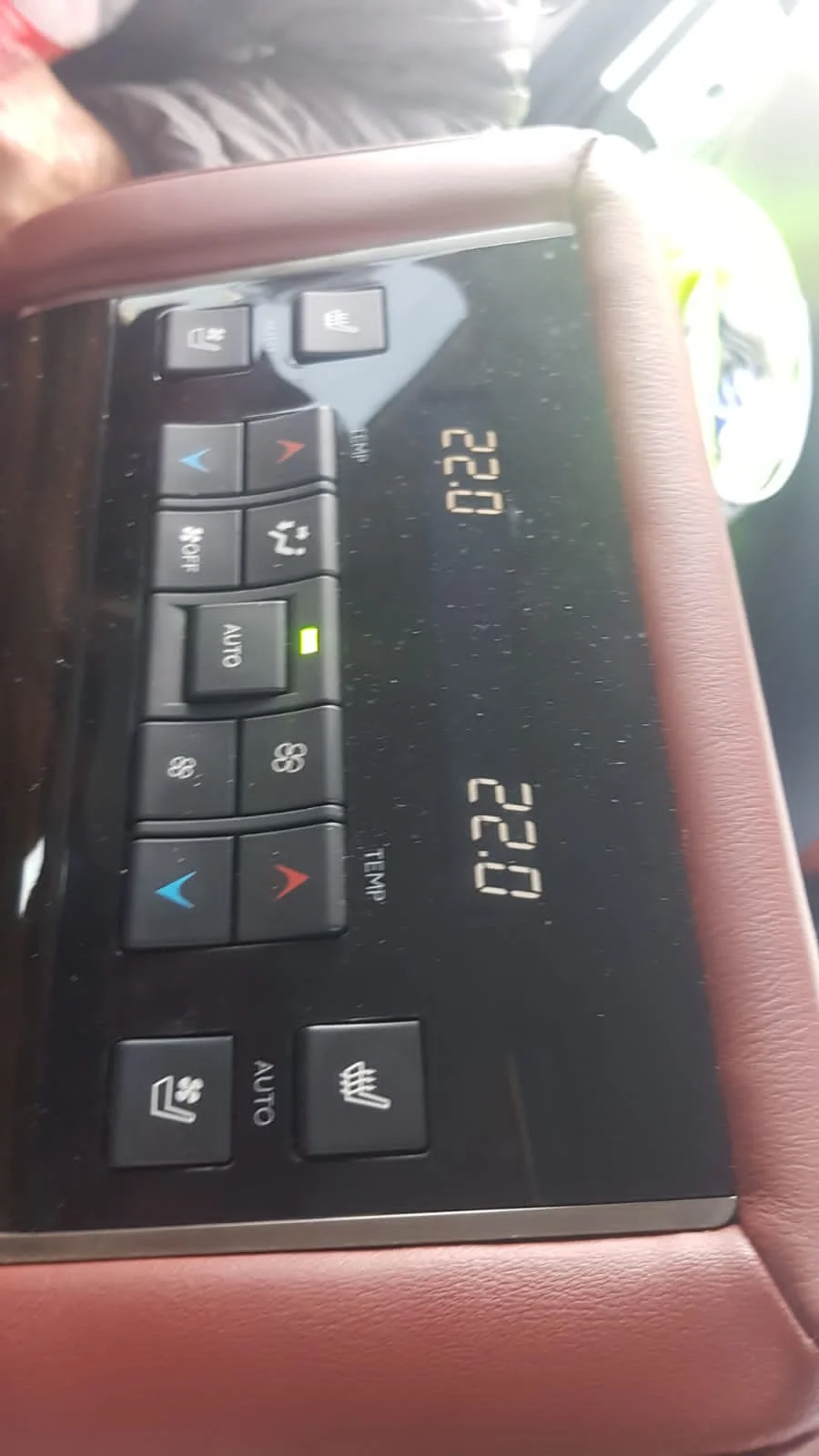

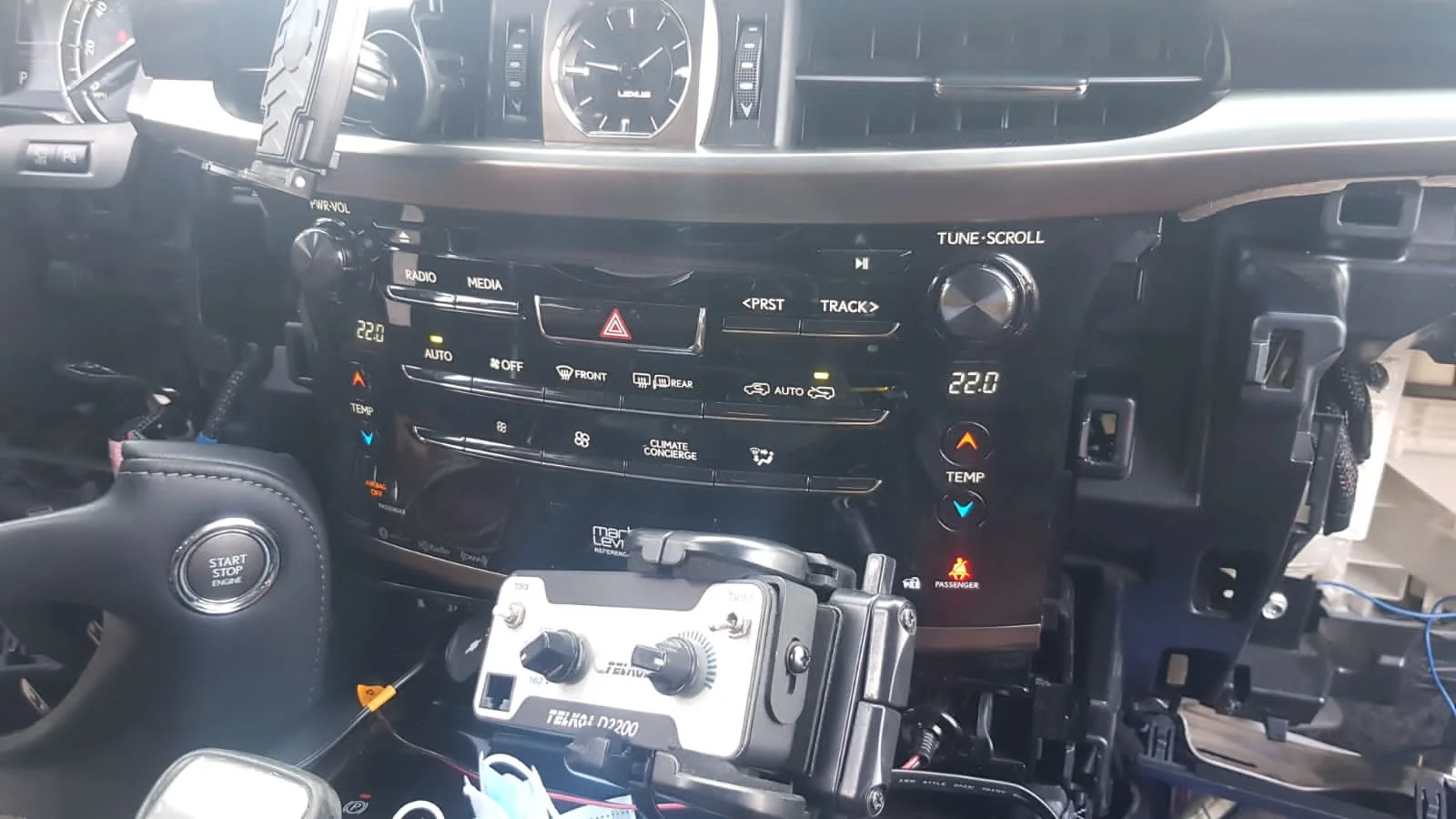

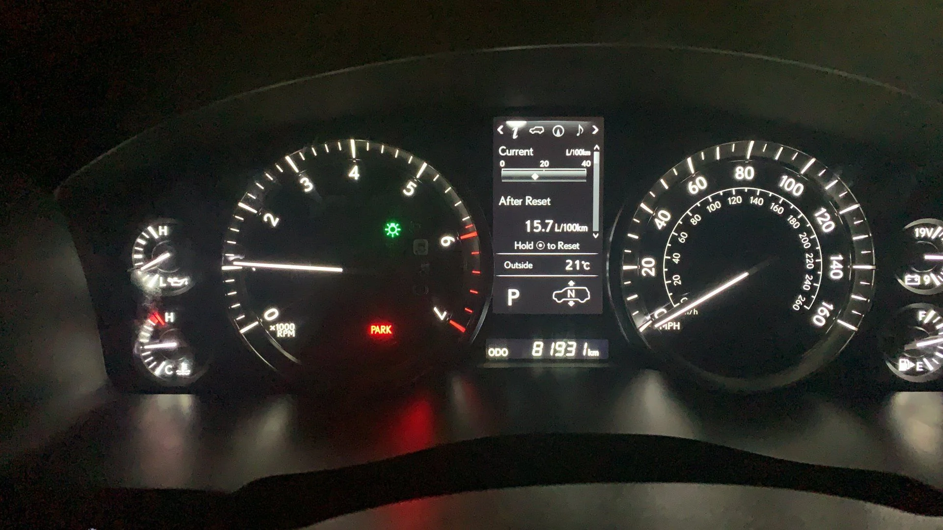

Good night everyone few months past and I did not let this down I can update that today I have managed to flash my EPROM on my main cluster so now I have Celsius showing outside temperature this has been done by burning European version software on my US car now the only problem is that my air condition still shows Fahrenheit but this will be also been taken care of next week with a small canvas filter which I have bought in Lithuania and I installed next week Sending a link of the product and picture of my updated cluster next week I will send a picture of the air condition display good luck

gd night friends I can update that I have completed the process of converting my Fahrenheit to Centigrade I have now a USA version lx570 which shows all temperature units in Celsius

it took 2 parts indeed 1 part is to flash the europe or canada software in the main cluster it means taking it to any dealer after you have in yoru hands the right eu or ca software and asking him to flash a very samall chip on the back of the unit it took a cluster specailist 1 hr and it was ok the osoftware i got from a russion guy in israel which has connection in russia to some one who does this kind of things daily to all the lc200 and lx570 for the air condtion to displain in all places in the car it took a small electroinc baord and some hrs of install and wall all ok
