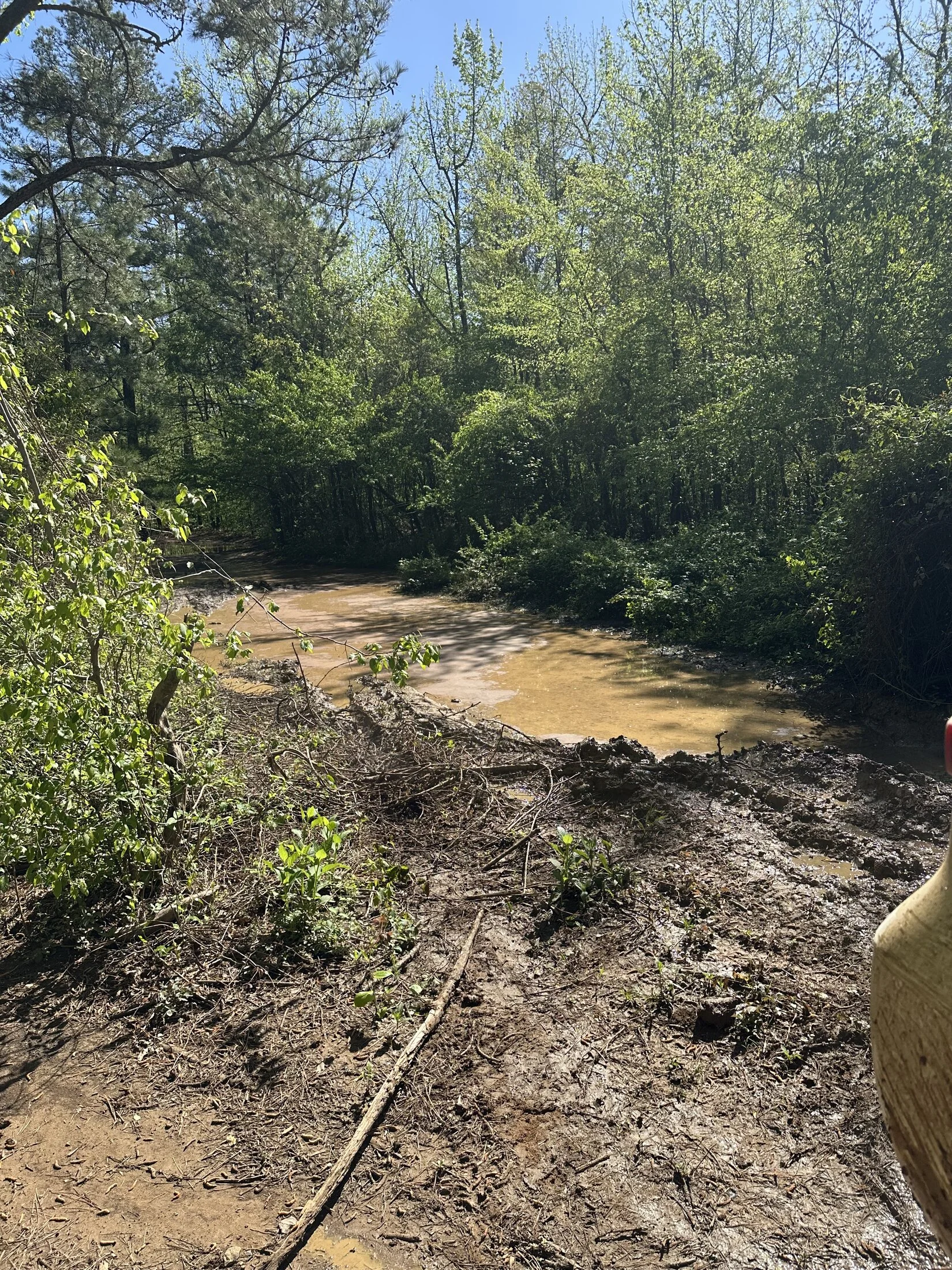

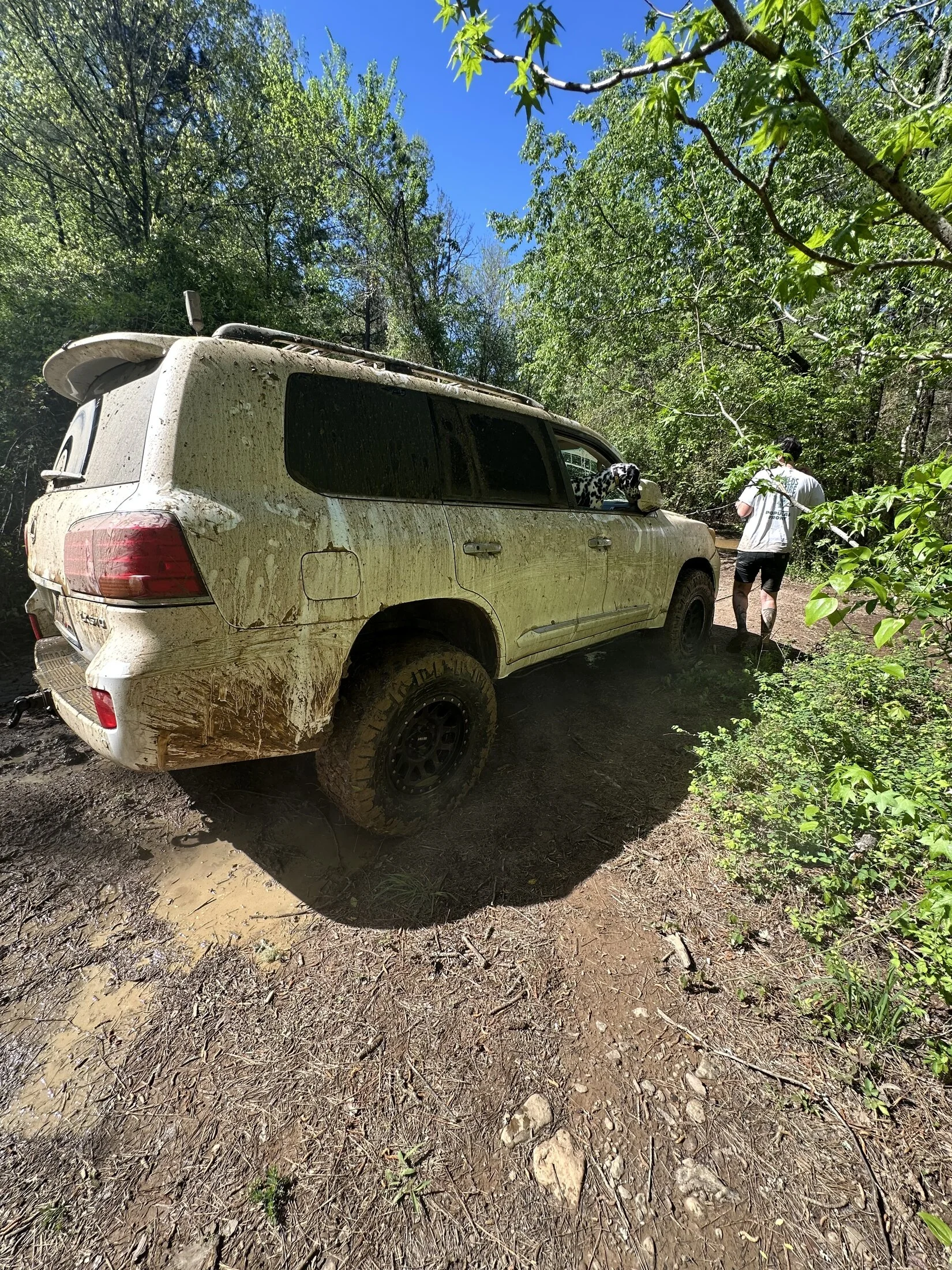

We were in Arkansas, Ozark National Forest over the weekend, 5.5 hours from home when I misjudged a hole, I didn’t think I could fit in the bypass without getting body damage on trees so we went for it and that a mistake…made it 3/4 way through and then found ourselves leaning to drivers side completely buried, battery light almost immediately came on so we lost the alternator quickly, luckily I was able to crawl out through the passenger side and winch our selves out. After another 30mins on the trail, multiple more mud holes and two river crossings we were back to a main road the Odyssey Extreme AGM Battery was now reading 11.5v and I couldn’t get 4lo to disengage. We limped to the closest mechanic I found (shoutout to Tim’s Auto Repair in Hagarville, AR) and he hooked us up on a charger and couldn’t have been more accommodating for the hour we were there deciding what to do next. Finally got it out of 4lo after turning engine off and restarting. Decided to book it to Toyota in Russellville to have the alternator replaced because no one local had one in stock. We then waited 24hours for a repair…got back on the road and immediately the electrical issues started, weird shifting patterns on the highway, interior lights flashing, no audio, door locks clicking and a blinking 4lo light. But the LX570 kept going 5.5hours straight home. I’ve got to strip it today and clean 30lbs of mud and silt out of the entire drivers side interior front to back.

Any tips on electrical cleanup? Drivers rocker panel was under water so I’m going to start there.
And when we got home I noticed a slight whirring noise coming from the belt, so I’ll need to diagnose that as well.

Bummer. Mud holes are fine, as are water crossings. Just walk them first if there is any question about depth or the invisible bottom (large rocks, logs, deep soft mud).
That’s true, I made a bad judgement call, I saw tire tracks on both sides and didn’t want to get wet and paid the price.

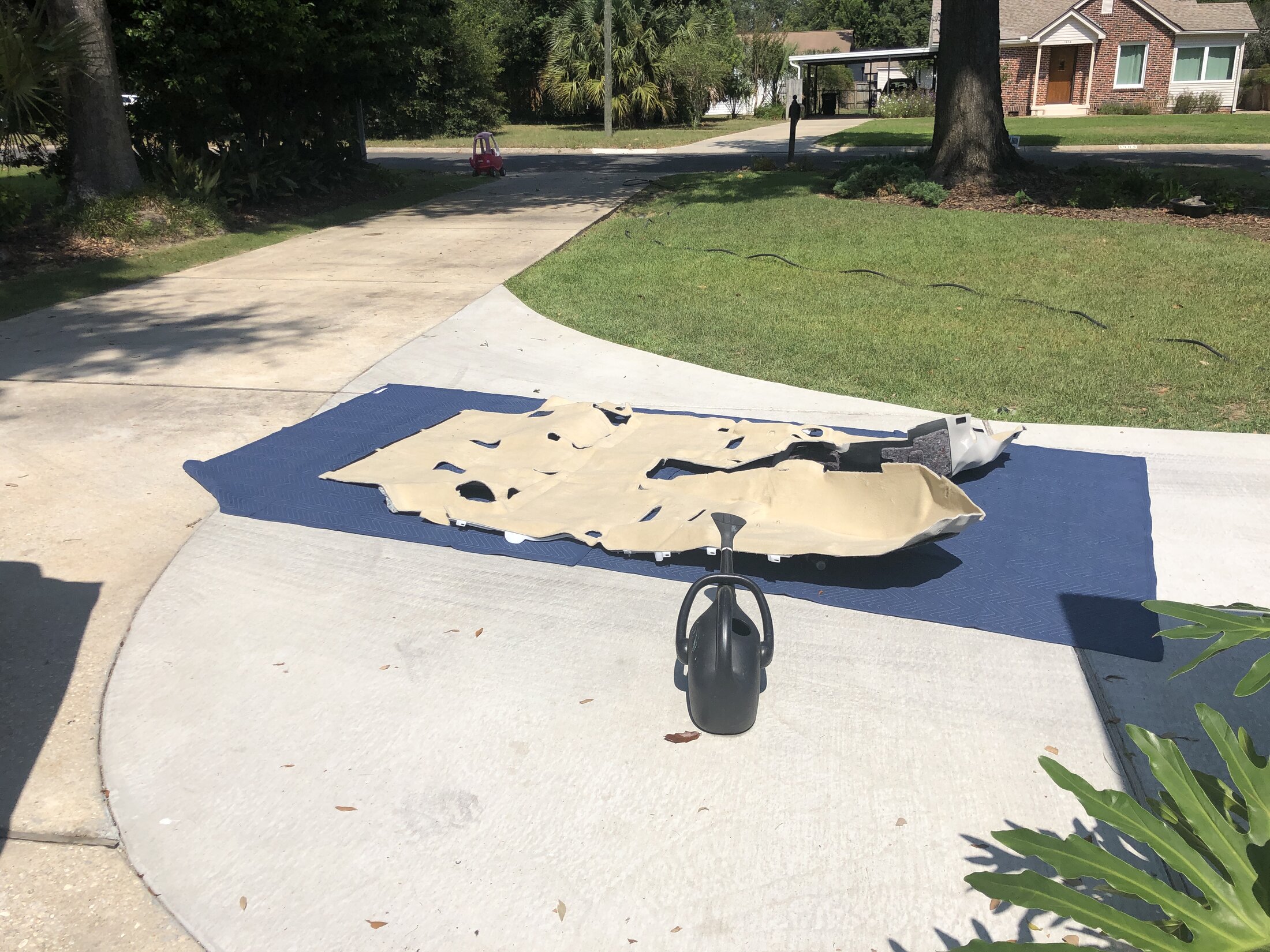

Best thing to do is yank carpet - you’ll thank us later. I did it a few years back, only issue is the connector to the cool box, which had to be disconnected and you’ll lose freon. With it out, interior will dry a lot faster. Yank the connectors and deep clean them. Dont half do it though, yank that carpet. Let me know if you need some pointers!
I’ve been contemplating this all day…and I think you’re right, everything seems straightforward except around the console, how much of that did you have to remove?
