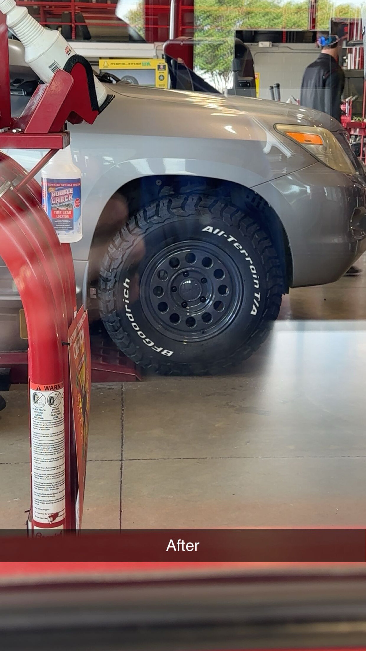

Okay, time for the post service update!
It doesn’t even feel or drive like the same vehicle. The AHC being serviced has proven to be immediately worth it. I still don’t think it’s as comfortable as my LR4, but I blame the E rated tires for that. Shifting has become much smoother, and the engine just sounds cleaner. No longer do I have a harsh 2-3 shift. Ended up replacing the washer fluid pump and have that serviceable in all areas again.
34” tires, 285/75/17 K03
I’ve done a sensor lift on both front and rear, though the rear sits taller than I’d like and I might undo the lift, but I haven’t done a trail shakedown yet so gonna leave it until science is involved.
Man leaving discount tire was a riot, honestly laughable at how bad the rub was. The ride height, comfort, and weight of these tires is entirely noticeable. I went from ~15mpg mixed daily commute to currently 12.5, though there has been a lot of stop and go traffic. Killer on this big rig. The wife loves how it rides now and is excited to be in it compared to the bumpiness it had before. Admittedly I’m slightly disappointed in the noise the K03’s put off, I’m hoping that because the tires are so new with less than 200 miles on them they will get quieter as the sharpness of lug edges goes down. Noise starts at about 20-25mph. Goes into a rhythmic at about 55 and never really becomes LOUD, but running 70-80 it’s there. Speed variance has changed a bit, I find 60mph roads I sit at about 57 if I’m pacing. As speed goes up so does the inaccuracy. But nothing major.

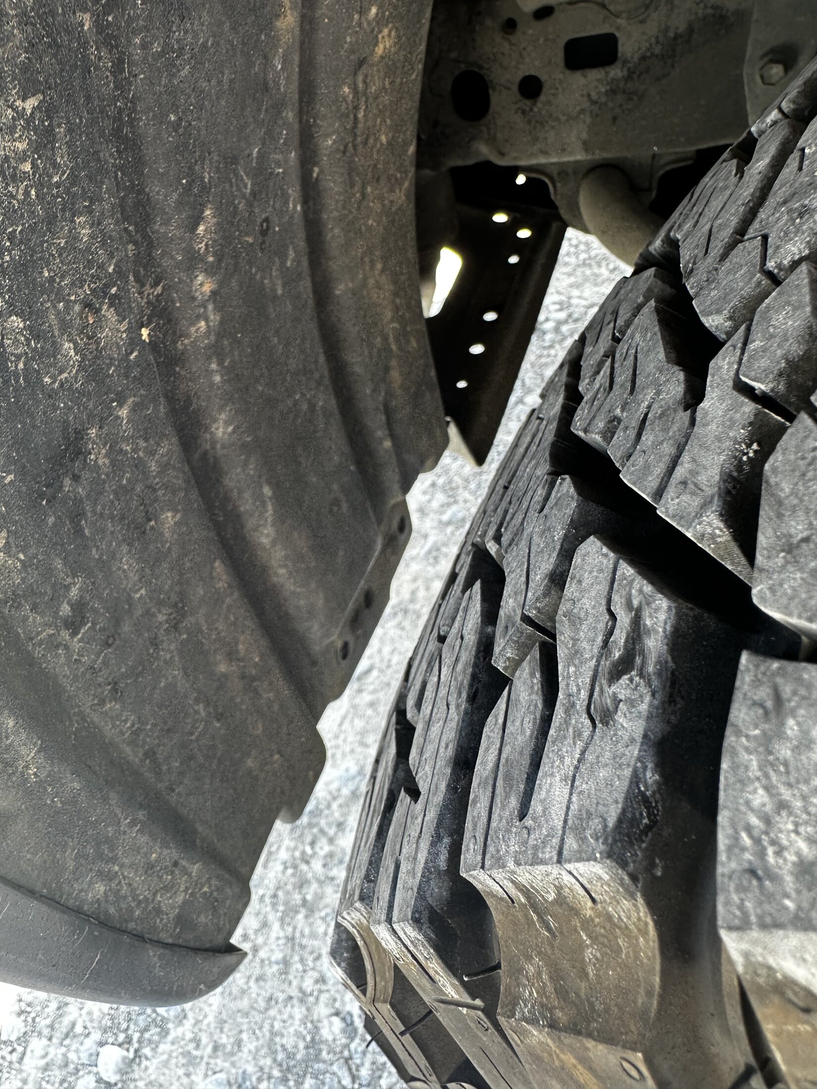

Back of front wheel well
Had to cut a small portion of the side steps off. You can just tell that it’s rubbing fender liner just above, haven’t had to time to heat gun massage it out. I actually stripped and broke a bolt on the drive side, and the rub was so bad that it pushed a clip out underneath the driver door. Popped it back in and started cutting, no real damage.
Front of front wheel well.
Removed the 2 bolts and the flap? That exist up there. So far that’s been a pretty bad rub, the flaps were wearing down. Even with the flaps gone, there is still a good bit of rub on that liner at 80-100% full lock.
In reverse start at 75% lock you can tell the lugs are catching the front of the wheel well and dragging just a bit. In time I’ll get it, for now I just park in easier access places. Nothing major through any of that though.
You can unbolt the liner on the underside and drill new holes pushing it forward. Works like a charm.
This. I pushed mine forward like 1.5" and did some remolding with a heat gun. No rubs with 35s
Sounds like ive got a simple little project for this weekend.
what did y'all do for the liner in the back? just heat gun or relocation?
You don’t even have to drill new holes, can push it in one hole width and just use the existing holes. I do remember something with the z clip though sits been six years , fuzzy memories
Looks like you already bent that little bracket out of the way. I did a little heat gun to the liner and then zip tied it to the bent bracket as well
