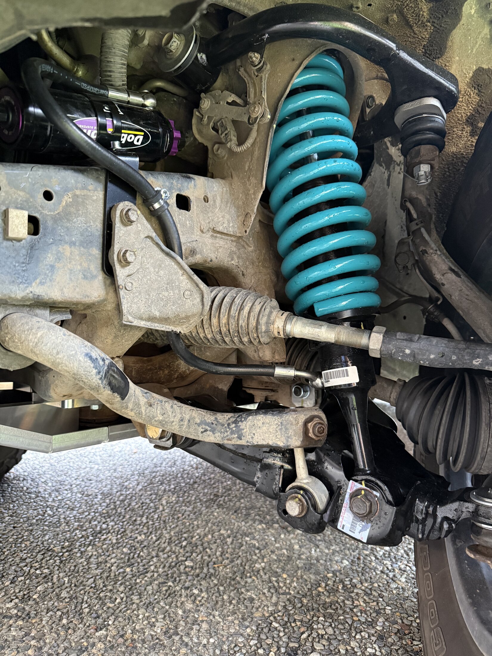

Hi, I'm looking for a recommendation for an upper control arm that is compatible with the Lexus LX570 AHC system. I have seen Expedition Overland create the J201 Concept that used a billet Icon upper control arm and made a bracket to attach to the AHC hight controller. Ideally I would like to run a similar set up with at billet upper control arm that has the AHC connection. Thanks
What's wrong with an OEM one?
Nothing wrong with oem ones they have lasted 100,000+ miles but looking to replace. Planning on doing AHC adjustment and oem spacer when refreshing front suspension. Figured a billet or tubular upgrade would be a good addition
The SPC UCAs I used when deleting AHC have a hanger for the height sensor. I used it to retain AFS.
