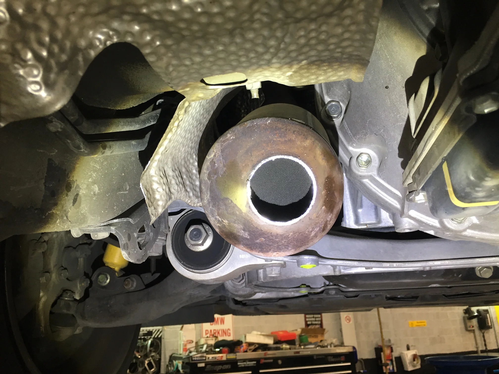

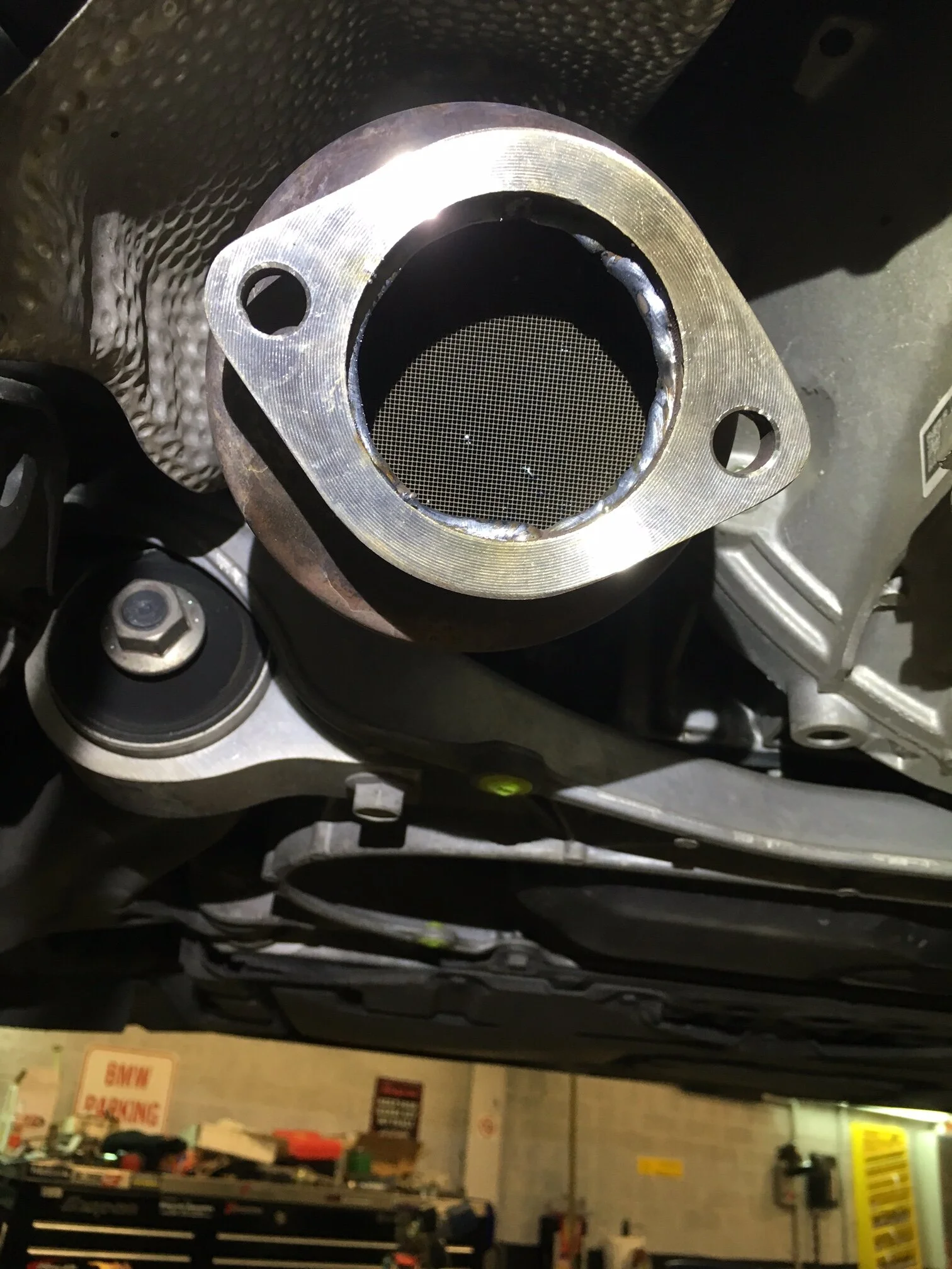

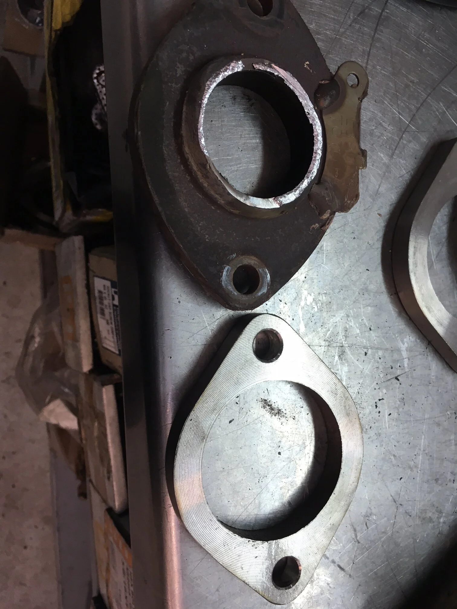

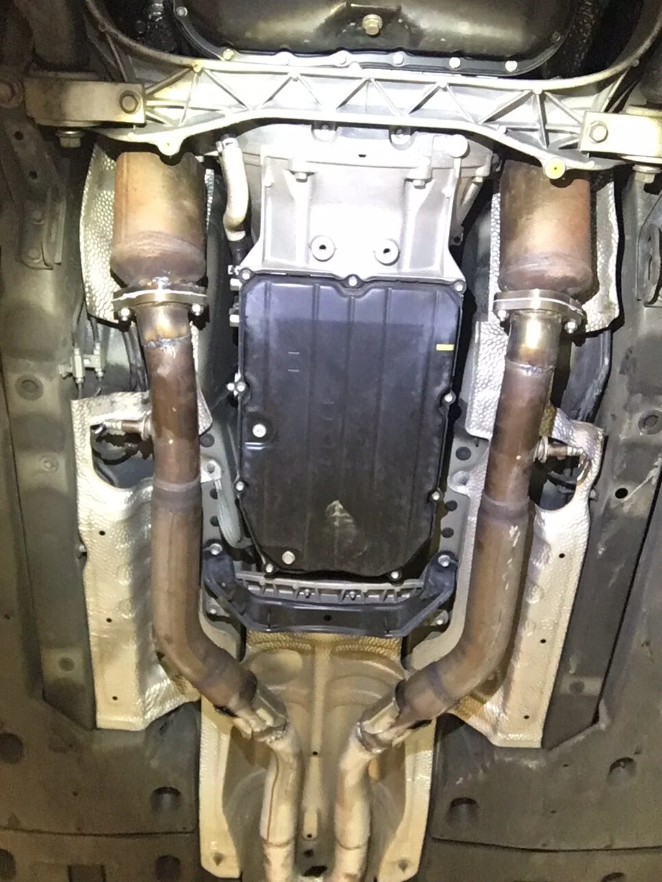

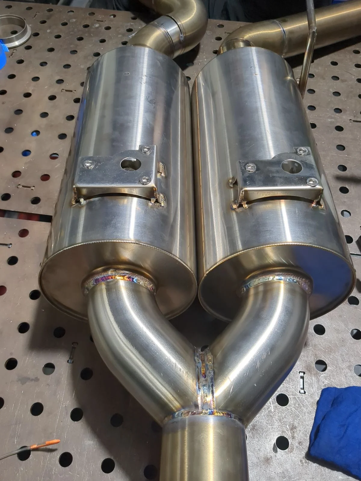

Here are some photos of the exhaust I put on my previous Lexus ISF. We widened the exit from the primary cat, and it made as big a difference as installing headers on the dyno. Will be doing something similar, custom with a varex muffler so it can be quiet and loud as I want it, when I want it. Can program it off throttle position etc.
So a tune would complement the exhaust work perfectly.

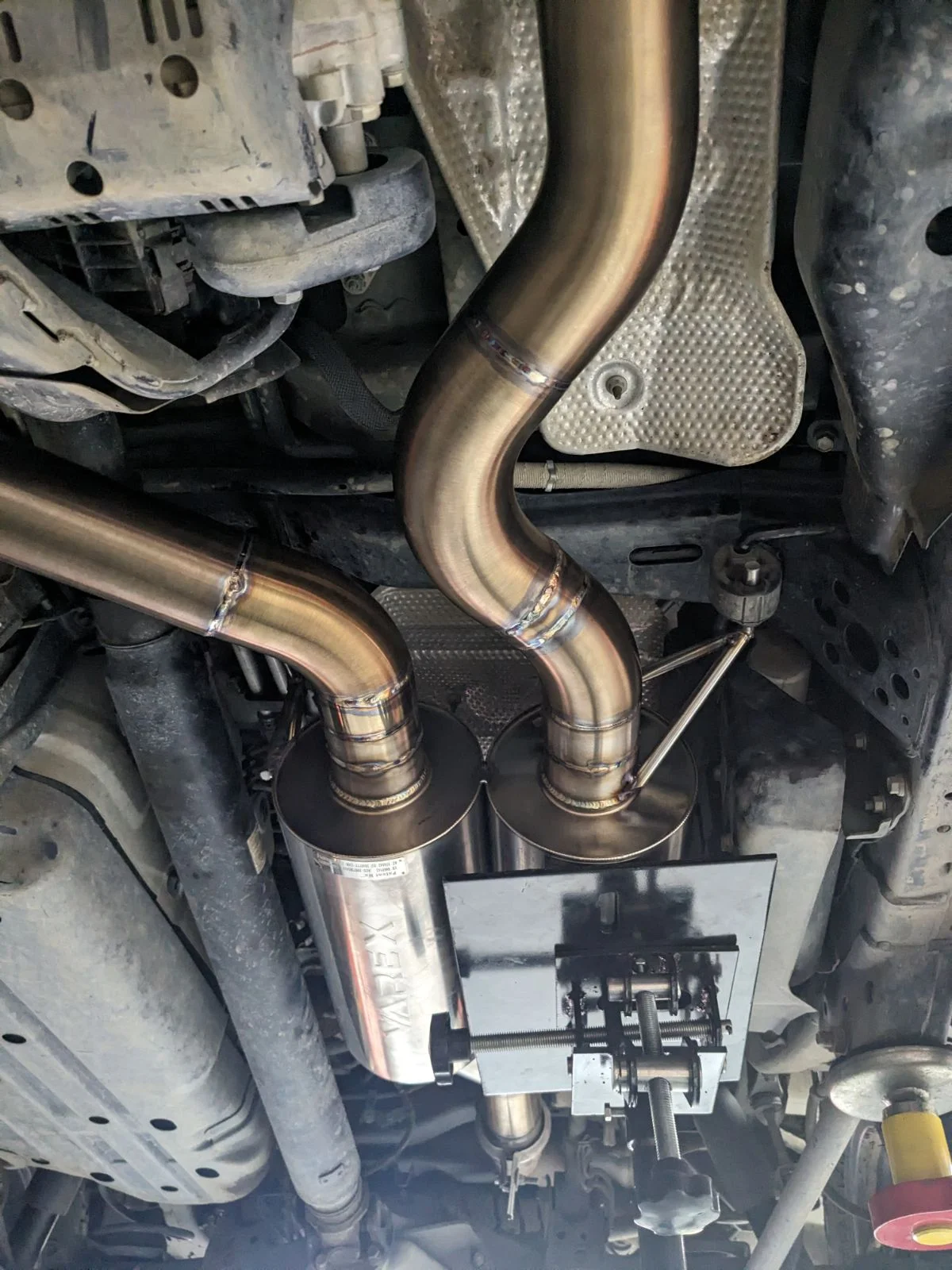

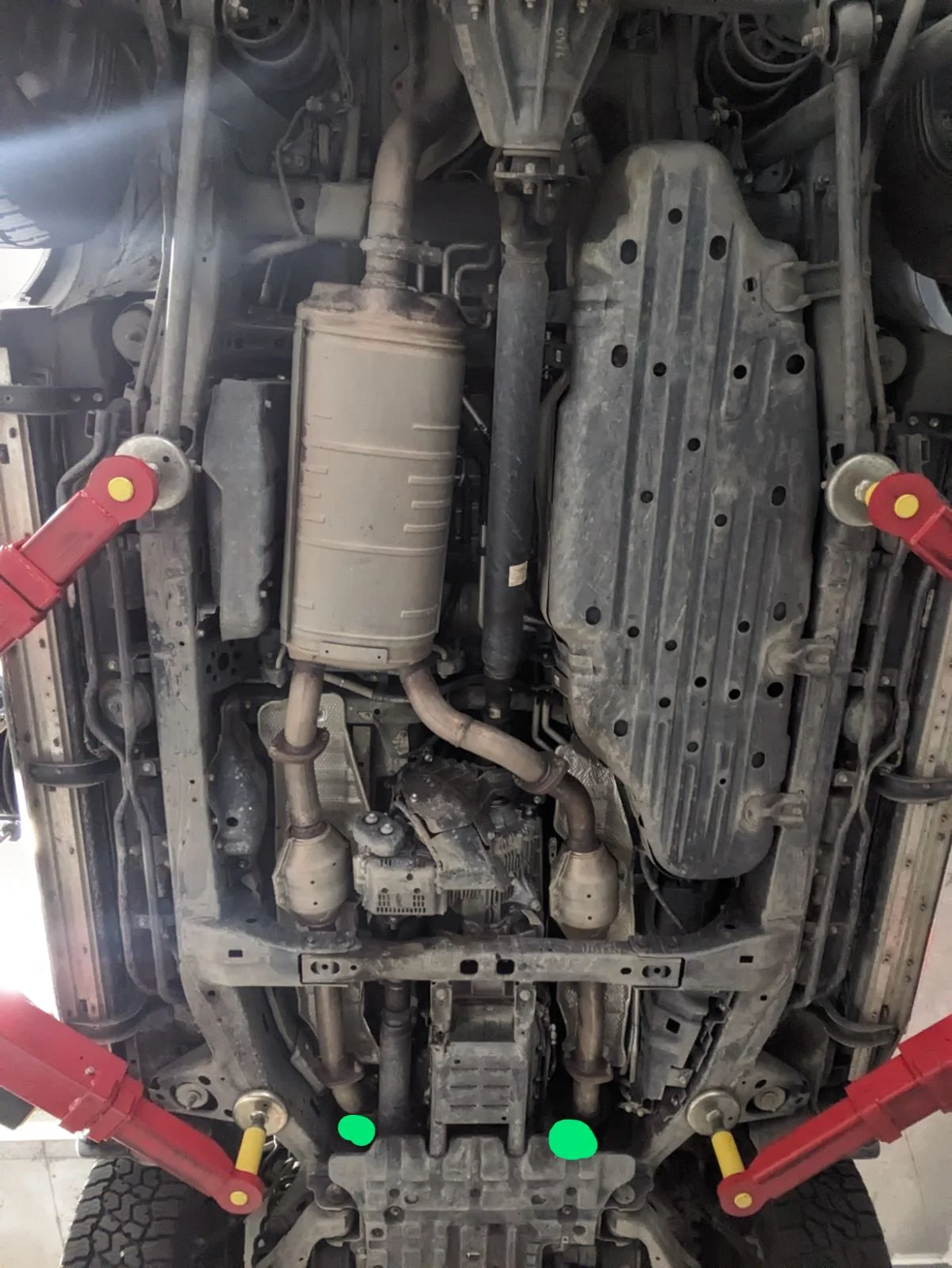

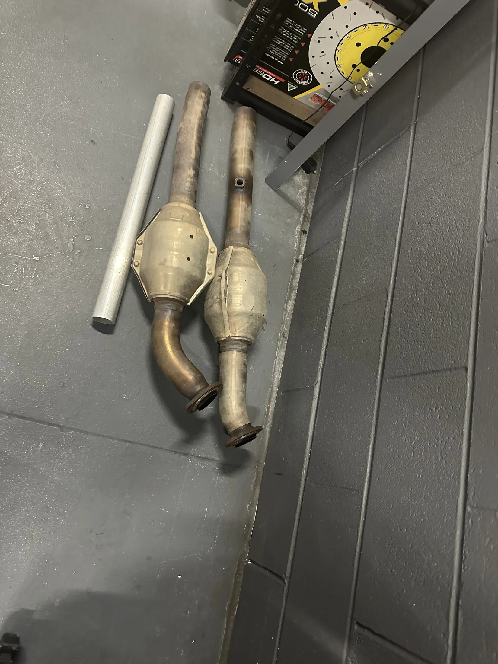

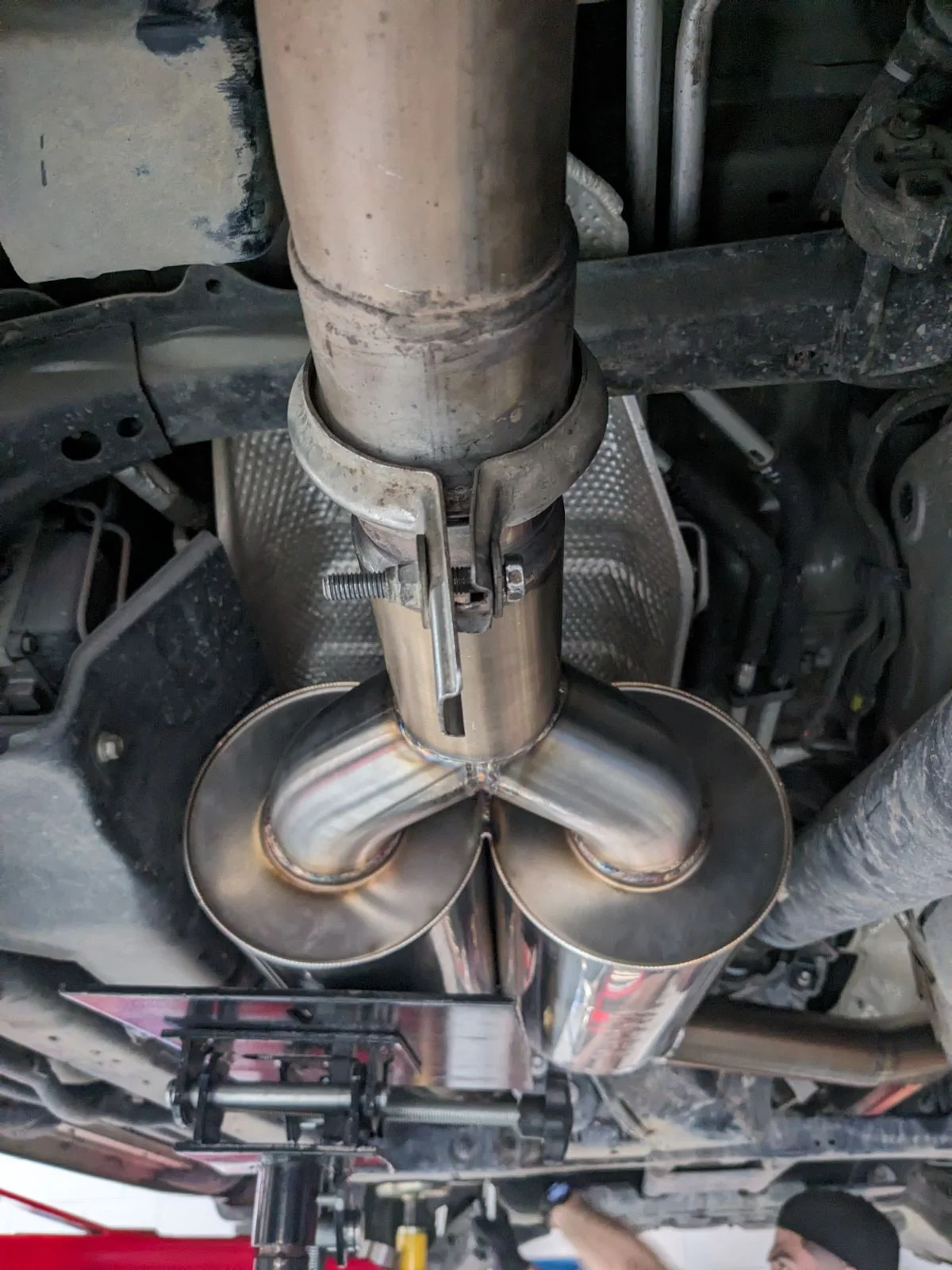

I couldn’t get close enough to the flanges on the primary cats in the end, so just made a custom primary cat back system.
I wanted it stealth so used a valved quiet / loud system, with the stock tail section. For what I wanted, it’s absolutely perfect. Great meaty tone when valve is open without being obnoxious, and stock sounding when valve closed. It’s perfect for me.
We tried to make the pipes equal length from the manifolds, and it made the sound much better. Search you tube for “equal length exhaust”, plenty of info out there.
