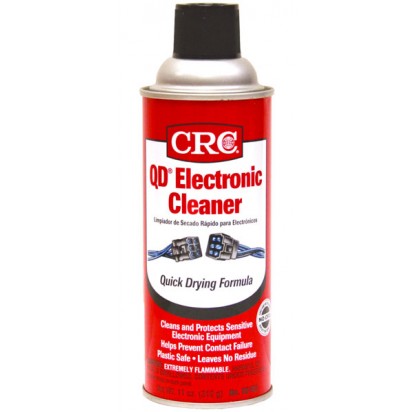

get a can of electric clean or contact cleaner, remove all fuses and hit the fuse terminal blocks with this spray to clean things up. this may not fix the problem but it's good PM anyway and it looks like you have some crud in that fuse block.
I will get some contact cleaner and clean that up! Also ITRJ is spot on, the 100 amp box is also empty in my 01 LC. I tested the red and blue fuses and while the red alternator one was giving me consistent reading the blue JB one was very inconsistent. I'm going to pick up a couple new ones when I get the electrical cleaner and replace them both. Hopefully by then the battery is charged back up or replaced and we can go from there. Something tells me this problem isn't as simple as a fuse swap though. I have a feeling I'm not done screwing around with this.
