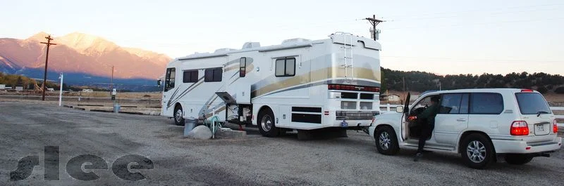

Here's the unexpected challenge. We bought the 100 in part to tow behind an RV. I know it's no problem doing that. Many thanks to Christo Slee and others for proving it. BUT, we really want to replace the stock front bumper with something better. I assumed this would be simple, but it's not. The reason is that Christo told me today he knows of no way to install both a replacement bumper and the necessary hardware to hook up the tow bar to the front of the 100. I asked if there was any way he knew of to modify an ARB, Slee, or TJM bumper to work, and he said no. I figured if anyone knew, he would. Maybe it's simply not feasible. I'd really like to find a solution though.
