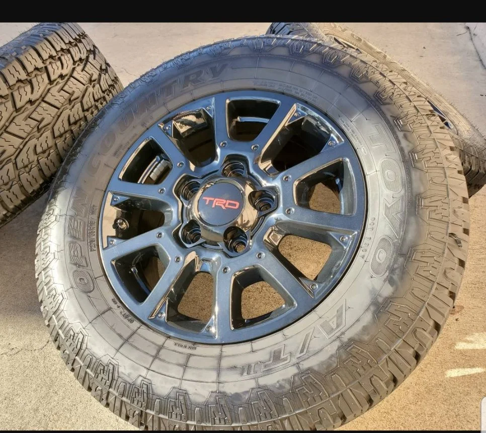

Hoping for a quick answer here. I did search around the forum (candidly only a few threads) but I am trying to find out if oem lx470 lug nuts work with tundra TRD wheels (pictured below). I am not currently running spacers so no dust cap on the front until my spacers arrive.
From the search it looks like they don’t but I did see some conflicting responses so I figured I’d ask just to be sure.
If they don’t, it appears that any 08+ tundra lug nuts will work. Is that correct?
Thanks in advance.
I have the same wheels on my 2001LC and used the original lugnuts
I believe they are the same on the LC and the older style 5 lug Tundras.
Also - you dont NEED spacers. You can just persuade that front dust cap with a mallet and trim the back of the beauty cap on the fronts.
