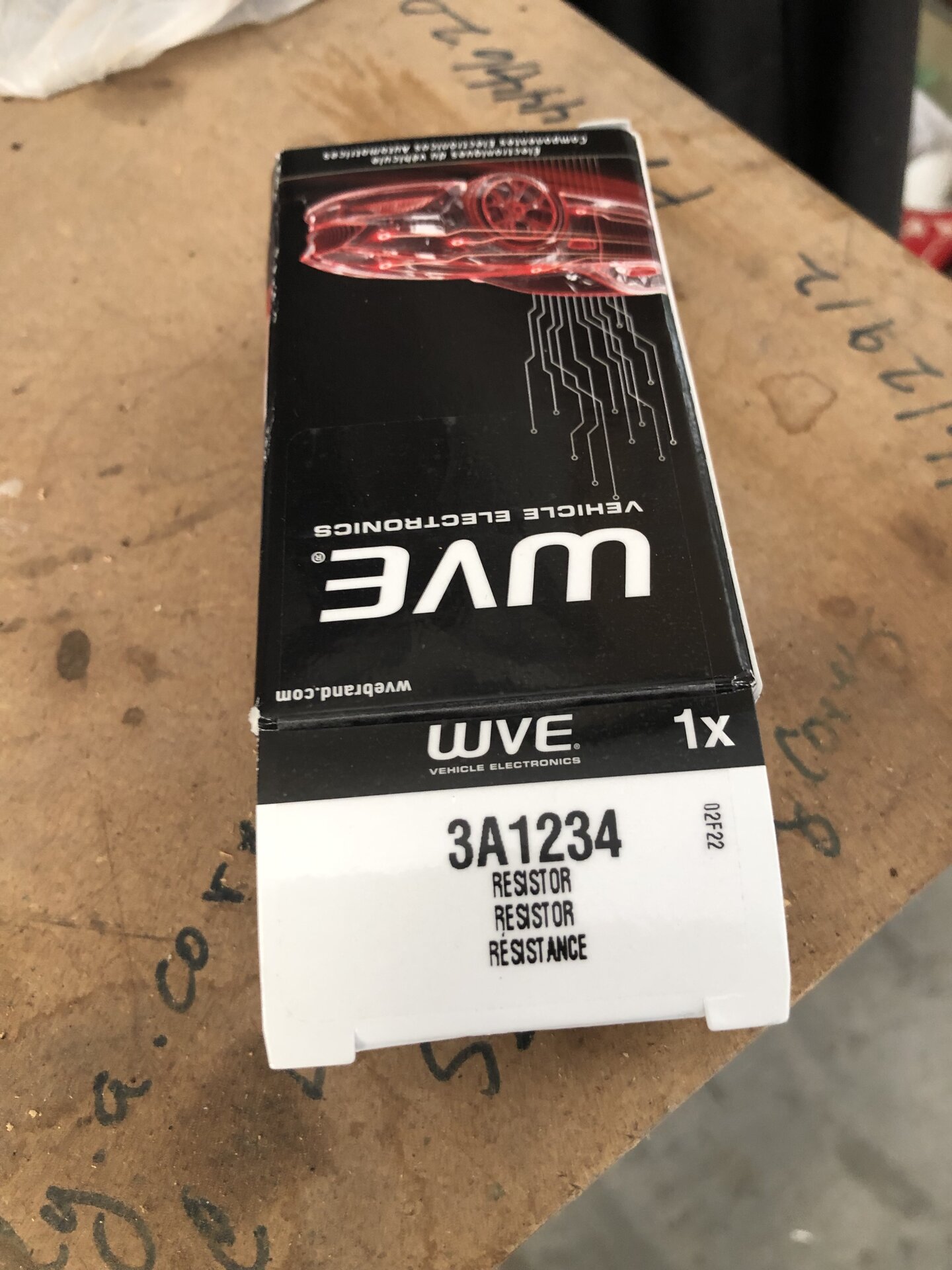

I started with cheaper and availability parts for the fix. Removed and tested the ‘Blower Resistor’ and tested the resistance per the FSM. The resistor tested way out of spec and a new part was ordered. $34 at rockauto made by NKG and was a direct fit. Part # WVE 3A1234
Blower Resistor replacement was a partial fix. Now had fan speeds of ‘high’ and all the rest L, medL, med H would only blow at low speed.

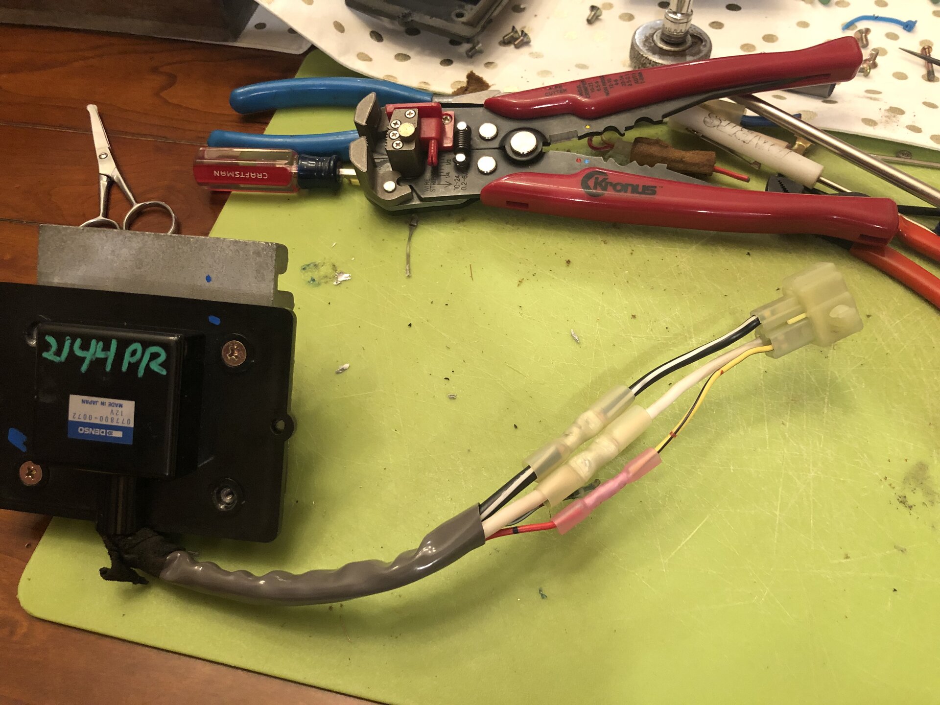

Next suspect is the A/C power transistor. Part easily removed from behind glove box, Denso 077800-0111. Could not find the exact match, -0111 part from any source. An eBay search found Denso 077800-0072 from ‘92 LS400. The -0072 has a different wiring harness, having 4 wires and 2 plugs. The -0111 LX450 part has 3 wires and one plug. Cut the pigtails off each and swapped with butt connectors. White-white, black-black, and red-yellow. Taped off the 4th (green)wire not connected to anything.
Plugged it in, tested, screwed it back in place, put glove box back in and have enjoyed having access to 4 fan speeds again.
