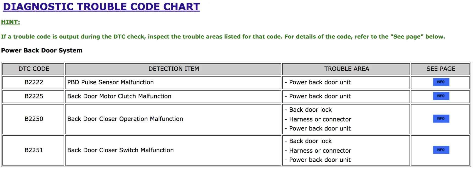

Do you have a Techstream? There are a few codes the system can set:

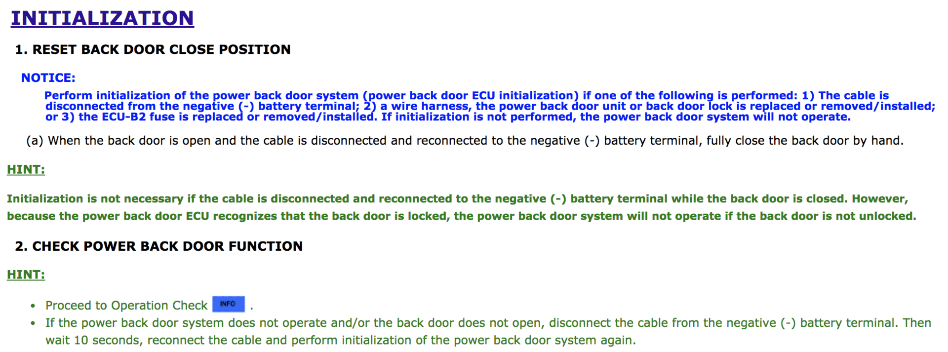

There is an initialization procedure:
I do not have a Techstream. The initialization info is intriguing, especially since the battery was replaced 1 month before I bought it. That is definitely my next move. That would be sooooo awesome if that's it!
Yessss!!! Initialization was most of the problem. Now it will open or lock with the exterior hatch button so the latch and button are good! The power portion still does not work for open / close. Dash button, key fob button, and close button on hatch all result 2 short beeps, which is different than before.
Thanks for posting the initialization procedure. Was about to tear the whole assembly apart to figure out what was wrong when I though maybe I should search first and found this and all works perfectly now. 👍
