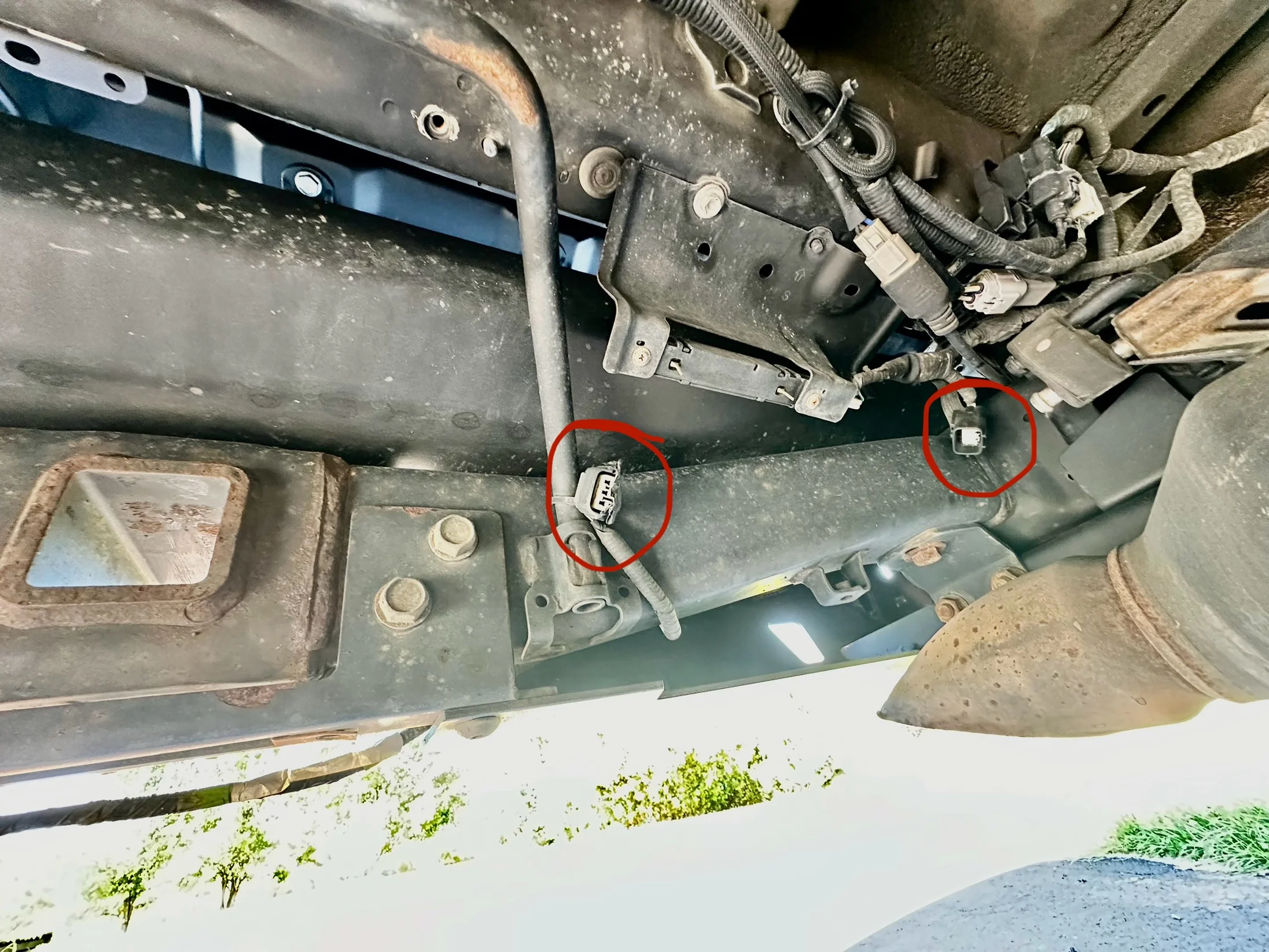

2015 LX570 very similar power tailgate problem. It worked as recent as a week ago, and now inoperable. It used to close when pressing the button on the tailgate, and it would open and close with the dash button to the left of the steering wheel. What troubleshooting should I work through? Should I get Techstream? What are the plugs circled in red for?
I have already done the steps to reset the ECU by disconnecting the negative battery cable etc…
Current symptoms and behavior with the power button on showing red:
  1. Engine on, pressing and holdingdash open button, I hear the lock mechanism making noise and the motor trying to work. Ultimately this does not open the back door. Next I press it again and now all I get is a long beep.
  2. Key in pocket/ engine off: pressing rubber latch button to open tailgate I can hear the lock working, but nothing else, when I manually open the tailgate and it gets about half open it makes a long beep noise
  3. With back door open (struts seem week helping it up, but it does hold it up) and I press the power button on the trunk, it makes a long beep
  4. When I close the trunk manually I can hear the door lock motor working to pull the tailgate closed.
  5. With tailgate closed, and holding the open button on FOB, the rear taillights flash once, short beep, followed by long beep.
