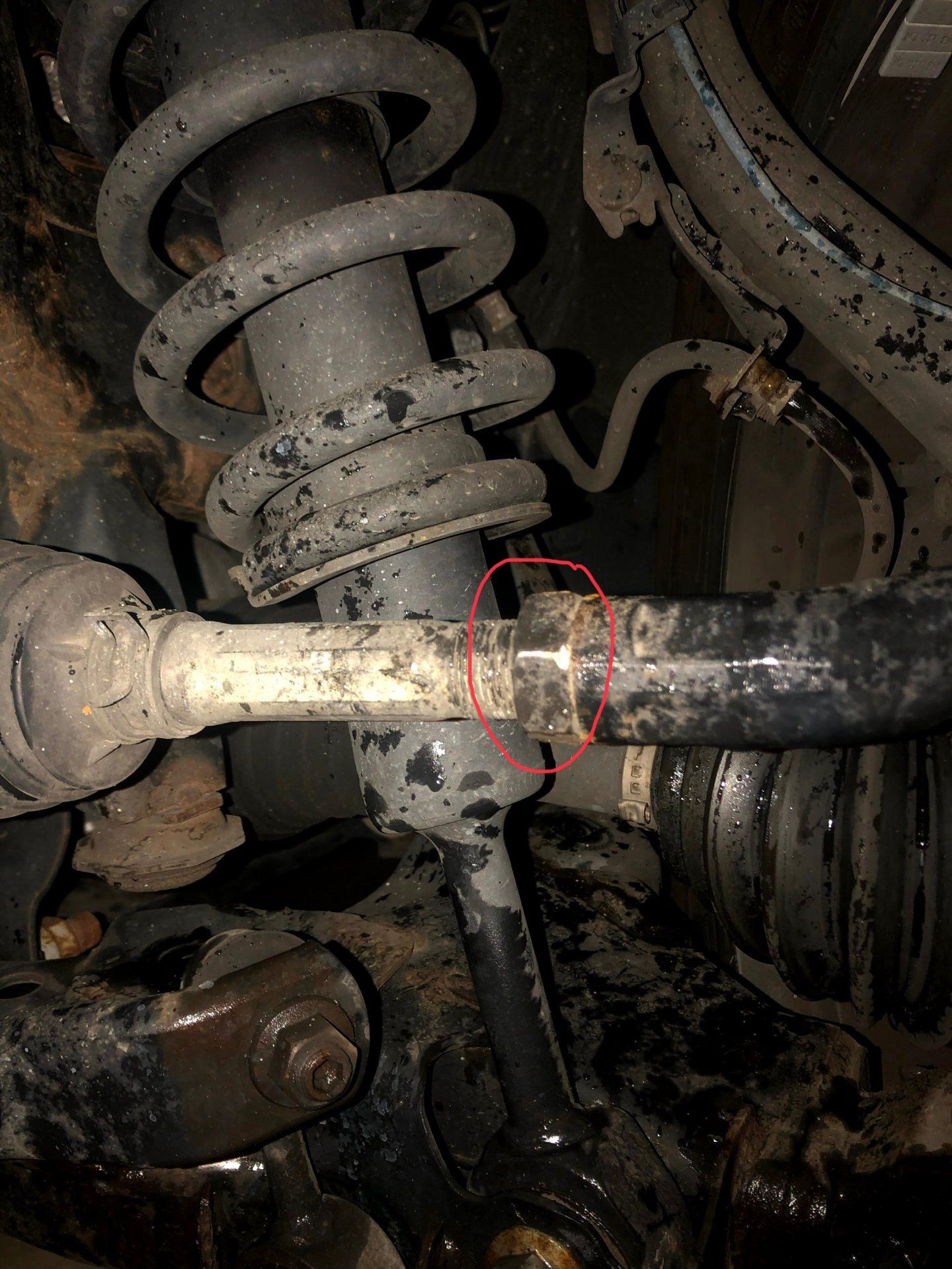

@nwfl4runner @hickuptruck So, I am relieved, yet pissed 😡Something definitely felt "off" with my steering over bumps for the past 3 months after an alignment from a Lexus dealer. Steering wheel was twitchy over road irregularities and the front end felt loose. I took it back to them for another alignment as they claimed their alignment machine was out of wack, no success same thing. They said they checked the front end and everything was tight. Got reimbursed. I took it to my Indy who also checked front end and did an alignment. Same thing. Took it to a local highly rated shop who also checked front end and did alignment with Hunter Elite Touch and same thing. That’s why I began researching on replacing my whole front suspension with new parts as I felt something must be worn. A couple of days ago, I became curious, lifted the truck in high mode and began feeling around and tugging on arms, tie rods etc. Low and behold, I found the drivers side tie rod nut easily turn with my finger! How could a Lexus dealer AND two shops miss this??!! I took it back to the shop, pointed out the loose nut and they realigned. Wouldn’t you know, it’s much more solid now! Unfortunately, they didn’t get my steering wheel dead center so when I hold the wheel straight it drifts left so I will take it back yet again! What a nightmare I’ve gone through with this.
After they do it, might suggest you grab a paint pen and just mark everything. Makes visual checks easy (dykem cross check works)
