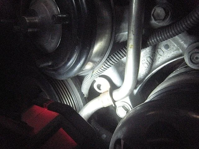

Had any service work done on it like a timing belt, water pump, alternator etc?
This is what an excellent mechanic asked me when I finally found a place that fixed my 100 series LC that did almost the same thing.
It's not that I think a bad timing belt would be causing your symptoms like the dash going dark. What I'm suggesting is that you might have an issue due to service work damaging or bumping a wiring harness loose. And it wouldn't have to be recent either.
So how could replacing a timing belt and water pump result in the car dying suddenly and unpredictably?

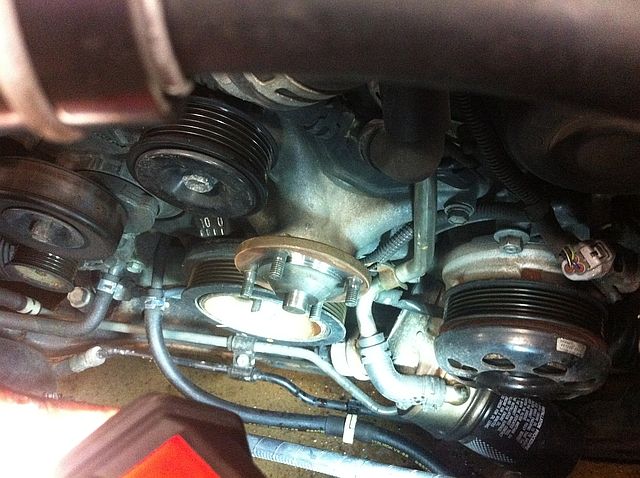

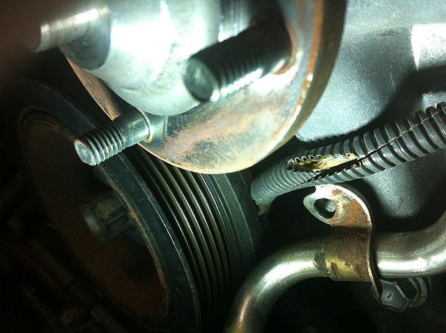

What happened to me on my 100 series was that the metal shroud at the base of the fan slowly wore through the wiring harness to the crank sensor 2 years after the replacement of a timing belt & water pump. It turns out that the mechanic didn't attach the wiring harness properly leaving the wiring bundle to slowly wear through. When this bundle made contact with the shroud it shorted causing the LC to instantly stop; it might or might not restart.
The computer also threw all kinds of random codes indicating cylinder spark issues depending on where the engine was when the short occurred.
My poor wife had to get towed out of a busy intersection at rush hour. I had it die on the Capital Beltway commuting to work in rush hour.
It took a long time to figure it out and fix.
These types of things are no fun and dangerous.
