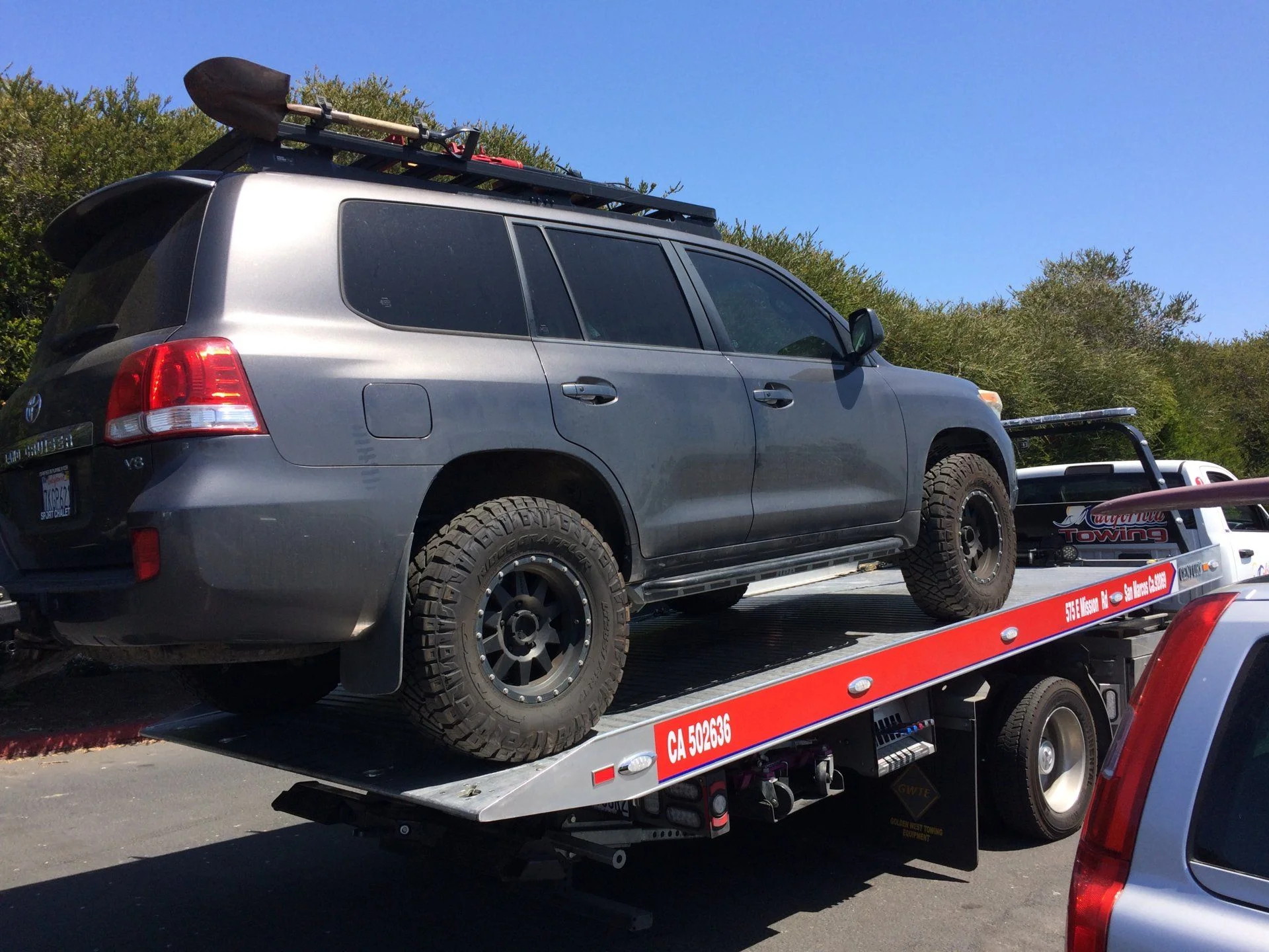

I just experienced the infamous 1/4 tank fuel sender issue. I have a similar pic of my rig on the tow truck since I also ran the tank dry thinking i still had a 1/4 tank left.
Its a bit annoying of Toyota since the tow truck guy said he sees this all the time with Tacomas and Tundras. He knew exactly what it was when he can to help me.
I Just got it back from my local truck shop $900 later. He charged $540 for the full assembly (pump and Sending unit) and $300 (3hrs) worth of labor to drop the fuel tank. I did mention about accessing under the seats but he said not on my vehicle???
