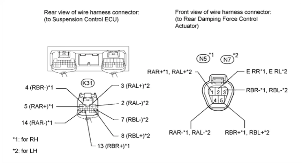

I had a similar code and it turned out to be the electrical connector on the actuator that was damaged. There is a troubleshooting procedure in the FSM that basically checks the wires from the AHC cpu to the actuator. It also checks the internal resistance of the actuator itself.
Pin 2 in the connector on the right is ground. First thing I’d check if everything looks okay is that there is continuity between the wire side of the connector and the truck. If not, then trace that back to wherever it’s tied to the frame.
The FSM expects you to test the wiring between the actuator and the suspension ECU first, then test the cabling and the actuator. But, if it was me I’d test the actuator first, since it’s probably easier. Once it’s unplugged, test resistance between each of the 4 pins and pin 2. The FSM says 12-16 ohm I believe. If that checks okay, then you’ll have to check the wiring between the suspension ECU and the actuator. You want to check for continuity between each wire end and for none to ground on any of the wires. This will guarantee no shorts or breaks.
